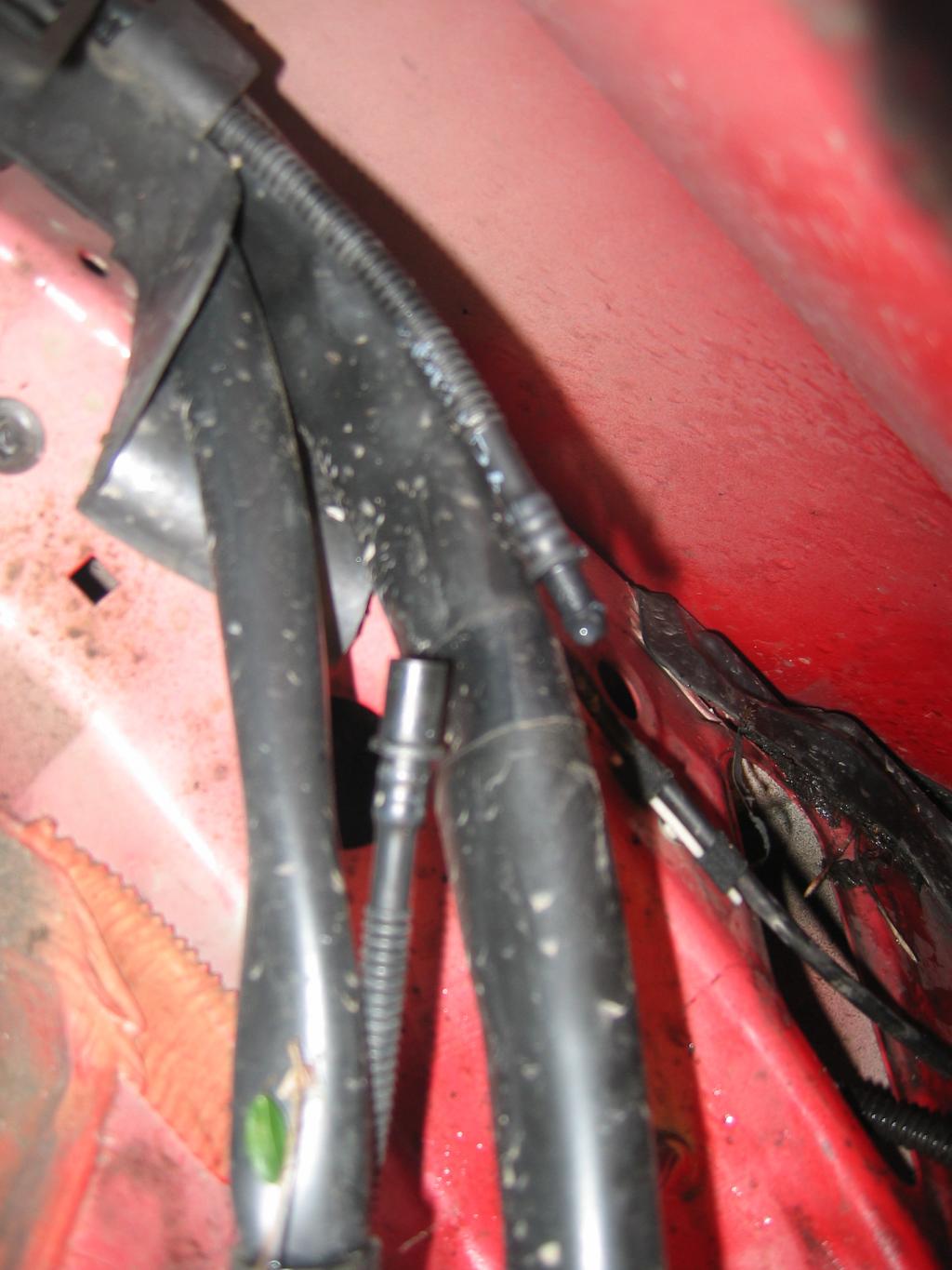

SteveSmytghe Posted January 28, 2011 Report Share Posted January 28, 2011 Cheers. That's my Saturday morning gone then!Peter Not a very good photo (I had my 3 year-old "helping" me at the time), but here is what it looks like once you look inside the wheel arch liner. [ATTACH]42263[/ATTACH] Link to comment Share on other sites More sharing options...
quattroman Posted January 31, 2011 Author Report Share Posted January 31, 2011 Steve, that picture is identical to what greeted me when I pulled back the wheel arch liner! Unfortunately, when I connected it back up water still doesn't get to the rear wiper. I can hear the pump and strangely there's a small trickle of water from the front washer jets so I think there's a blockage in the line which caused that join to pop apart in the first place. I checked for grit in the rear washer nozzles (that's happened before!) but it looks clear. I'm not sure what to do next, get the garage to push some pressured air through the system ??? Pete Link to comment Share on other sites More sharing options...
