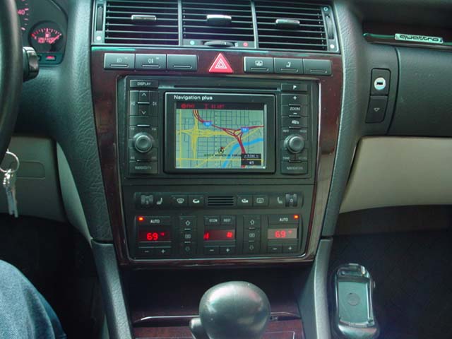

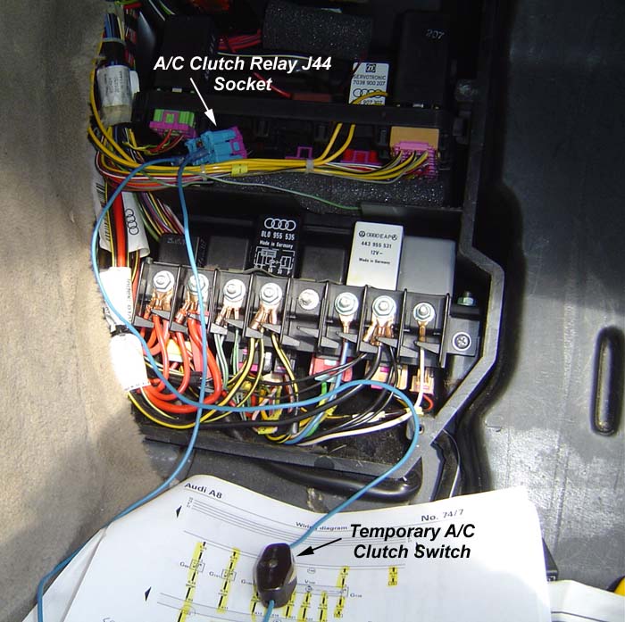

PaulW Posted April 19, 2004 Report Share Posted April 19, 2004 For those of you who don't know, I retrofitting my U.S. bound A8 with Delta radio with a Nav C Plus system. It's awesome. To do it, I installed a dash center plate from an 00 A8 and got an 00 climate control unit from Germany. It worked perfectly until it got hot out....the controller which works on a CAN bus system (only found in the facelift models) would not ground out the J44 AC clutch relay which picks up the A/C compressor clutch..... It got really hot in Chicago this weekend....so I had to do something....the rest is a post from Audiworld: So with the 00 controller in my car....it doesn't cycle the AC clutch relay, therefore, the AC never comes on and it gets really, really hot in the car and you quickly wear out with all the windows open and the sunroof open! So I checked everything yesterday, low pressure switch, high pressure switch (now I know how the electric fan comes on, when the freon in the system gets to a high pressure, it kicks the fan on) and then manually jumped the compressor clutch with 12 VDC. It worked just fine as I thought. The compressor clutch is powered by the compressor clutch relay, J44, which is located in the relay box in the forward part of the passenger footwell. Pulled the relay, pulled the socket and then jumped the clutch contacts with a jumper....worked just fine. I put a switch in there (pretty high tech, huh?) so I could turn it off. However, after thinking about it, I'm 99% sure that when it's warm out, the AC clutch stays engaged all the time. Drove around for a while, no problem, everything works perfect. Even had that "hissing noise" from the orifice letting down the freon after shutting off the car, which was a dead ringer that it was suppose to be engaged all the time. There is a protection diode in the clutch relay J44 as you can see on the right side of the relay schematic. I will end up reinstalling the relay into the socket and installing a mini toggle switch in the ashtray or something to toggle it on/off. On in the summer.....off in the winter. I figure it's because I don't have the CAN bus which provides engine speed, instrument cluster communications and outside ambient temp. This is a heck of a lot easier than trying to figure out what the real problem is. That's all the controller does, is ground that leg. Link to comment Share on other sites More sharing options...
