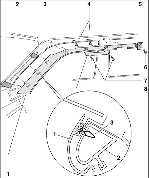

stevebower Posted December 12, 2005 Report Share Posted December 12, 2005 Can anyone advise how to remove the A-pillar trim? I need to run a wire up behind, & the trim seems 'trapped' by the dash-top at the lower end, & I don't want to bang around near the airbag at the top. Cheers Steve Link to comment Share on other sites More sharing options...

stevebower Posted December 13, 2005 Author Report Share Posted December 13, 2005 Had a look, nothing on Audipages, but in Audiworld there is a tech but the A8 info seems to relate to older model without the curtain airbag - he was replacing with an A-pillar turbo dial, the trim for which is only the A-Pillar, where mine extends back to the B-pillar. It might just all clip on, but I don't want to start tugging & breaking clips. Link to comment Share on other sites More sharing options...
Ska Posted December 13, 2005 Report Share Posted December 13, 2005 Trims Removing and installing upper A-pillar trim 1. Upper A-pillar trim o Removing: o ; Remove coat hook -Item 70-31. o ; Remove grab handle -Item 70-30. o ; Detach rubber door seal in area of trim. o ; Detach trim towards centre of vehicle, starting at B-pillar. 2. A-pillar 3. Bracket o Number varies depending on year of manufacture 4. Plug-in nut 5. Coat hook o Removing => Page 70-31 6. Cross-head screw - 5 Nm 7. Cross-head screw - 5 Nm o 2 off 8. Front grab handle o Removing => Page 70-30 Link to comment Share on other sites More sharing options...
