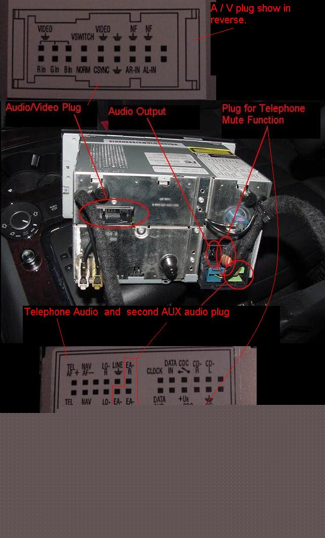

sup44 Posted November 25, 2003 Report Share Posted November 25, 2003 Any one find any third party interfaces available to allow owners to attach auxiliary audio and video input to the Nav system.. I took out the NAV/radio and noted some input slot on the back but haven't been able to find an adapter... Link to comment Share on other sites More sharing options...
shao_khan Posted November 25, 2003 Report Share Posted November 25, 2003 Does the unit not have standard types of A/V jacks on the rear of it? (Be typical for them to do that) Link to comment Share on other sites More sharing options...

sup44 Posted December 1, 2003 Author Report Share Posted December 1, 2003 "Does the unit not have standard types of A/V jacks on the rear of it? (Be typical for them to do that) " No. the back of the NAV unit has a rectangle receptor.. No RCA capabilities with out an adapter.. Link to comment Share on other sites More sharing options...
