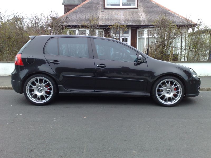

Hi Dave..... Like the pic's. I've just been on to the Khan site, those wheels you wanted come in a 7.5" x 19 which might be more suitable. Don't know if it will run a 235 tyre, but the OEM wheels are 7.5" and run a 225 as you know. I ended up with BBS CH's on mine after you had problems with your others from Tyremen. Here's a pic to set you off......
Hi Martin, looking good!
Are they 19x8" or 19x8.5" wide? I believe the offset is 51? Did you go for 225/35 or 235/35 and do you get any rubbing under hard driving?

Hi Dave.... The wheels i fitted were 19"x8" ET50 with 235/35/19 XL tyres.
As for rubbing nothing up to now, But then I don't go pushing it very often.
As for fitting anything with less than ET50 your going to get problems...
