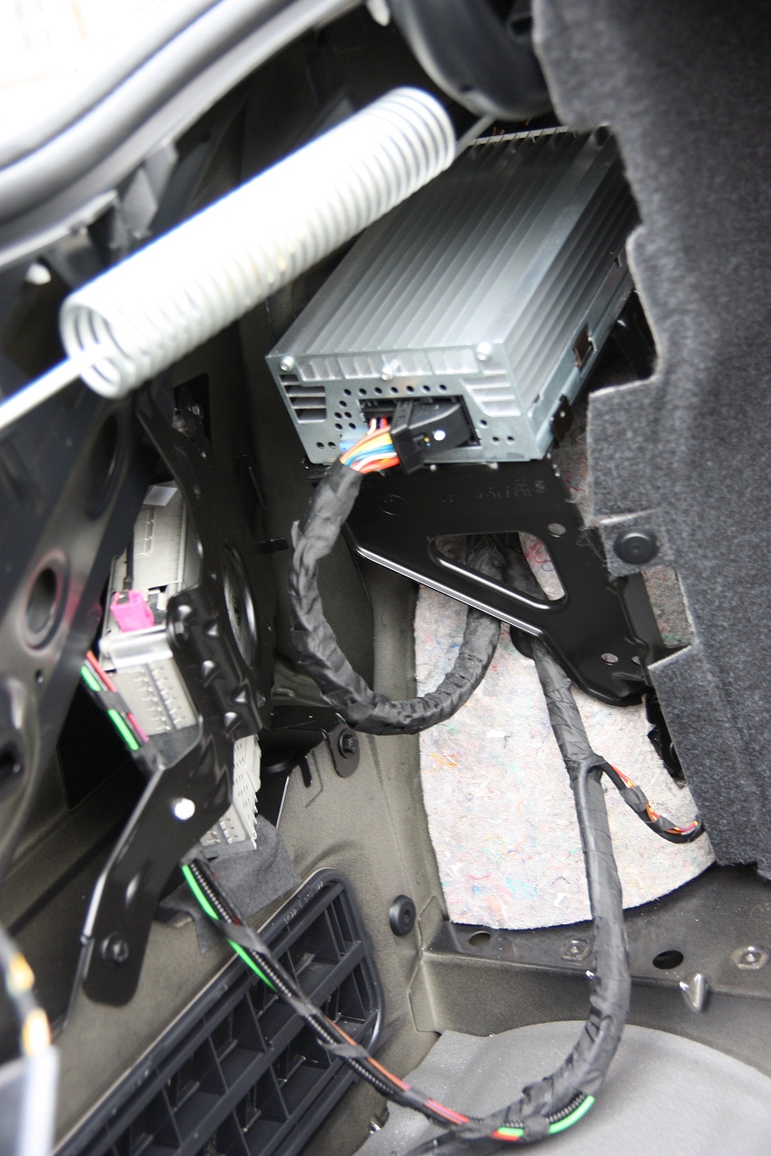

dynamicax Posted December 26, 2011 Report Share Posted December 26, 2011 Thank you all for putting all these information. I spent a couple days going through most of the posts. But I am still a bit confused My car is E60 2010 US model, I believe it has a factory amp ( please see the picture below ). The car also has the following speakers 1) 2 front tweeters ( must not be the L7 ones because I don't have the L7 optin) 2) 2 front mid-range 3) 2 under seat bass 4) 0 speakers on the rear doors 5) 2 speakers on the rear deck ( haven't opened to see if there are tweeters ) I really want to do the upgrade as many of you have done. But looks like I need a different option, probably need something like jl audio cleensweep. If I go this route, do I completely ignore the factory amp? How about the satelite radio that's in the picture? Can you share some ideas with me ? Thanks [ATTACH=CONFIG]45298[/ATTACH] Link to comment Share on other sites More sharing options...
dynamicax Posted December 26, 2011 Report Share Posted December 26, 2011 adding picture Link to comment Share on other sites More sharing options...
gizze Posted December 26, 2011 Report Share Posted December 26, 2011 What do you want to gain? The Logic7 system is Harman Kardon, and it is very good. If you want more bass you can drop in the Earthquake SWS8 subs, but make sure they are the 2 ohm versions. If you want more after than then you could consider adding another amp to drive those subs, you would take the signal after the L7 amp and put the new amp inbetween giving you more power to the new SWS8 subs. Link to comment Share on other sites More sharing options...
dynamicax Posted December 26, 2011 Report Share Posted December 26, 2011 thanks gizze, actually, I don't have L7 at all, otherwise, I would be a lot happier. I don't think the speakers ( tweeters, mid-ranges,bass) are the same as logic 7 amp either. I found it online the E90's HIFI system has a factory amp ( 2x 40W bass , 4 x 25W ) , but their L7 systems' amp spec is ( 2x70W , 6 x 40W ). Thinking to change the tweeters and the mid-range in the front to Morel, drop in the Earthquake and keep the rear speakers. For amp, can I use a 4 channels. 2 channels go to the front speakers, and 2 channels drive the 2 earthquake, leaving the original amp for the rear speakers. would that work? Link to comment Share on other sites More sharing options...
gizze Posted December 26, 2011 Report Share Posted December 26, 2011 In that case you can buy a harness from a guy called Technic on the BIMMERPOST | BMW Forum, BMW News and BMW Blog forums, this will give you the connectors you need to go into a new amp and back to the speakers all at the place where your amp is now, so it just hooks into the factory connector. You can then add a nice 4 channel amp, your speakers and some earthquakes. I am about to go Morel in our X1 along with Earthquakes and I have a nice JL Audio XD400/4 amp, only problem is I have decided to keep my oem head unit, it is coded for Alpine so it is flat EQ wise but it is 8v out and the JL wants 4v really. Not sure if I want to use convertors. What amp are you using? Not interested in it are you for a good price? Your head unit is coded for the hifi system which is 5v balanced line level, so will plug straight into it. It is this amp... XD - JL Audio » JL Audio XD 400/4 Amplifier Review Link to comment Share on other sites More sharing options...
