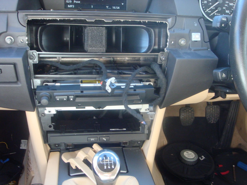

DJKR Posted August 18, 2009 Report Share Posted August 18, 2009 Hi Guys, I have just ordered the THA555 AMP and the Earthquake speakers. Will order the tweeters today. I was just checking how I was going to run the cables in the car, I have come across a couple of problems. The plastic trim on the rear passenger door does not seem like it is going to come completley off, feels like it may snap. Any idea how to get it off? Also do I need to remove the back seats to be able to run the cable into the trunk. I have the standard seats. If so how do I go about doing this? I have got some guides from the E60 info sites. If these are guides I should use please let me know. When I run the speaker cable for the subs. Can I just run all the cable down the passenger side and then route the cable for the driver side sub from under the passenger side sub enclosure to the driver side sub enclosure. Also I will run the 5.5m AMP cable down the passenger side. Should this be run up behind the glove box and to the head unit? You can see in the pic attached the contents of my glove box. The Dension 500GW (silver box) is sitting there with the BTA1500 (blue) on top. Thanks for any advice in advance. Link to comment Share on other sites More sharing options...

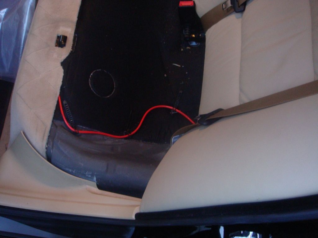

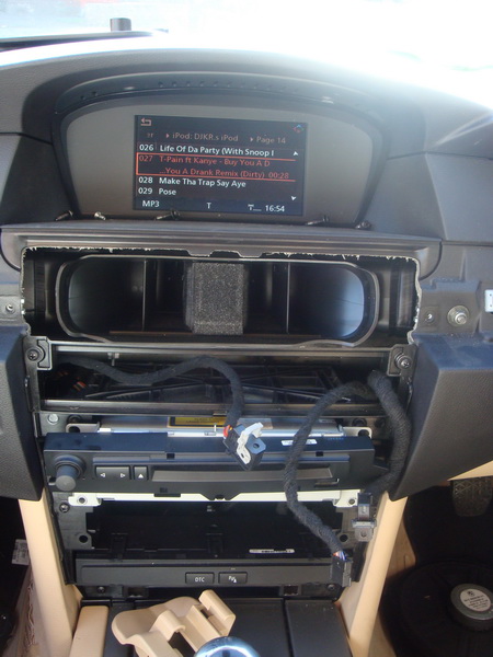

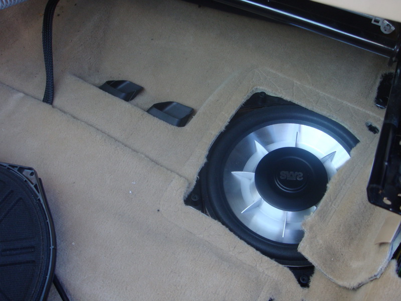

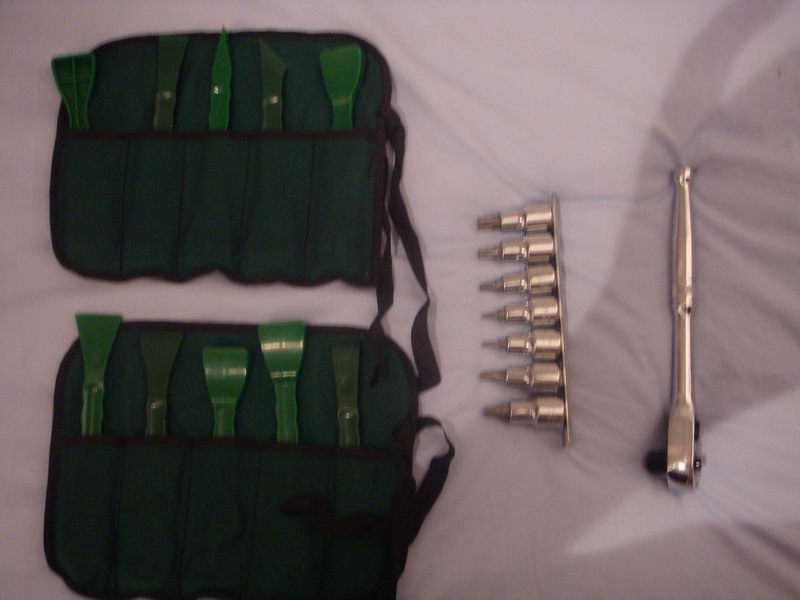

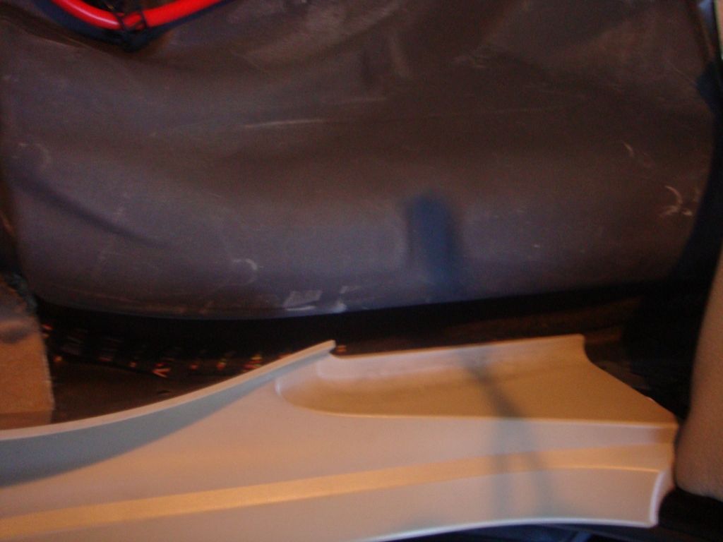

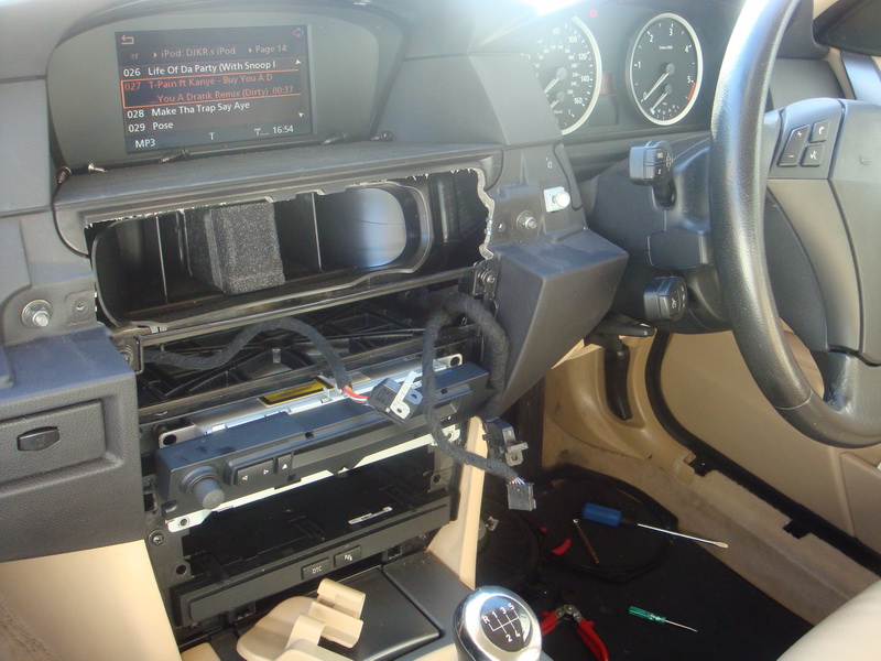

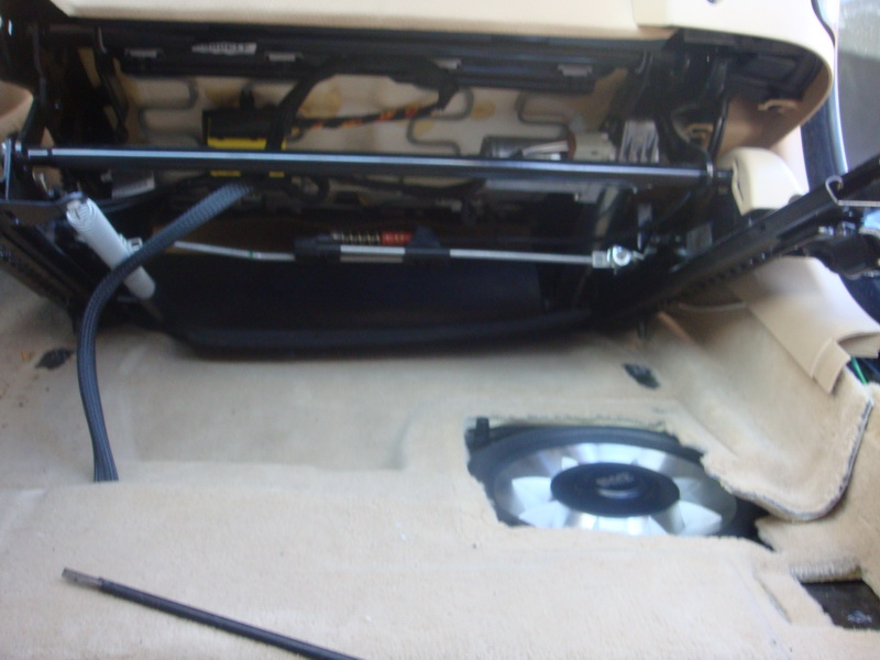

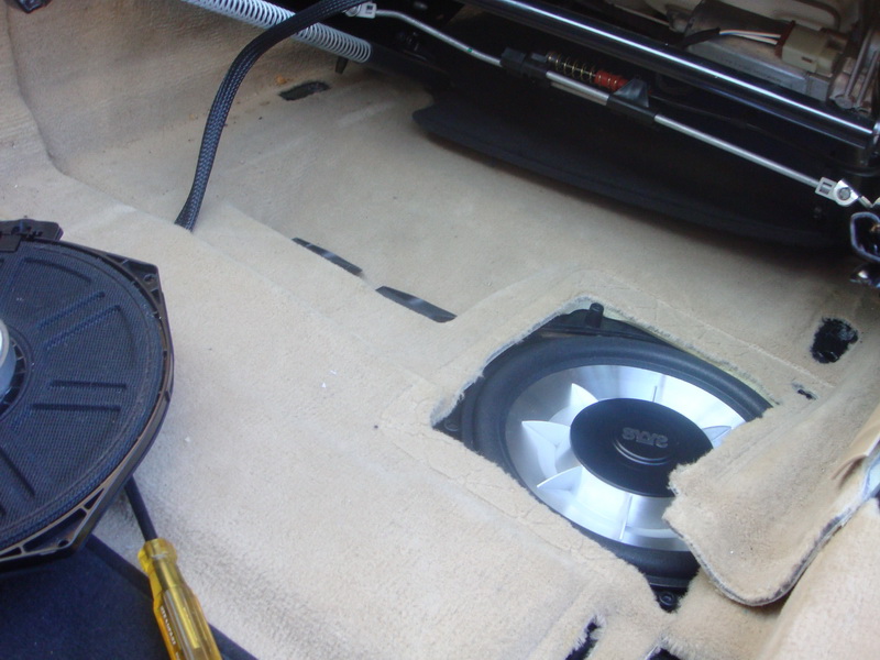

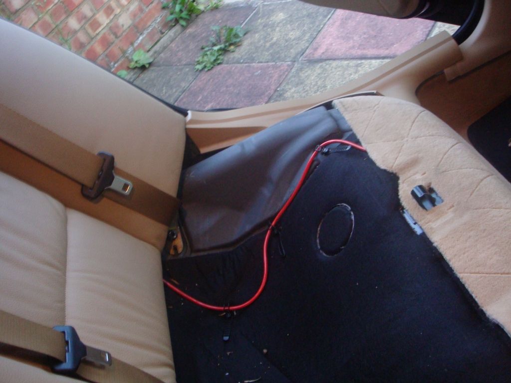

DJKR Posted August 31, 2009 Report Share Posted August 31, 2009 Evening All, I have just completed the install of the Blaupunkt THA-555 AMP and the Earthquake SWS-8 Subs, man does it make such a difference, the bass now sounds amazing! I did not have enough time to install the tweeters, but by just adding the amp and the Subs, I can already hear the differnce. It has taken me nearly 8 hours today to do this work, I still did not manage to put the back seats in as it got dark :-) There were 2 tricky parts in the install. 1. Removing the back seat, had to remove the centre seat belt and then disengage the secure locks from the boot, best thing is to lie on your back in the boot and use a screwdriver and move the spring connection to the side. Also by doing this the trim on the rear door can be removed easily. 2. also removing the climate control took some time. First i removed the air vent panel, remebering to unclip the hazard,keylock button, then some screws are visisble that you must undo, you can then pull it out a little and you need to use a long screwdriver to unclip to hinges. then the headunit comes out easy. I ran the Blaupunkt cable under the glovebox and then back into behind the head unit, it is quite tight in there so had to move all the connectors to some space on the left hand side of the head unit. The speaker cable was run down the trim of the car and then below the rear seat and through the hole back into the boot where the big red cable runs into. I got a few questions 1. Does everyone run the sub remote control cable? If so which side of the car do they run it down and where do they install the control? 2. At the moment the power feeding my amp is from the head unit, is there any danger in doing this? (so Amattila, you can run the pouwer from the head unit) 3. When connecting the Blaupunkt adaptor to the back of the headunit, on the power cable connectors there is a yellow (constant) and red (ignition) cable and then on the loom which goes back to the amp there is just a yellow connector. Do these need to be connected? 4. I bought 2 x 2 ohm SWS-8 subs. I ran a separate pair of cables for each sub and connected them separatley on the amp. Please confirm if this is fine. For each sub I ran the cables down each side of the car, i hope this will not be a problem on the driver side of the car where the 12 volt cable is. 5. I found a problem with the sound cutting out, when the bass was pretty low, if I reduced the volume it was fine. Any ideas what this could be? 6. on the idrive i set the treble to 3 bars and the bass to 3 bars? Is there a better setting for this? 7. I set the amp settings as follows, is this optimal? 8. I tried to connect the AMP directley to the battery, but I saw the protect light blink red twice. All I did was run a cable to the battery in the boot for the +12V and then connected the earth to the chassis of the car. Anything i done wrong? 9. Also down the passenger side door there is some trim below the glove box, I am finding it difficult to put this back, any tips? Thanks for any help in adance. Link to comment Share on other sites More sharing options...

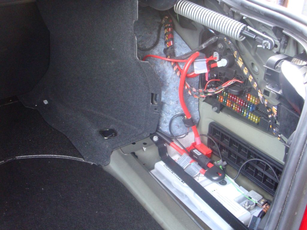

gizze Posted August 31, 2009 Report Share Posted August 31, 2009 Hate to tell you this, but running 2 x 2ohm subs will give the amp a 1 ohm load and that amp can't handle it. You need the 4ohm subs so the amp sees a 2 ohm load. The amp will go into protect mode with those subs and turn off. You can use them, but you need to wire them differently, see this diagram..... I always run the amp off the battery, positive to the positive, there is a block above the battery where you can add it, you don't have to go to the actual battery, in fact best not to, and the neg wire to the nagative. When you hook to the battery make sure the power cables from the head unit are not connected. I ran the sub vol down the right hand side and into the cubby hole under the steering wheel so it was hidden. Link to comment Share on other sites More sharing options...

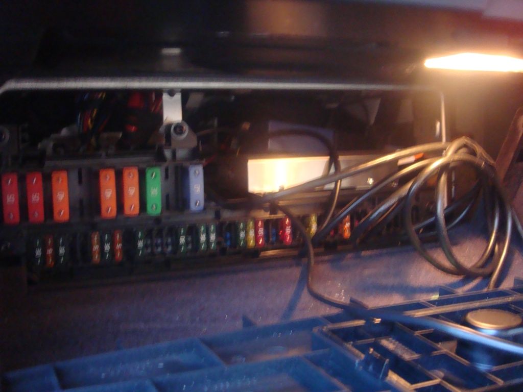

DJKR Posted September 1, 2009 Report Share Posted September 1, 2009 Thanks Gizze, I done that this morning, was not too much hassle as all the wiring that needed to be changed could be done directly from in the boot. I will try to run the sub remote today. Will let you know how I get on. Are there any drawbacks from running the power from the head unit? Link to comment Share on other sites More sharing options...
gizze Posted September 1, 2009 Report Share Posted September 1, 2009 Only that the amp 'may' pull too much current and fuse the radio fuse. Link to comment Share on other sites More sharing options...

DJKR Posted September 1, 2009 Report Share Posted September 1, 2009 I bought the 2 ohm ones and as long as they wired correctly as Gizze has suggested they should be fine. I am no sure if there are any advantages in having the 4 ohm ones? I just tried this other day on a 2005 520d, I just have a single slot CD Player and the climate controls, you can see the pics in my previous post. For an initial parts list I got Blaupunkt THA-555 AMP 2 x Earthquake SWS-8 Subs (2 ohm) 2 x L7 Tweeters (Just remembered something, I have the grill, do i still need to buy any additional housing) Just make sure you have a ratchet/screwdriver kit for all the Torx screws. I also bought a plastic trim removal tool set from fleabay, can be useful and also used my hands alot to pull the trim off directly. In my car I only had the underseat , front door and rear shelf speakers. Link to comment Share on other sites More sharing options...
