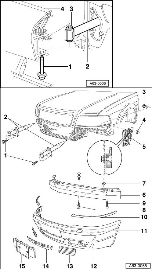

Ska Posted January 18, 2009 Report Share Posted January 18, 2009 (edited) Some differences between pref facelift and facelift. see here: http://www.tyresmoke.net/forum/audi-a8-s8/107470-how-do-you-take-front-bumper-off.html and the below pic: I would imagine its left from the drivers position Edited January 18, 2009 by Ska Link to comment Share on other sites More sharing options...
waynester2 Posted January 19, 2009 Author Report Share Posted January 19, 2009 Hey thanks for that, I started taking it apart following your post, but need a 10mm hex tool got one today, so will attempt again this weekend, I would imagine its left from the drivers position I thought so to, but left (n/s) looks good condition, right one (o/s - Drivers side) looks corroded hence why I was a bit confused. I thought all of the VAGCOM messages might be standard regarding perspective, hope so anyway. I've got a sensor coming from a8parts so I'll soon find out. W Link to comment Share on other sites More sharing options...
IT_S8 Posted January 22, 2009 Report Share Posted January 22, 2009 Hey thanks for that, I started taking it apart following your post, but need a 10mm hex tool got one today, so will attempt again this weekend, I thought so to, but left (n/s) looks good condition, right one (o/s - Drivers side) looks corroded hence why I was a bit confused. I thought all of the VAGCOM messages might be standard regarding perspective, hope so anyway. I've got a sensor coming from a8parts so I'll soon find out. W Audi always go from the drivers seats looking forward to avoid confusion. It will be the sensor on the very far left, otherwise it would say left center. It is reporting an intermittent open or short, so it sounds more like wiring inside the sensor, than a false reading from a badly corroded one. It sounds quite viable that the 'nice looking' one is faulty given your errors.... Link to comment Share on other sites More sharing options...
