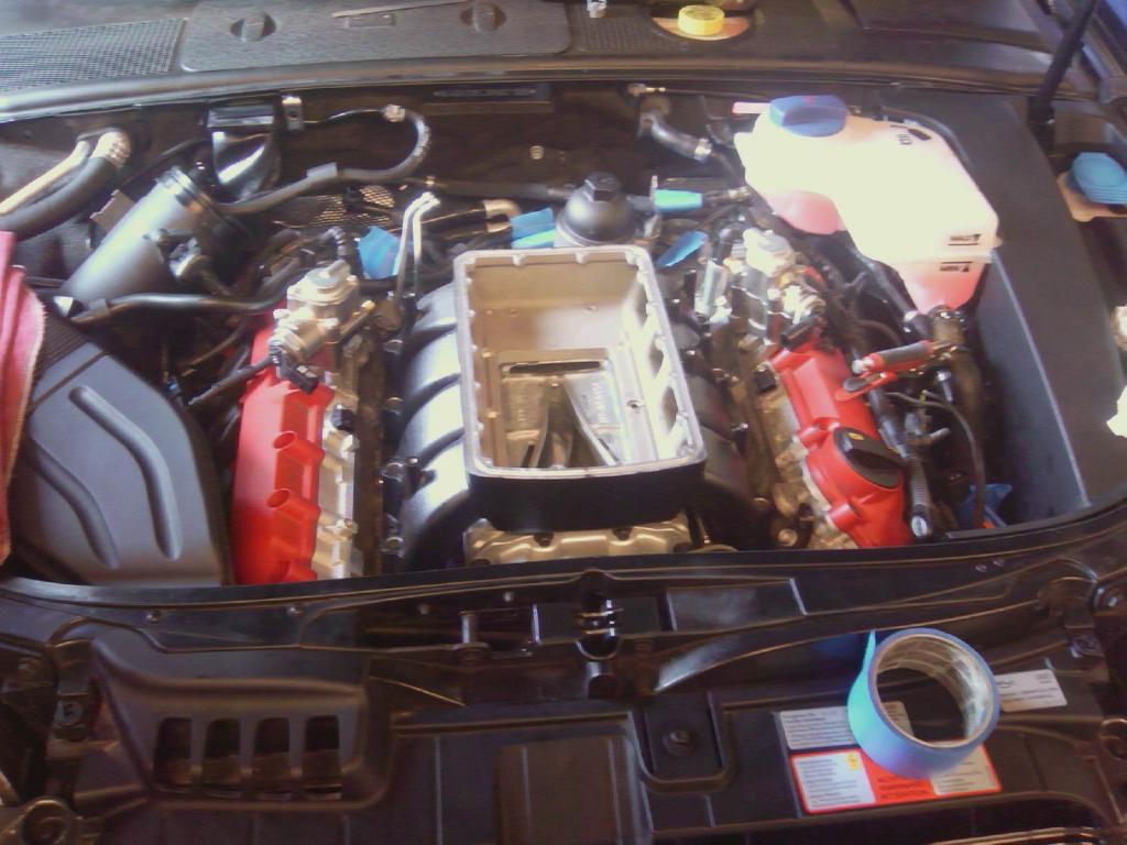

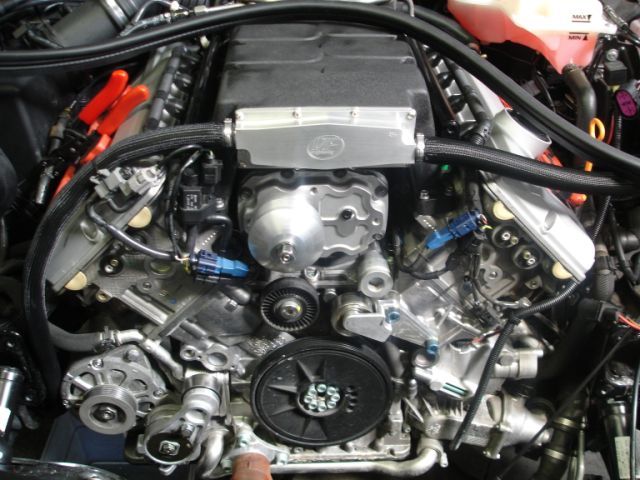

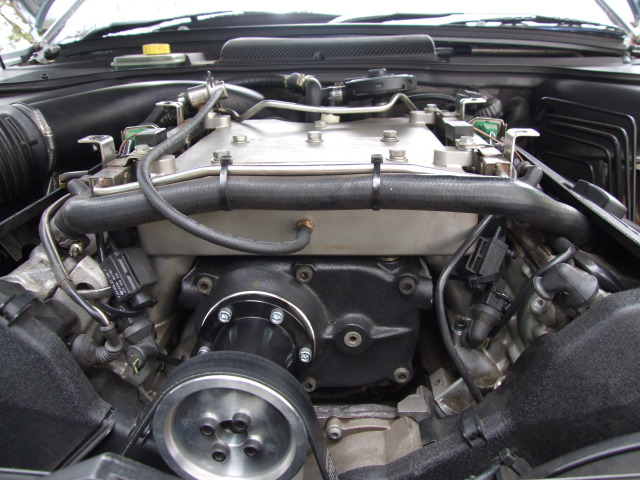

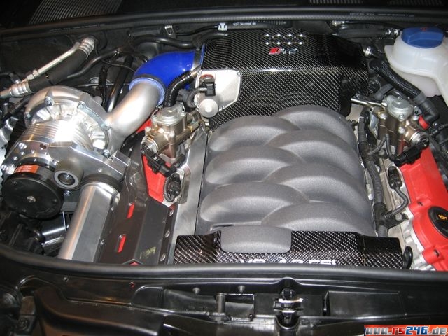

r8dream Posted December 2, 2009 Report Share Posted December 2, 2009 (edited) previously posted blower pics here; V8 head refurbishment - Page 3 - A8 Parts Forum because i love to look at pics when sitting at the computer, all audi 4.2 blowers on sale now, in order, audi new s4 3.0, vf-engineering, pes, motodyne, autospeed performance, pes, novidem, mtm, new abt, abt, audi new s4 3.0. Edited December 2, 2009 by r8dream Link to comment Share on other sites More sharing options...

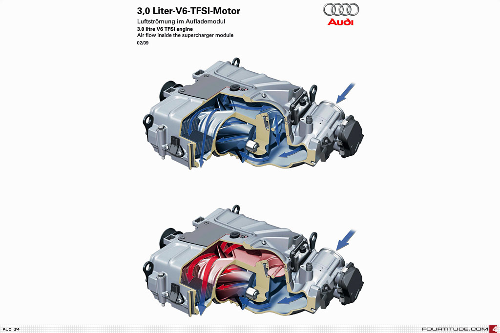

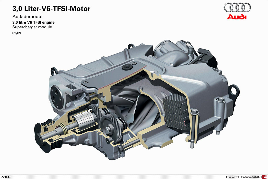

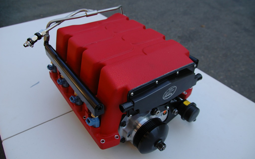

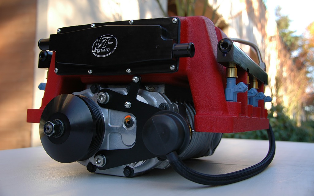

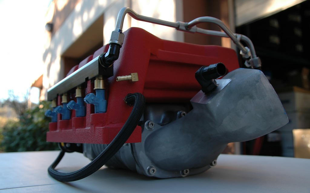

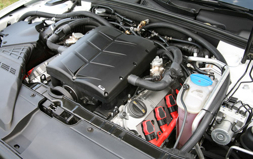

r8dream Posted December 5, 2009 Report Share Posted December 5, 2009 (edited) just got these hi res pics of the best (imho) and most affordable supercharger kit for my 40v d2 s8, the vf-engineering one, costs £5700 also two more pics comparing it to the new audi s4 3.0tfsi unit also made by eaton. john Edited December 5, 2009 by r8dream Link to comment Share on other sites More sharing options...

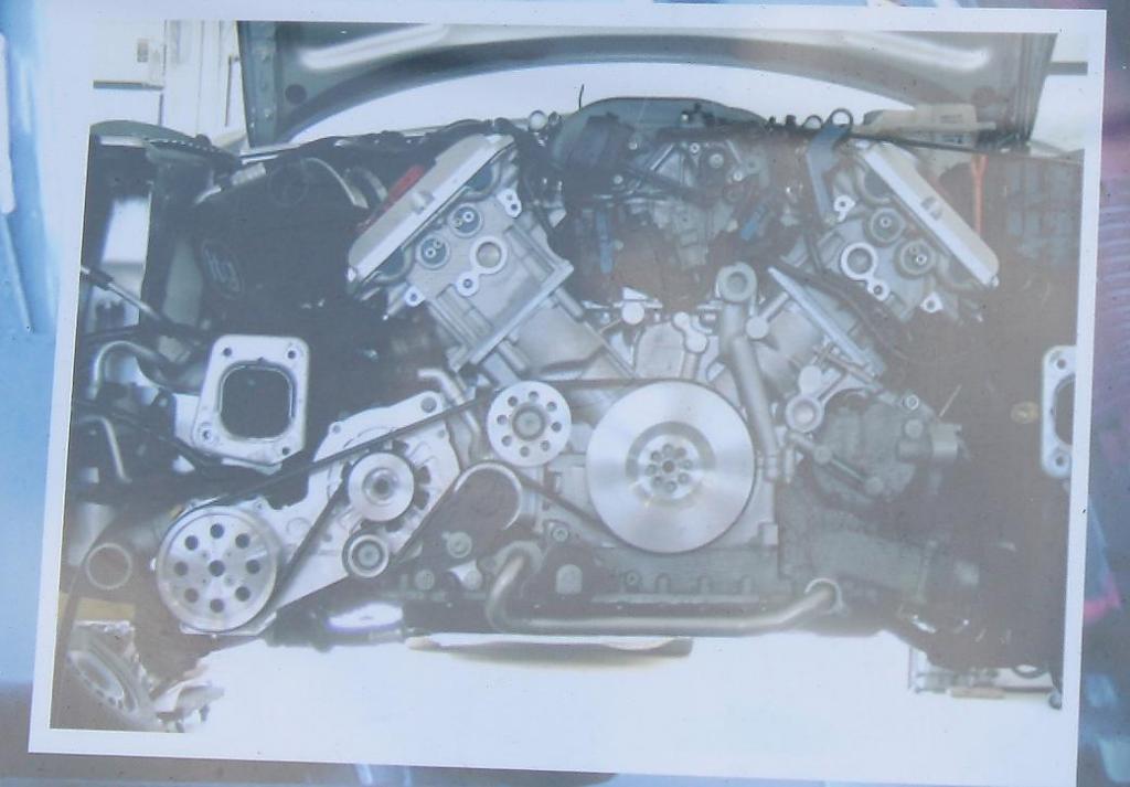

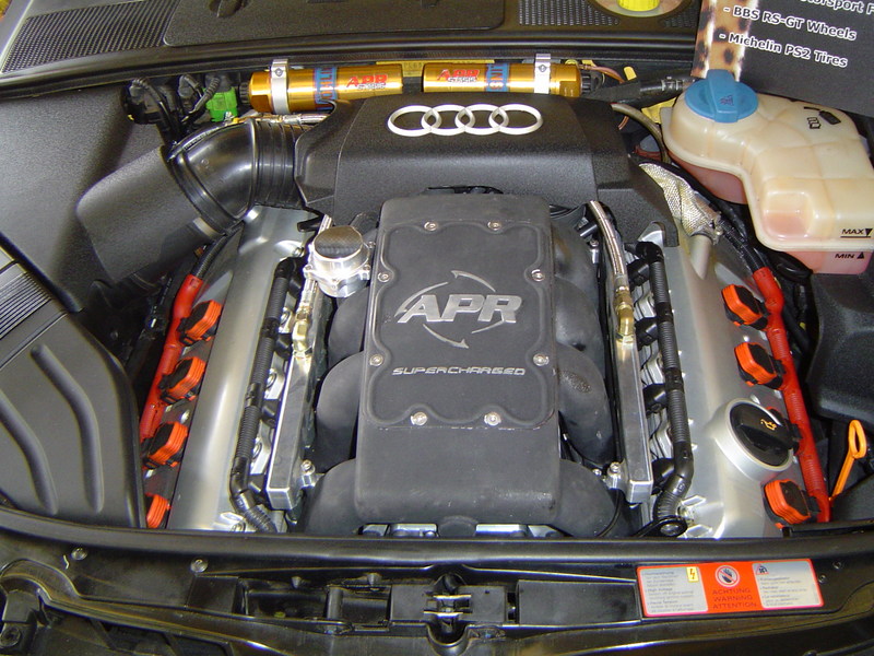

r8dream Posted December 26, 2009 Report Share Posted December 26, 2009 (edited) here's some more audi 4.2 supercharger pics to get ideas from, the one-off apr that didn't go into production because it would have been to costly for the market to bear(and still make a profit) and was breaking rods at 8psi of boost in an 079 block s4 v8, according to the man from apr. a rare centrifugal procharger on an early 4.2, i'm trying to copy this header design for the my d2 as it is very tight around the engine in the d2. and an a8 d2 motodyne with stainless headers from the land down under. looks like he is here online now(above post) and hope he will give us some more pics, and first hand info of a d2 v8 install, especially header design. john Edited December 26, 2009 by r8dream Link to comment Share on other sites More sharing options...
