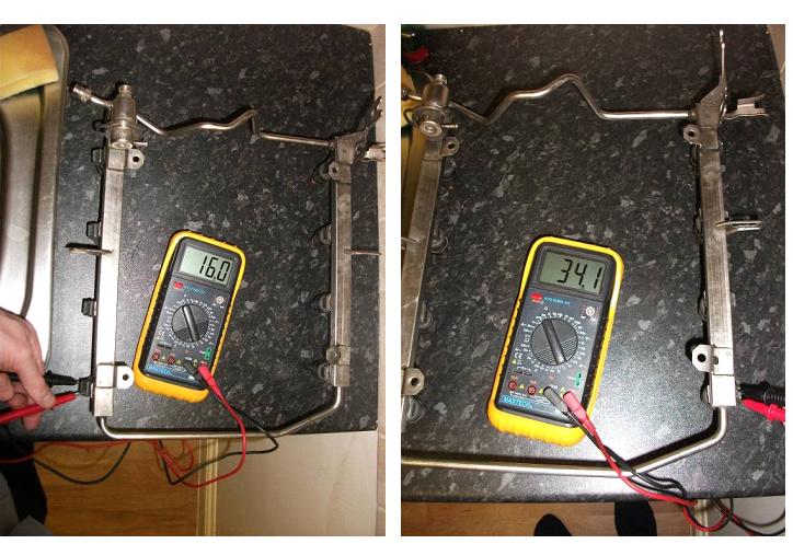

treetotreef Posted January 21, 2010 Author Report Share Posted January 21, 2010 From memory they're hard wired. hopefully they won't fall over in the near future, but I'm glad that i found my 3 dodgy injectors and my problem is finally solved now. its been annoying me for too long! Link to comment Share on other sites More sharing options...
treetotreef Posted January 22, 2010 Author Report Share Posted January 22, 2010 Better internet connection at work so I'll upload some pics and more info Here's a good website for bosch injector data... http://www.usrallyteam.com/content/products/injector/Bosch_Injector_data.xls just press Ctrl + F and type in your injector number Also attached are full info for the 32v and the 40v injector in the zip file Audi S8 Bosch_Injector_data.zip Link to comment Share on other sites More sharing options...
