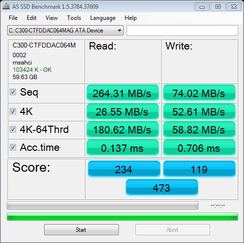

Sponge Posted June 29, 2010 Author Report Share Posted June 29, 2010 (edited) I think it's sorted. I think the switch from SATA - RAID to SATA - AHCI had screwed up the pre-existing RAID 0 (non-os) that was present. (I'd only disconnected the old OS HDD for installation of the SSD.) One disk had 'dropped out', so I decided to delete it completely in the BIOS and also disconnect all HDDs. I kept AHCI enabled. I had another go at installing W7 and so far, no BSOD. So I'm hoping that was the problem and it's now sorted. I've been installing a few bits and bobs and have just benchmarked the drive. PS Motherboard is SATA II Edited June 29, 2010 by Sponge Link to comment Share on other sites More sharing options...

Chav Posted June 30, 2010 Report Share Posted June 30, 2010 I think it's sorted. I think the switch from SATA - RAID to SATA - AHCI had screwed up the pre-existing RAID 0 (non-os) that was present. (I'd only disconnected the old OS HDD for installation of the SSD.) One disk had 'dropped out', so I decided to delete it completely in the BIOS and also disconnect all HDDs. I kept AHCI enabled. I had another go at installing W7 and so far, no BSOD. So I'm hoping that was the problem and it's now sorted.I've been installing a few bits and bobs and have just benchmarked the drive. PS Motherboard is SATA II You should have got a 128gb one with 220/200...that write speed is terrible for a "high-end ssd" To maximise performance ensure you disable last-file-access update in windows 7 as that doubles the effective number of writes required. check write caching enabled too. This may sound crazy but as your disk writes so slow I think you'll get an increase in overall performance if you compress the entire drive via windows built in disk compression. this will effectively increase write speed by 40-60% at the expense of some cpu which you can afford as compression/decompression no problem for a core2quad whilst windows doing other things. Link to comment Share on other sites More sharing options...

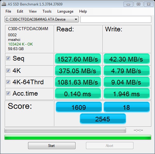

Sponge Posted June 30, 2010 Author Report Share Posted June 30, 2010 (edited) Benchmark after the changes, included compression. The reg key was already enable (1). Something doesn't look right. :confused: Edited June 30, 2010 by Sponge Link to comment Share on other sites More sharing options...
Chav Posted June 30, 2010 Report Share Posted June 30, 2010 with a compressed drive many benchmark apps wont work right - as above the question is does it appear faster in real world?? i think anything over a core2duo at approx 2.5ghz is fast enough to counteract the extra cpu overhead of compression - typically you have an idle core during loads/saves anyway - so may as well put it to use! Link to comment Share on other sites More sharing options...
