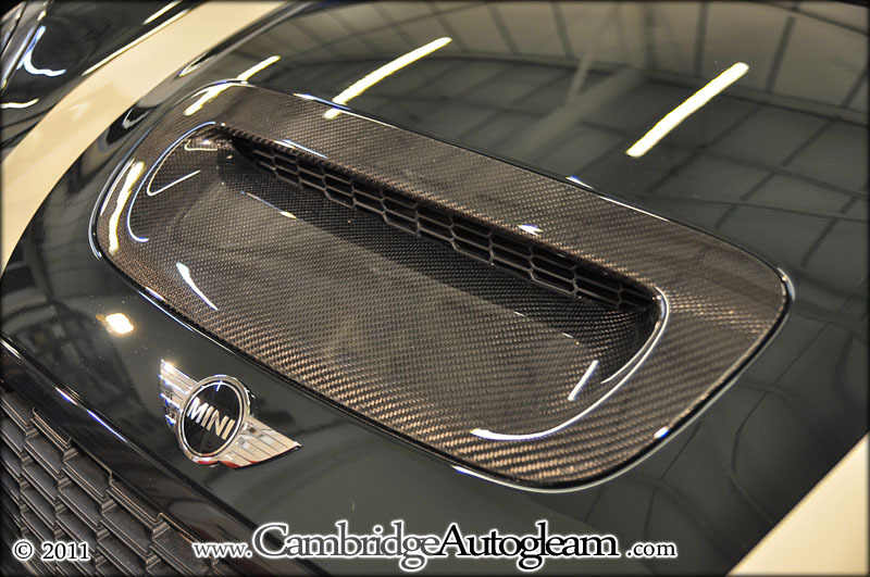

Good afternoon...
Firstly dont forget to add us on facebook :)
Second of all a bit of blurb on the WC50
MINI's 50th birthday celebrations continue with another special edition model. This time it's the MINI WC50 which marks the 50th Anniversary of the Cooper Car Company winning the Formula One constructors championship. The two guys behind the wheels were legends Jack Brabham and Stirling Moss who took first and third spot in the overall championship.
The WC50 will be very limited in numbers; only 250 units are to be produced from the Oxford plant, with 100 reserved for UK customers (This has now been raised to 500 cars to include the US market. Officially MINI does not plan to export the car anywhere else outside of Europe so markets like the US and Australia are probably not going to get it.
Mechanically the car is identical to the John Cooper Works model. But there are changes and they are significant. The main ones are the aero kit and some interior appointments. The exterior has bi-xenon lights with black interior reflectors, fog lamps, bonnet stripes, a carbon fiber bonnet scoop, carbon fiber mirror caps and a rear diffuser. It is fitted with 17-inch Cross-Spoke Challenge alloy wheels in a Jet Black colour.
The interior comes with a 6-CD Harman Kardon sound system with USB, Bluetooth phone connectivity, heated front seats, an interior lights package, sat nav, rear park distance control, a leather handbrake gaiter and a multi-function steering wheel.
To cost £30k +
The fun part is that these are 'hand painted and finished' in Connaught Green.
For most people the sound of a hand painted car is a good 'higher class' thing... but as most detailers will know it just means more polishing for us :)
The Connaught Green is non metallic and actually pretty soft and on this car.. very thin! 80-90um so I didn't chase every single deep mark which was frustrating.
On arrival at 8am
Usual wash process:
Acid free wheels
Megs Hyper wash foam
Megs Shampoo wash
Clayed with Souns mild blue. Quite a lot of contamination for such a new car
Polishing was done with Menz IP3.02 in some areas, Menz 203S in others and then refined with Menz 106FA on a DA polisher.
Before
After
Before
After
The vinyl stripe was polished as well which brought out lots of dirt as you can see (sort of) in this 50/50 shot.
Top half polished and cleaner / bottom half un touched and actually quite dirty.
Polishing took ages for such a small car. I was applying Blackfire paint sealant to each panel as I went round and buffing off after 5-10 minutes. When the whole car was complete it was then given a coat of Vintage wax.
This was left to cure for a while while the wheels were sealed and tyres were dressed, plastics dressed and glass cleaned.
And the finished shots...
Thanks for looking.

Finally the Mini Cooper D needed a bit of paint correction before we could apply the Gtechniq coating.
Nasty fallout on the bonnet needed some claying / heavy cut polishing to remove.
Before washing..
Paint correction was a mixture of 3m fast cut plus and menzerna 3.02 and then refined with Gtechniq P1.
Before
After
50/50 shot
And some finished shots after the Gtechniq treatment.
