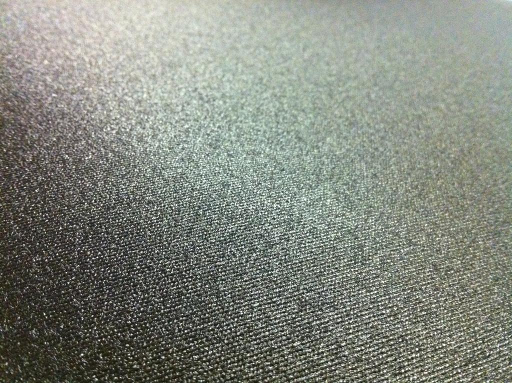

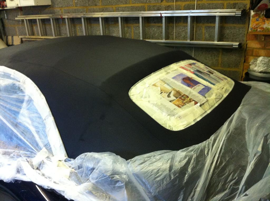

patently Posted April 3, 2011 Author Report Share Posted April 3, 2011 The roof dried out nicely, so I went out with the lint roller and cleaned up. It had a good going over with that about 2 weeks ago prior to waxing the car, and has been in the garage since then. Amazing how much junk gets there the moment it goes outside... Then the masking tape came out,for the plastic edge trims, the seals, and the back window. It started to look like rain, so halfway through the plastic got rolled back so that the car could roll forward back into the garage. The wet stages are done, we don't need to be outside any more. Back inside, all taped up So with everything taped up, on went the proofing gunk. It's thinner than I expected, but that means it goes on more easily than I thought. As Vertar suggest, I did the seams first then started at the front middle and worked backwards and outwards. It's quite easy to see where you've been, as the liquid soaks in and darkens the fabric nicely. Hope it dries nicely I'm going to leave the masking there for an hour or so while I see how it dries, in case any bits need a second coat. I'm especially concerned about the front edge, as that is the hardest part to avoid washing when cleaning the car. You need to do the windscreen and the frame, which runs smoothly onto the roof without any ridges to keep the wash mitt back. Link to comment Share on other sites More sharing options...

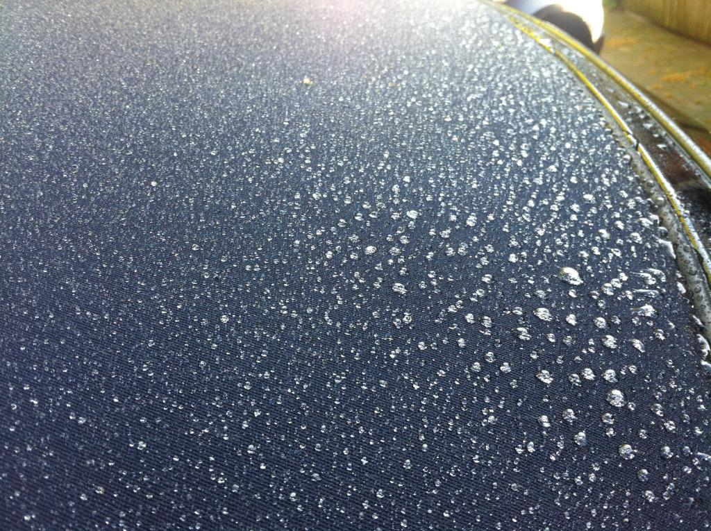

patently Posted May 2, 2011 Author Report Share Posted May 2, 2011 It worked! Just noticed this beading on the fabric roof - I have a waterproof roof again Link to comment Share on other sites More sharing options...
