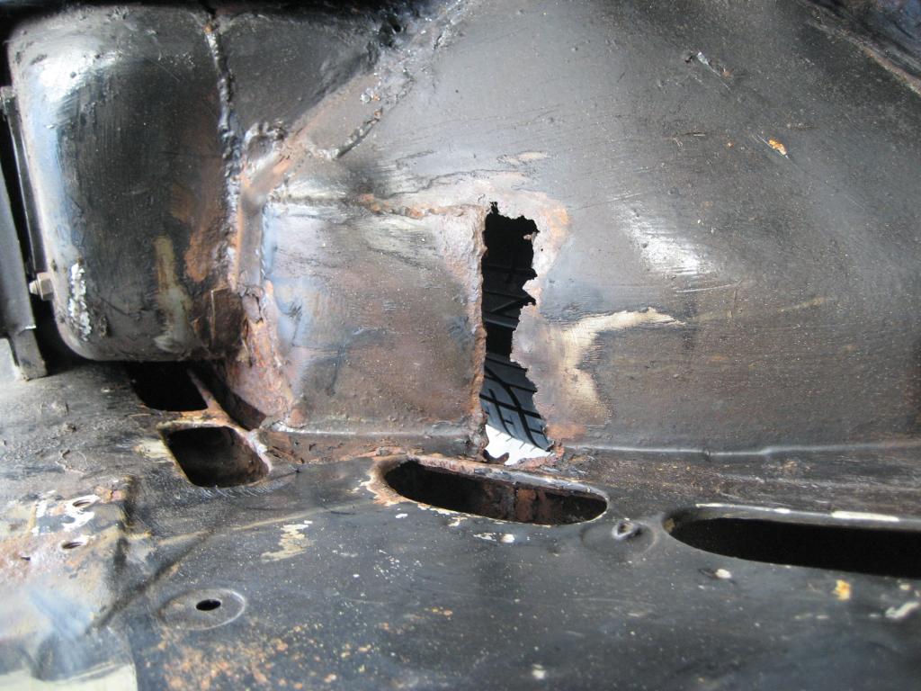

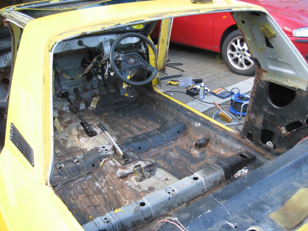

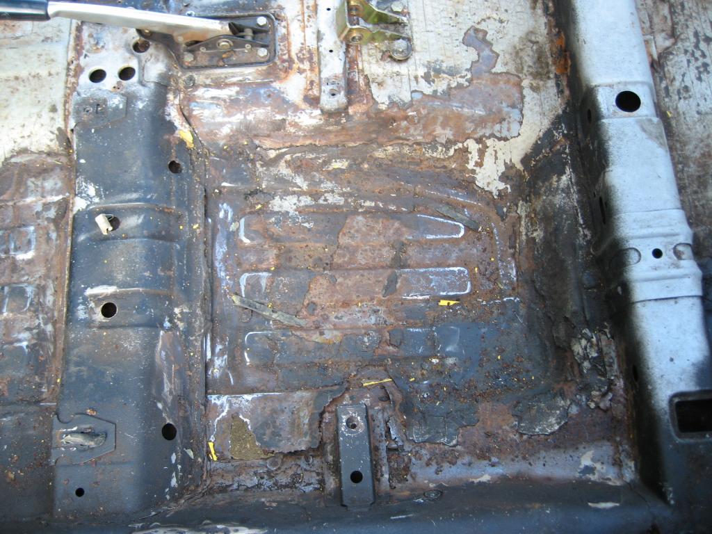

lesK Posted June 26, 2011 Report Share Posted June 26, 2011 Well Here we go, Started restoring the Lancia Beta a few weeks ago. Got the eldest lad helping and he seems to be very keen. So first off stripped all the interior out, to see how bad it really is. Not as bad as it could be, but still going to need welding. This weekend we removed most of the panels, these are going to be replaced with better ones I have. The main problem areas seem to be rear wheelarches, passenger footwell, both seat mounts and the door sills. The under car sills will need replacing and I may have to replace the scuttle, but until we get under the paint I'm not sure. Here are a few photos and a before we started. Link to comment Share on other sites More sharing options...

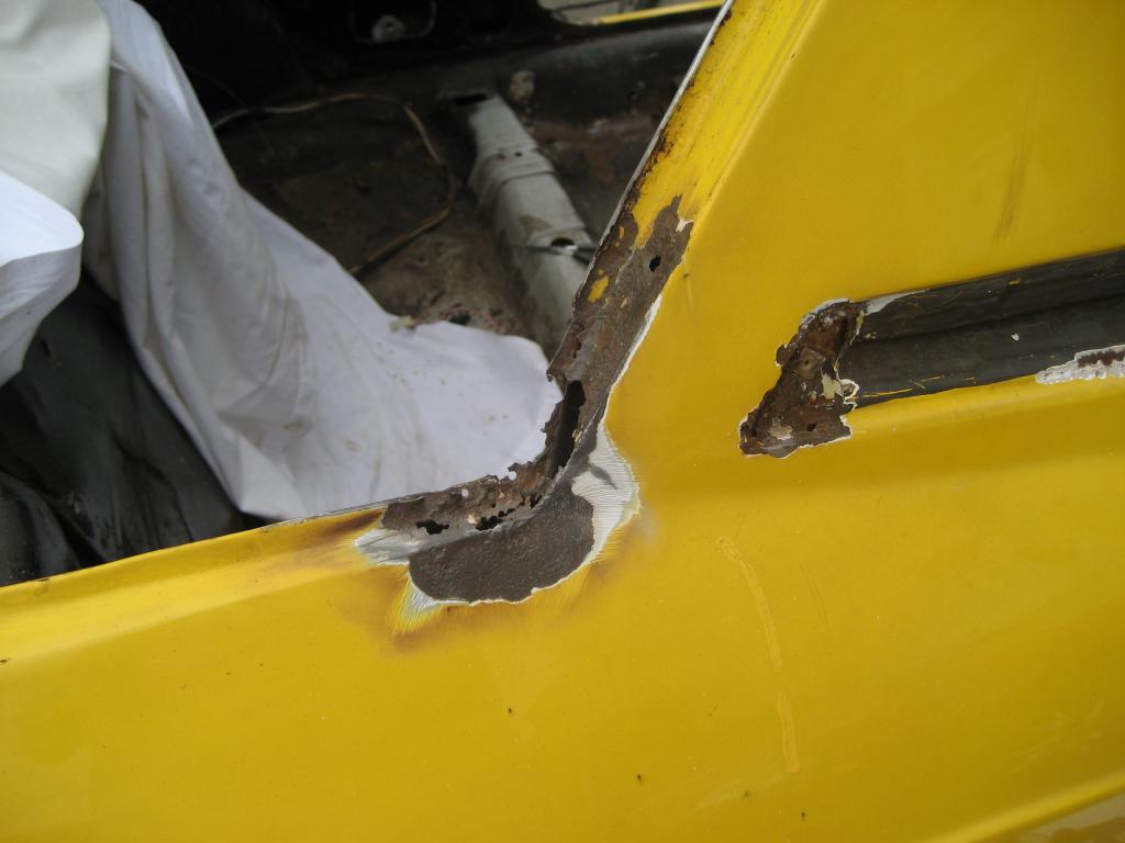

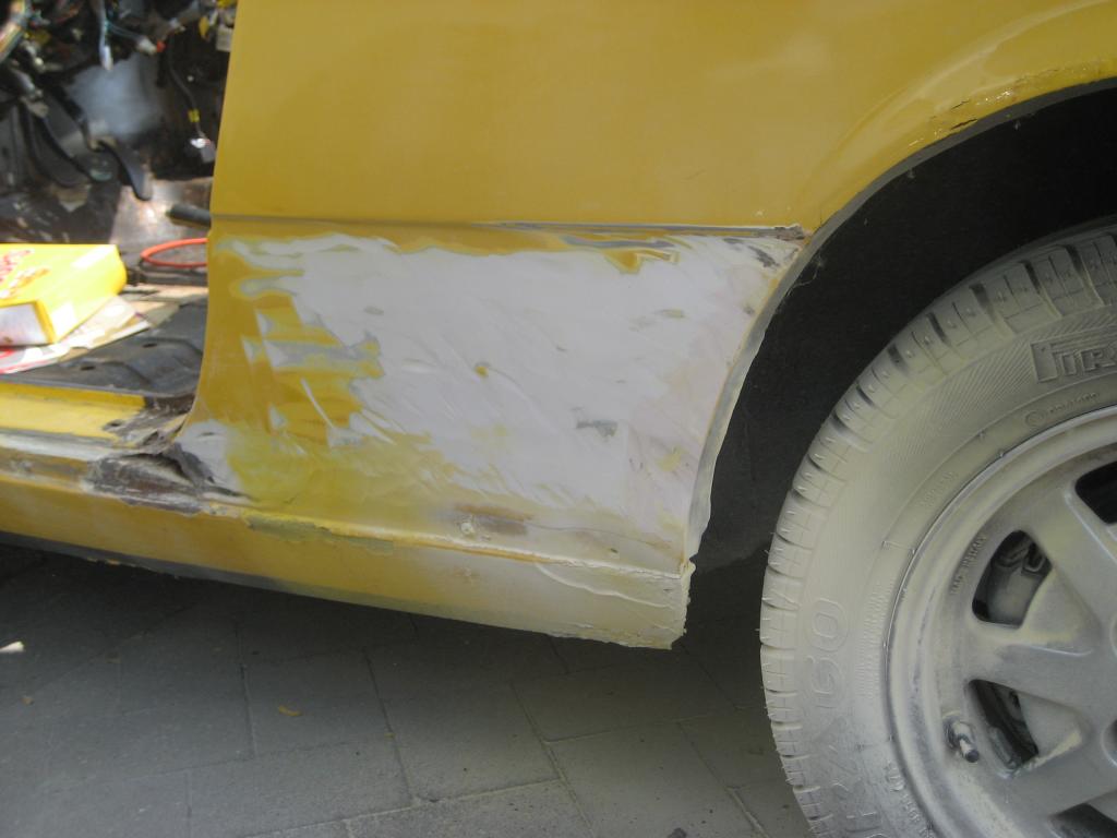

lesK Posted July 3, 2011 Author Report Share Posted July 3, 2011 Another day of grinding today!! A day of surprises too, have found a "little" bit of filler around the rear wheel arches, and the passenger scuttle. We are now going to be cutting the bottom of the rear wing out and fabricating a new one, this wasn't on the list of to do's, but hey ho. Link to comment Share on other sites More sharing options...
Tipex Posted July 3, 2011 Report Share Posted July 3, 2011 To be honest, having been around these sort of cars for as long as I can remember, I'd be surprised if you didn't find stuff like this! Not many cars survive that long without the odd ding, and particularly being of that Italian vintage, rust will always be present, but it doesn't look too bad to be honest, I've seen a lot, lot worse put back on the road. Get yourself a waxoil kit while it's apart, and coat the areas you won't reach once it's all back together, even if it's been done in the past, it doesn't last forever, at least then you know any future rust (which is inevitable), won't be coming through from the inside, and will be easier to repair. Link to comment Share on other sites More sharing options...
