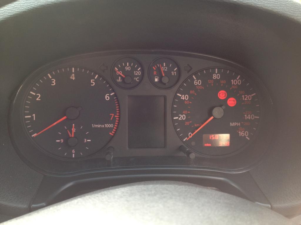

xtreme-styling Posted November 12, 2011 Author Report Share Posted November 12, 2011 There is no warning lights on it at all, its dead. on the key i get the airbag and imm key (car icon) and both go out as they should i spoke to Audi over the phone and they say my model should have "dis" and sounds like the car had a dash swop but not coded to car? and if a simple coding £120 to do it. they got it down to 2 dashs for my model part 8l09020980ex or 8l09020950cx from my chassis code. added pic Link to comment Share on other sites More sharing options...

shark_90 Posted November 16, 2011 Report Share Posted November 16, 2011 Part number 8L0 919 930 E as fitted to your car (taken from the part number in the scan above) is for Audi A3 petrol analogue clock 160MPH with FIS (DIS), so I think it's a simple case of your cluster perhaps being broken. If you go in to 17 Instruments and do the output tests it should do a cluster test which shows all pixels on the display. Link to comment Share on other sites More sharing options...
xtreme-styling Posted November 16, 2011 Author Report Share Posted November 16, 2011 cheers mate, yep thats the one, analogue clock, the last owner said spent 200 pounds on it, but never was told about computer in front, one a3 i saw had the small 4 squares at top ill do the scan, so i just have to click 17 and thats it? or? Link to comment Share on other sites More sharing options...
xtreme-styling Posted November 16, 2011 Author Report Share Posted November 16, 2011 ok did the outputs on 17 the sound for warning sound for seat-belt comes on, but does normally, so someone must of changed that the one for temp over heat test comes back as error? sweep deals works, segment works, lights fading all ok went to steering wheel controls, comes back straight away as no response from controller? nothing at all from the middle, no light, pixels, nothing Link to comment Share on other sites More sharing options...
