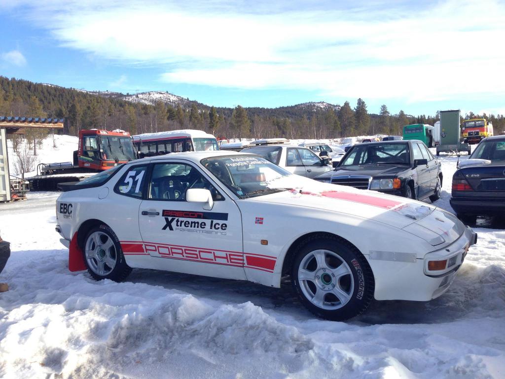

Compare and contrast with when I got it:
