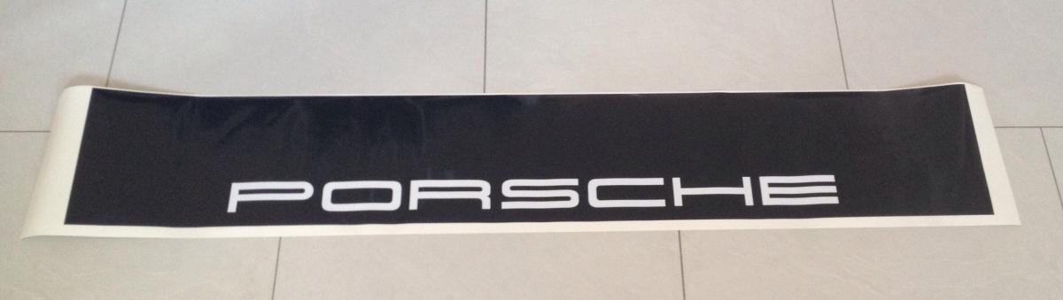

eldavo69 Posted March 4, 2014 Author Report Share Posted March 4, 2014 Things to make and do: With the fixed bucket seats being so low the sun visors are pretty useless so this sun strip turned up today. I need to make sure I fit it low enough to be useful and high enough to pass an MOT or else I'll be resorting to a shorter MOT-spec wiper once a year Link to comment Share on other sites More sharing options...
NewNiceMrMe Posted March 4, 2014 Report Share Posted March 4, 2014 You've bought ANOTHER sticker? 1 Link to comment Share on other sites More sharing options...
patently Posted March 4, 2014 Report Share Posted March 4, 2014 You've bought ANOTHER sticker? Says the man with a WHICH sticker in his signature 2 Link to comment Share on other sites More sharing options...
Tipex Posted March 4, 2014 Report Share Posted March 4, 2014 (edited) Oh my, a sun strip, how very 80's Barry, still, I suppose it's period correct! You'd be better of with a pensioner special clip on flip down extra visor, at least you can hide it when you don't need it, they usually sell them in those little catalogs that come with the Sunday papers. Here you go - http://www.ebay.co.uk/itm/Sun-Zapper-Clip-On-Car-Sun-Visor-Extender-FREE-UK-POSTAGE-/380840046191?pt=LH_DefaultDomain_3&hash=item58abd5ee6f Edited March 4, 2014 by Tipex Link to comment Share on other sites More sharing options...
eldavo69 Posted March 4, 2014 Author Report Share Posted March 4, 2014 Yeah, BAZZA N SHAZZA wouldn't fit Link to comment Share on other sites More sharing options...
Tipex Posted March 4, 2014 Report Share Posted March 4, 2014 'Shaz N Dave' would have looked great, if your Mrs was called Dave! Link to comment Share on other sites More sharing options...
