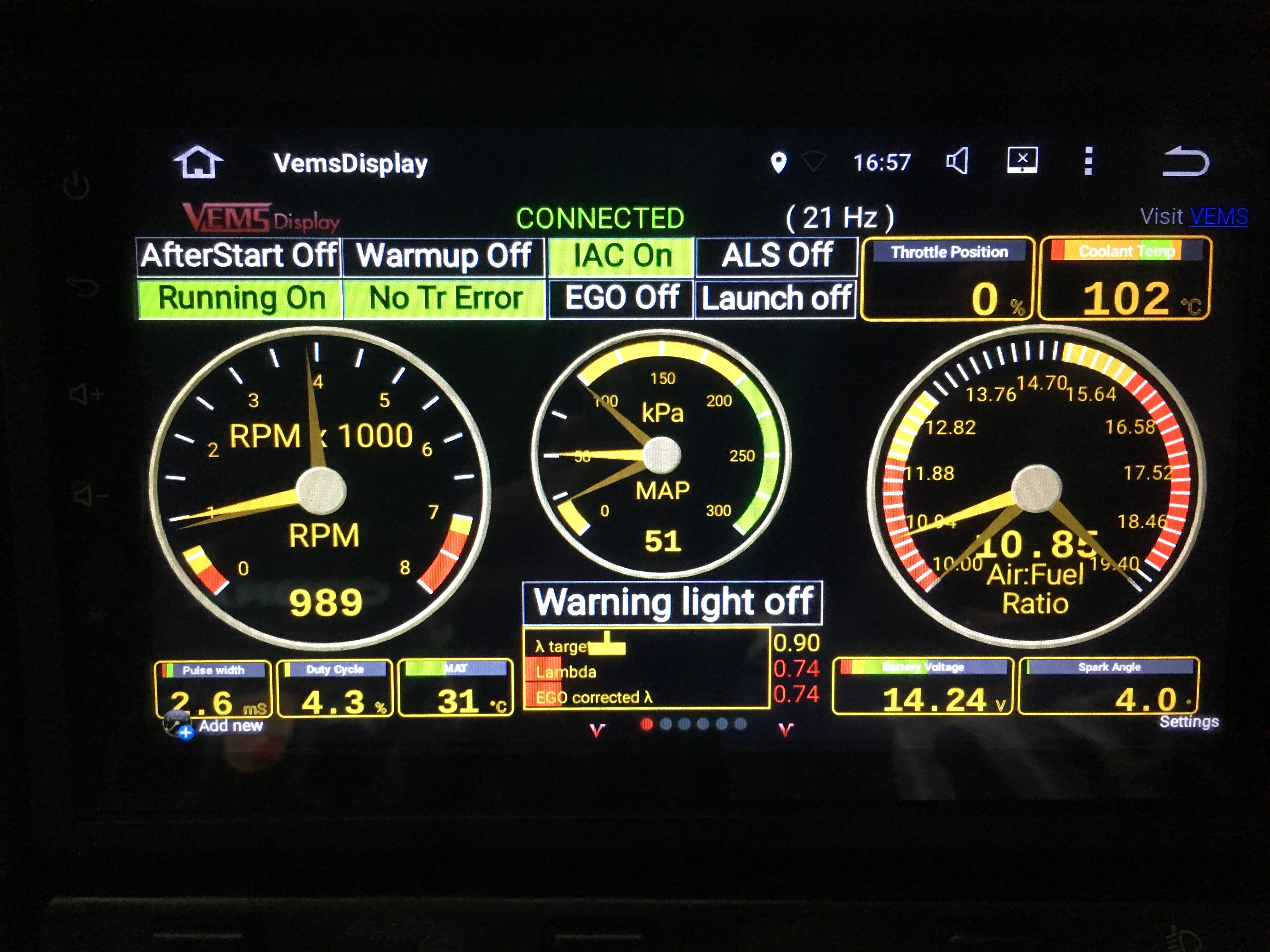

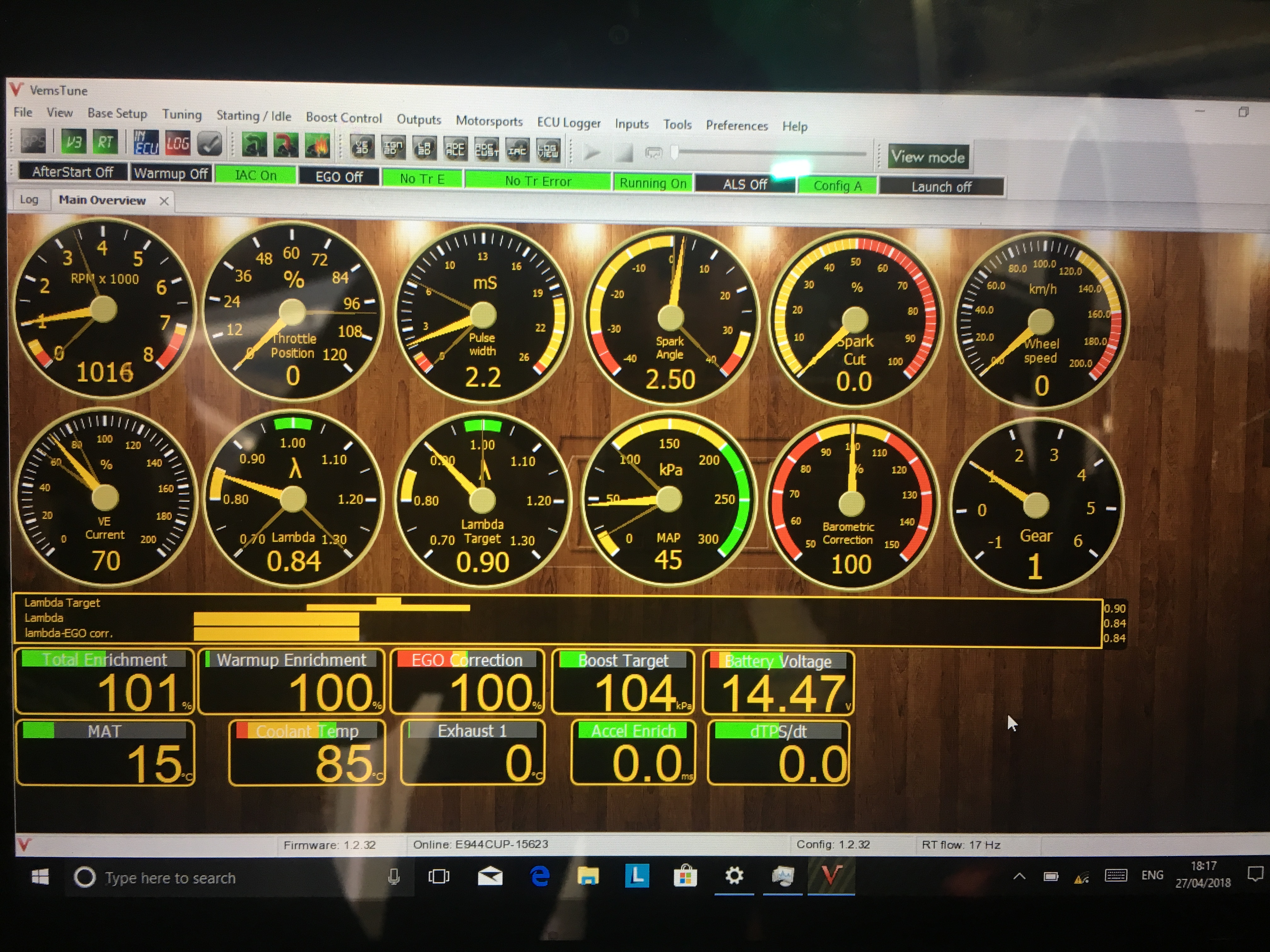

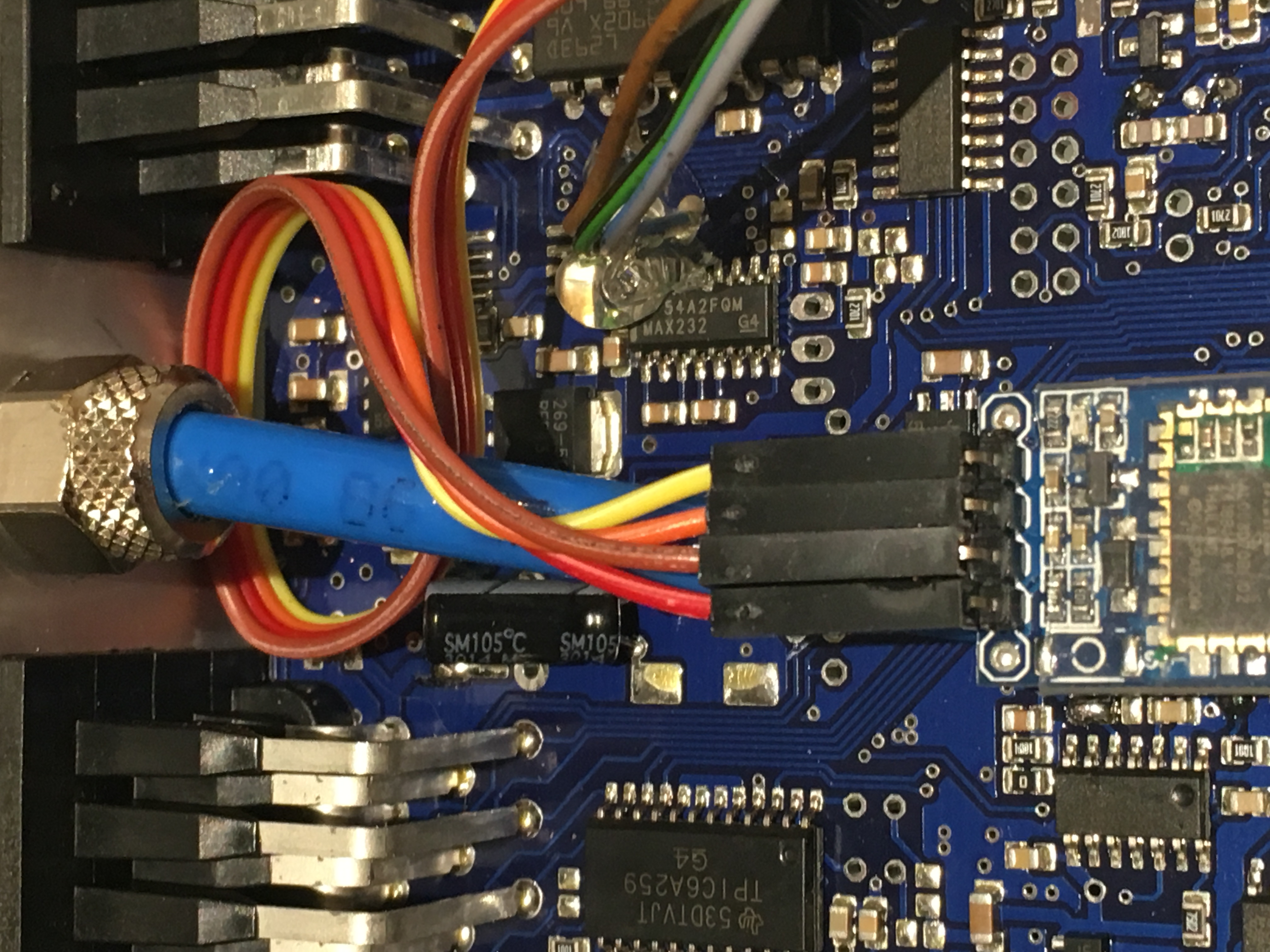

eldavo69 Posted March 6, 2018 Author Report Share Posted March 6, 2018 The 944 Twbo S is finished - sort of. It needs a seam in the exhaust welding back up but the garage that made the exhaust can’t fit it in until the beginning of next month. I’m reticent to bring the car home as it’s currently 1/2 a mile from the exhaust place so hopefully they’ll see sense. It’s running really rich when warm, I’ve checked the logs on the laptop and I think the ECU engine temperature sensor is duff - I have a new one to get fitted this week so hopefully that’s that sorted. Ive not driven the Twbo since I dropped it off at the garage in September. Since October I’ve driven the Boxster for about 1 week when I used it as my daily driver - it’s sat in the dehumidified garage polished and preened on a battery charger. Given that the Twbo will be going back in the garage (and the other half is now a gym) it means that the Boxster will be sat outside on the drive. Therefore, after a lot of soul searching I’ve decided to do the sensible thing . . . . . I’ve bought a 911 to keep it company. 3 Link to comment Share on other sites More sharing options...

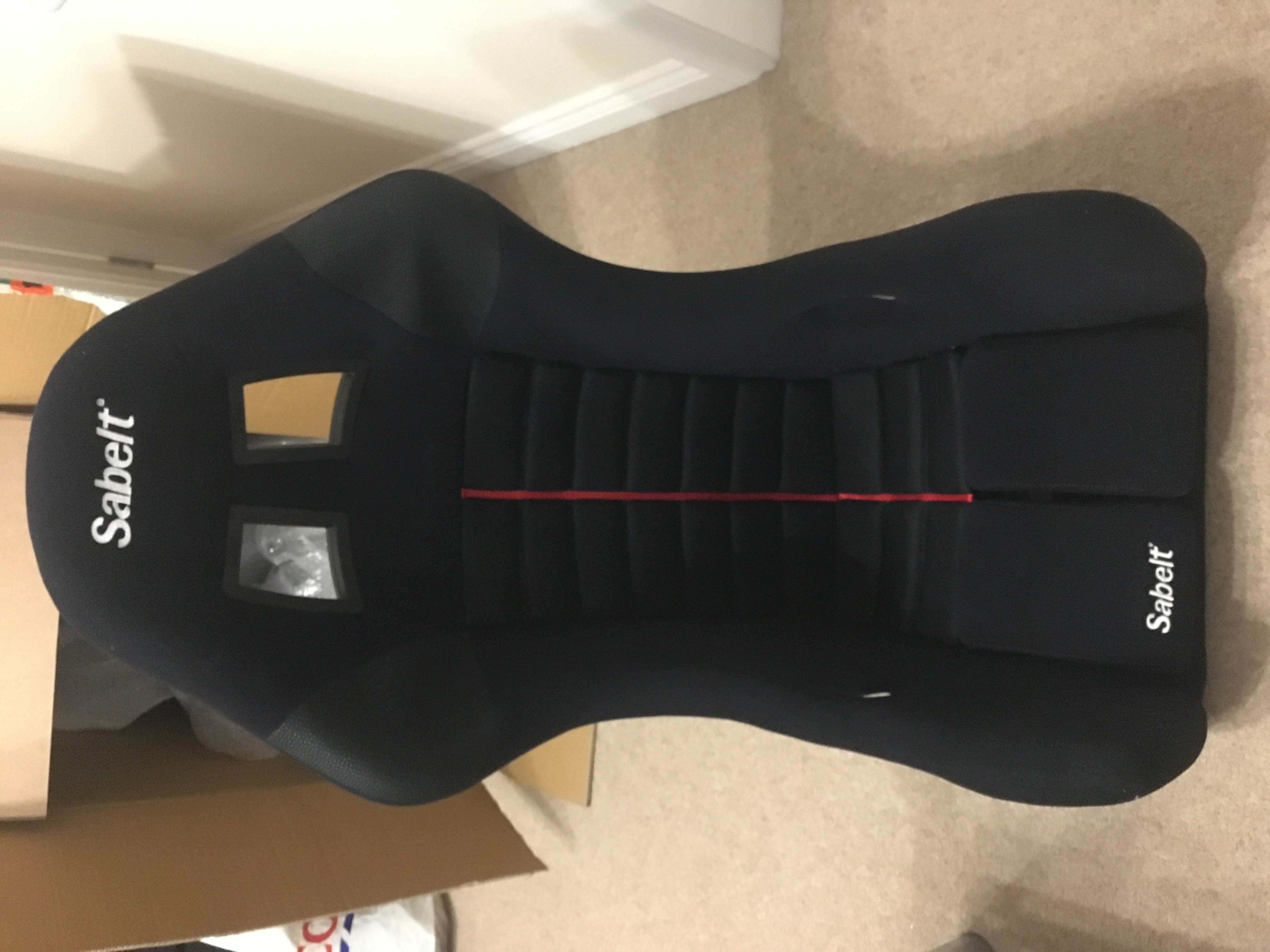

eldavo69 Posted March 20, 2018 Author Report Share Posted March 20, 2018 Back in November I spent some time at GSM Sport Seats trying out a load of buckets to find some that were a perfect fit. Ordered them in late January and they finally turned up last week in a rather large box. Picture is of the larger passenger seat, mine is still in the box - same style but one size smaller. Link to comment Share on other sites More sharing options...

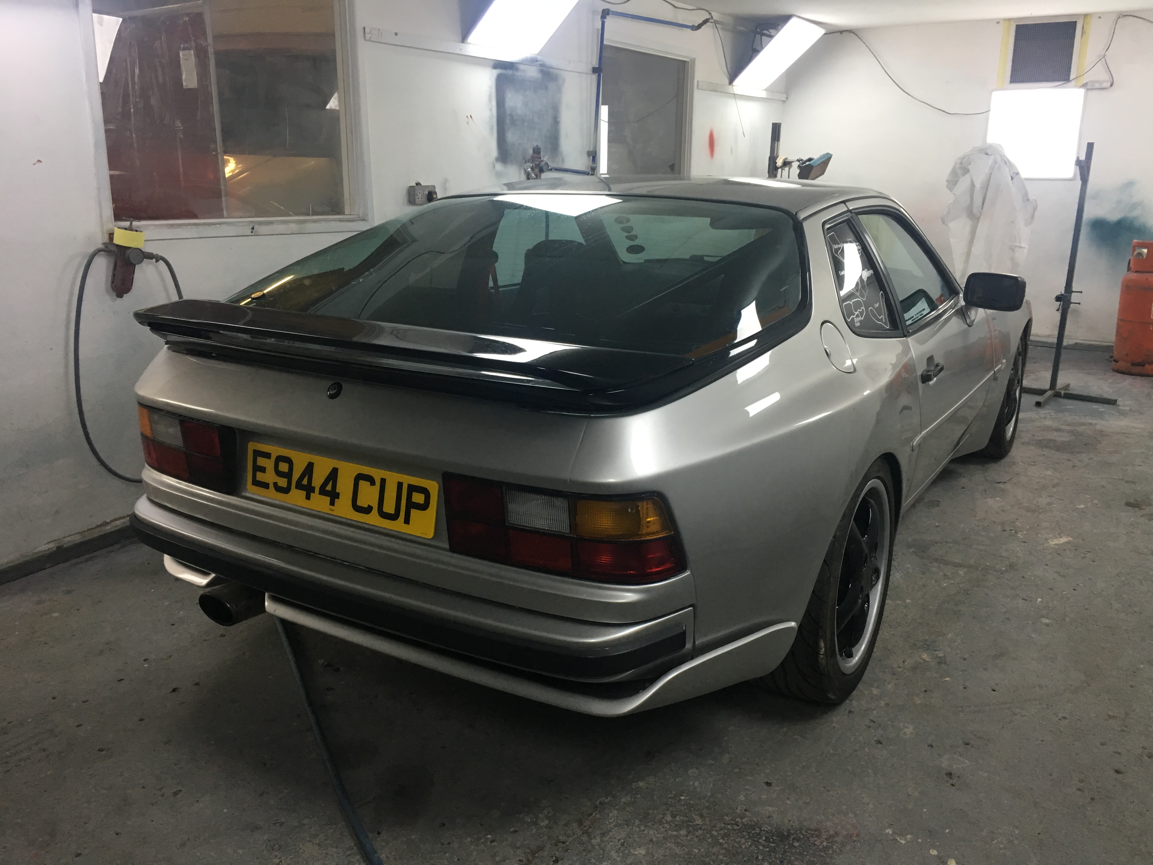

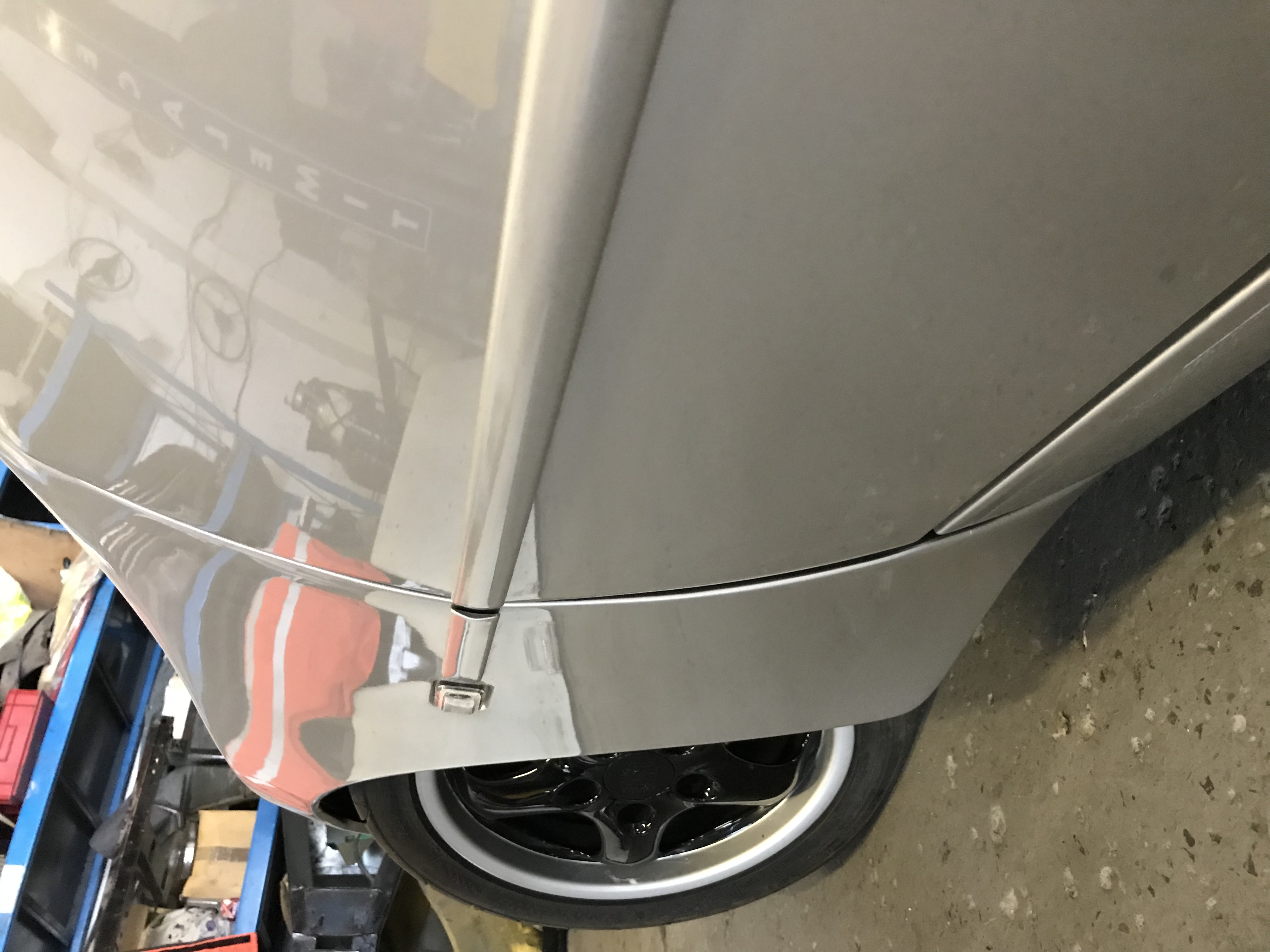

eldavo69 Posted March 20, 2018 Author Report Share Posted March 20, 2018 Wings have been massaged into place, the brackets needed a bit of fettling to line up. Just a bit of paintwork on the rear quarter to be redone and then it’s coming back to mine! 3 Link to comment Share on other sites More sharing options...

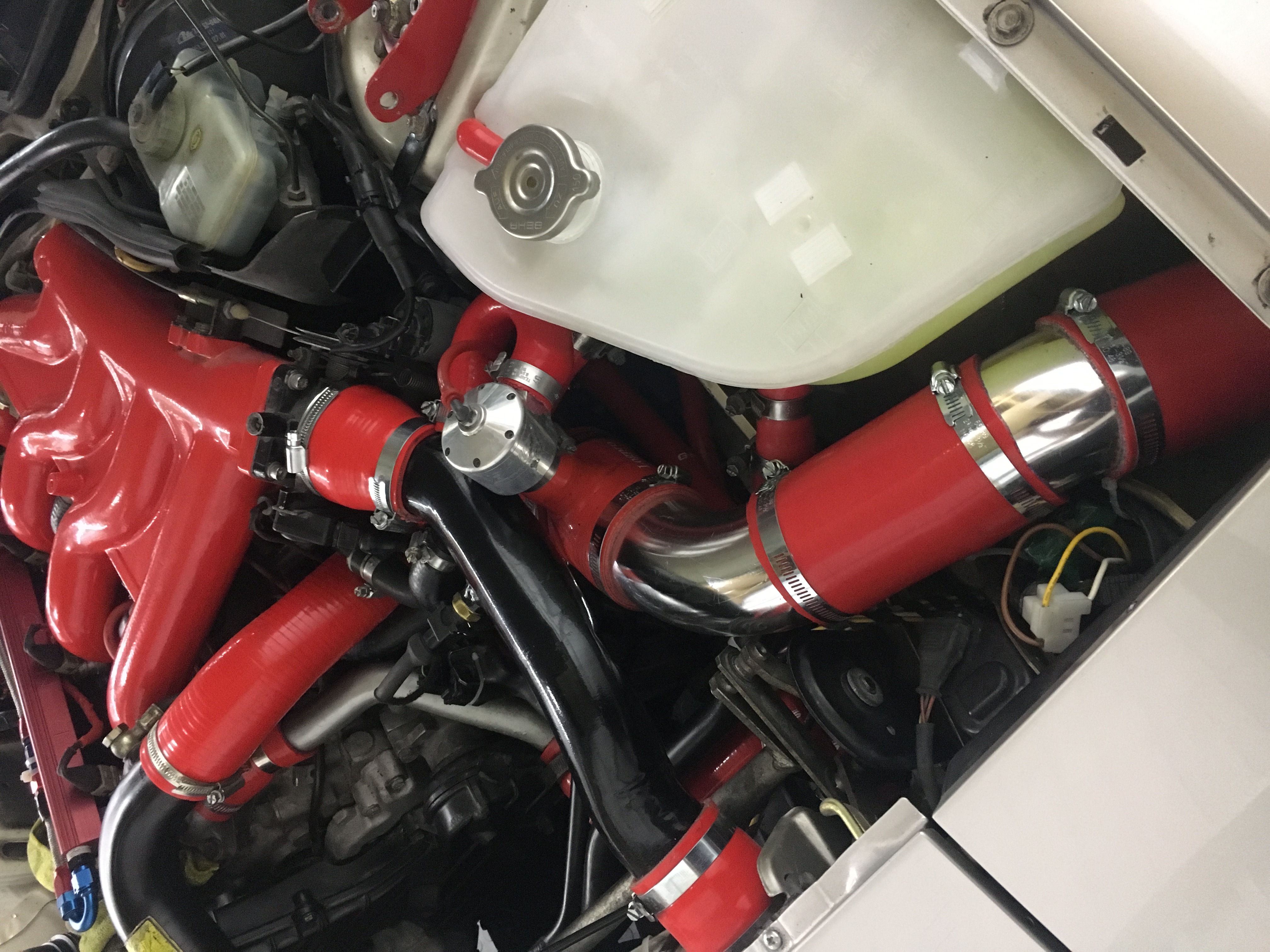

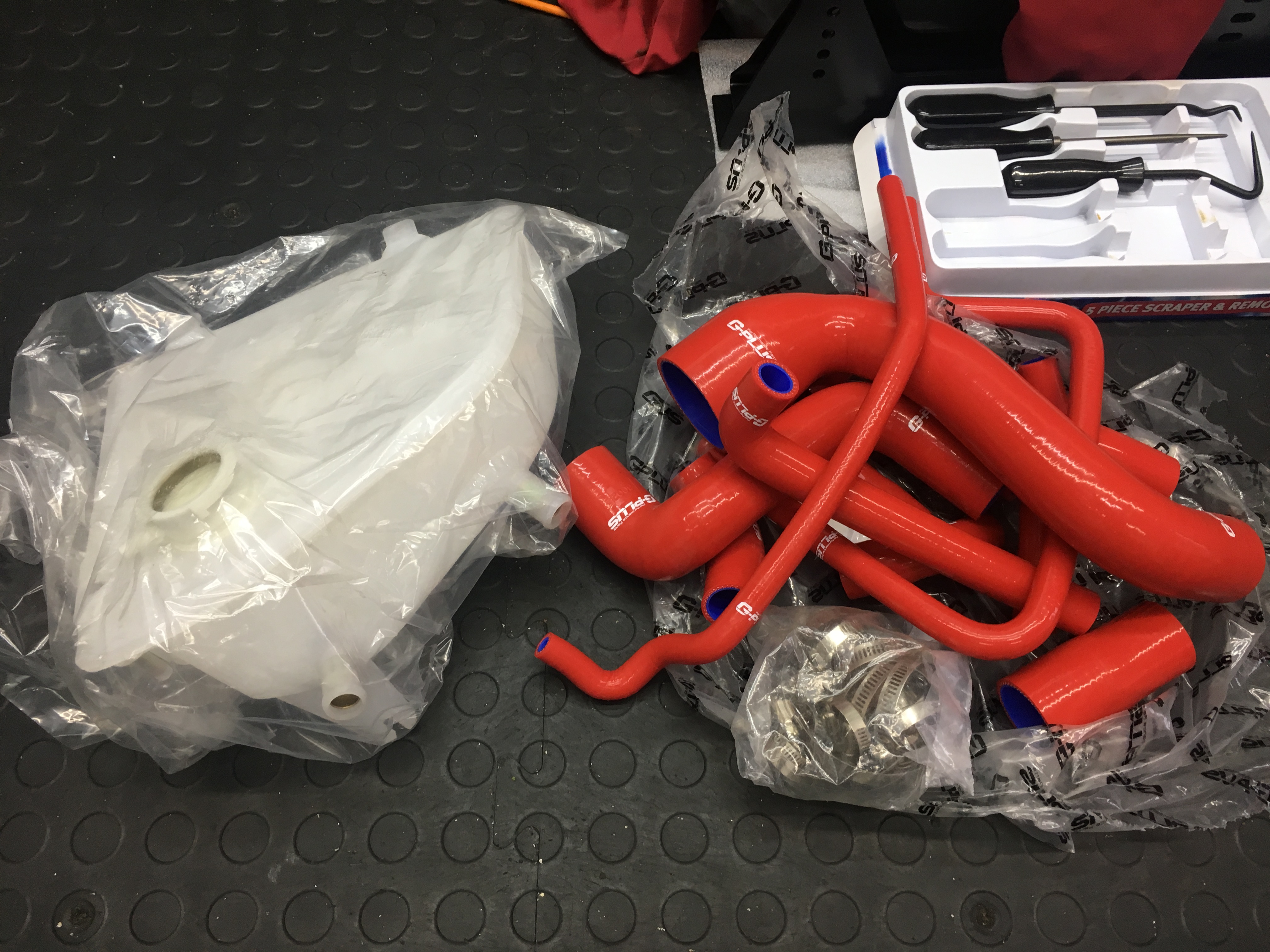

eldavo69 Posted April 20, 2018 Author Report Share Posted April 20, 2018 Got some new shiny shiny bits to fit too, a new expansion header tank that I bought myself for Xmas (£200!!!) and a set of silicon radiator hoses to replace all the crusty old perished rubber ones: Link to comment Share on other sites More sharing options...

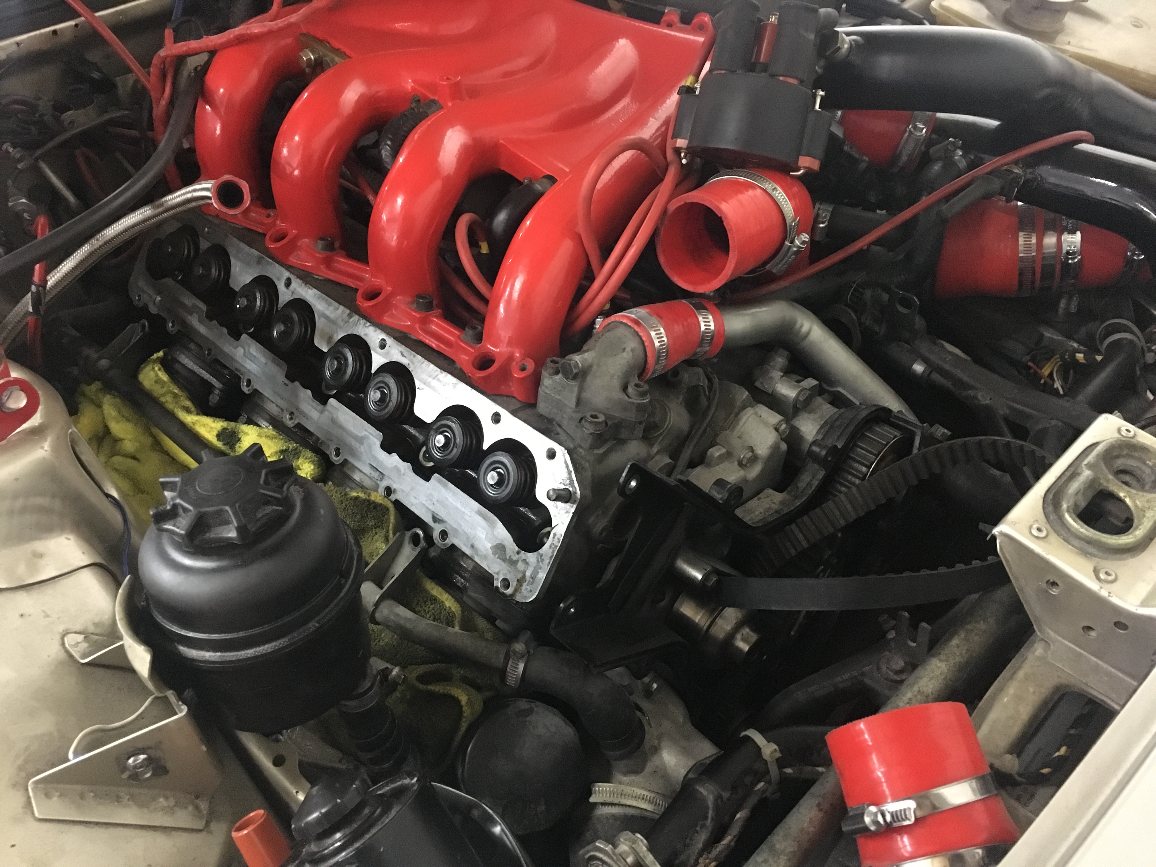

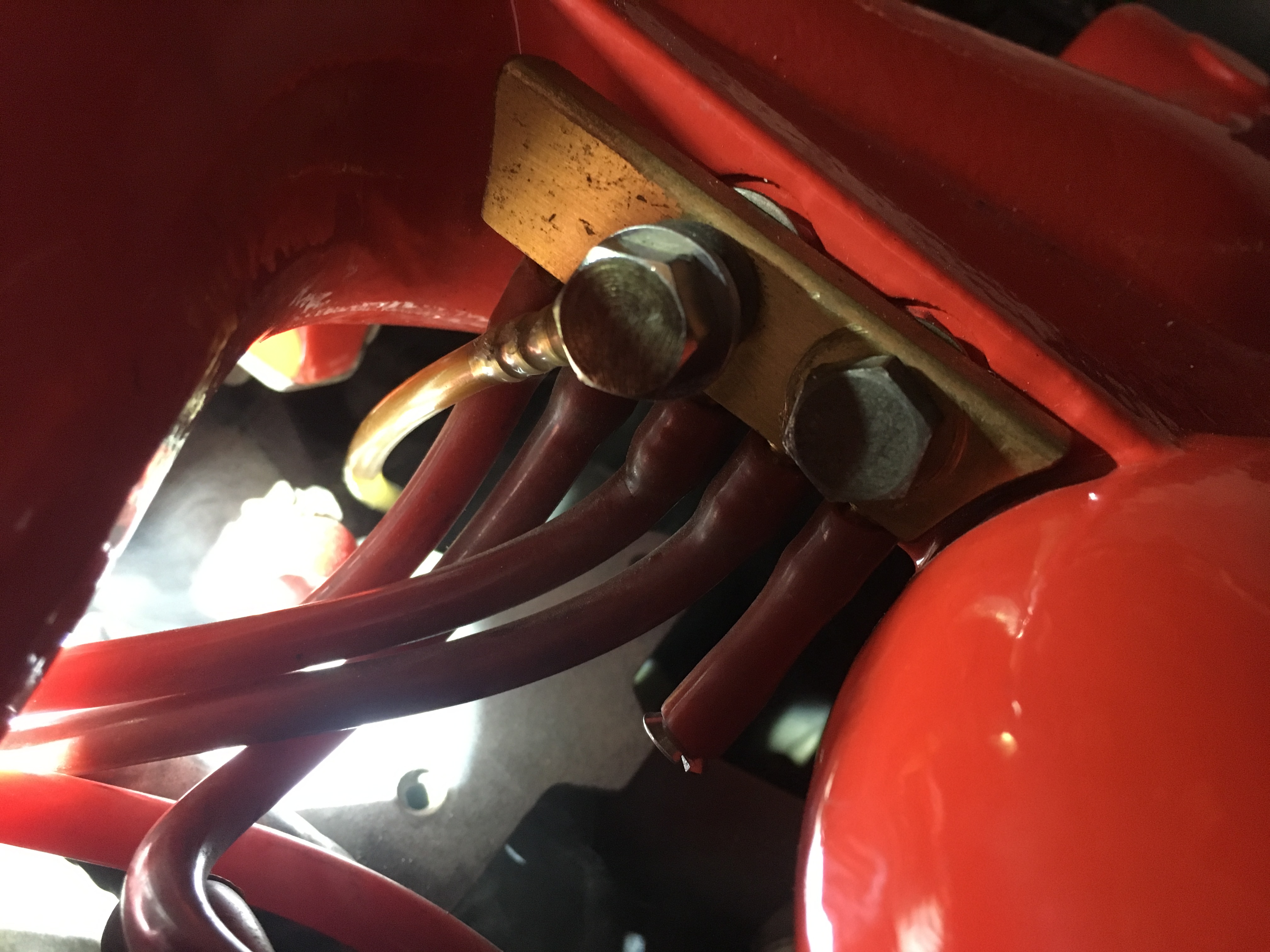

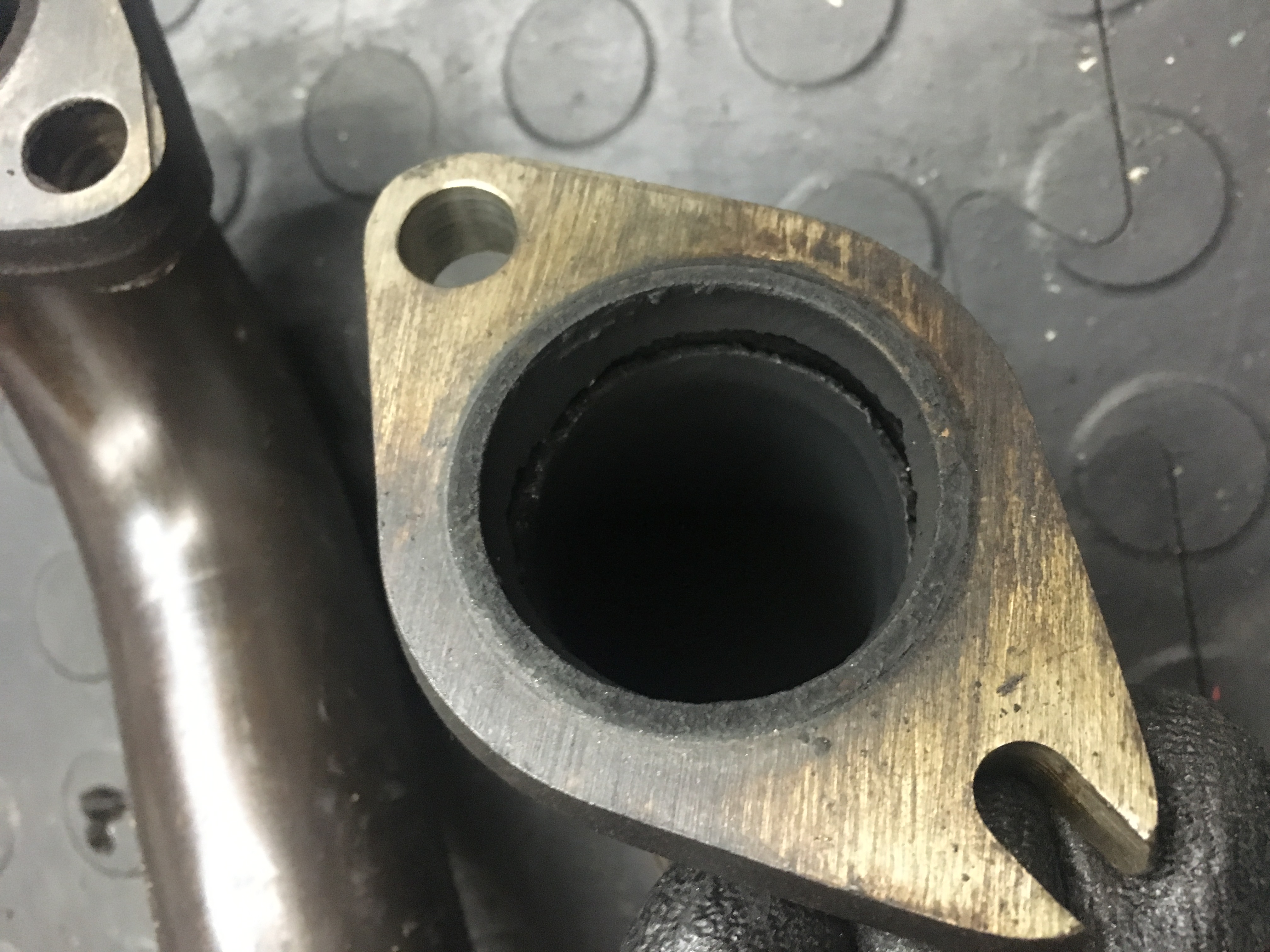

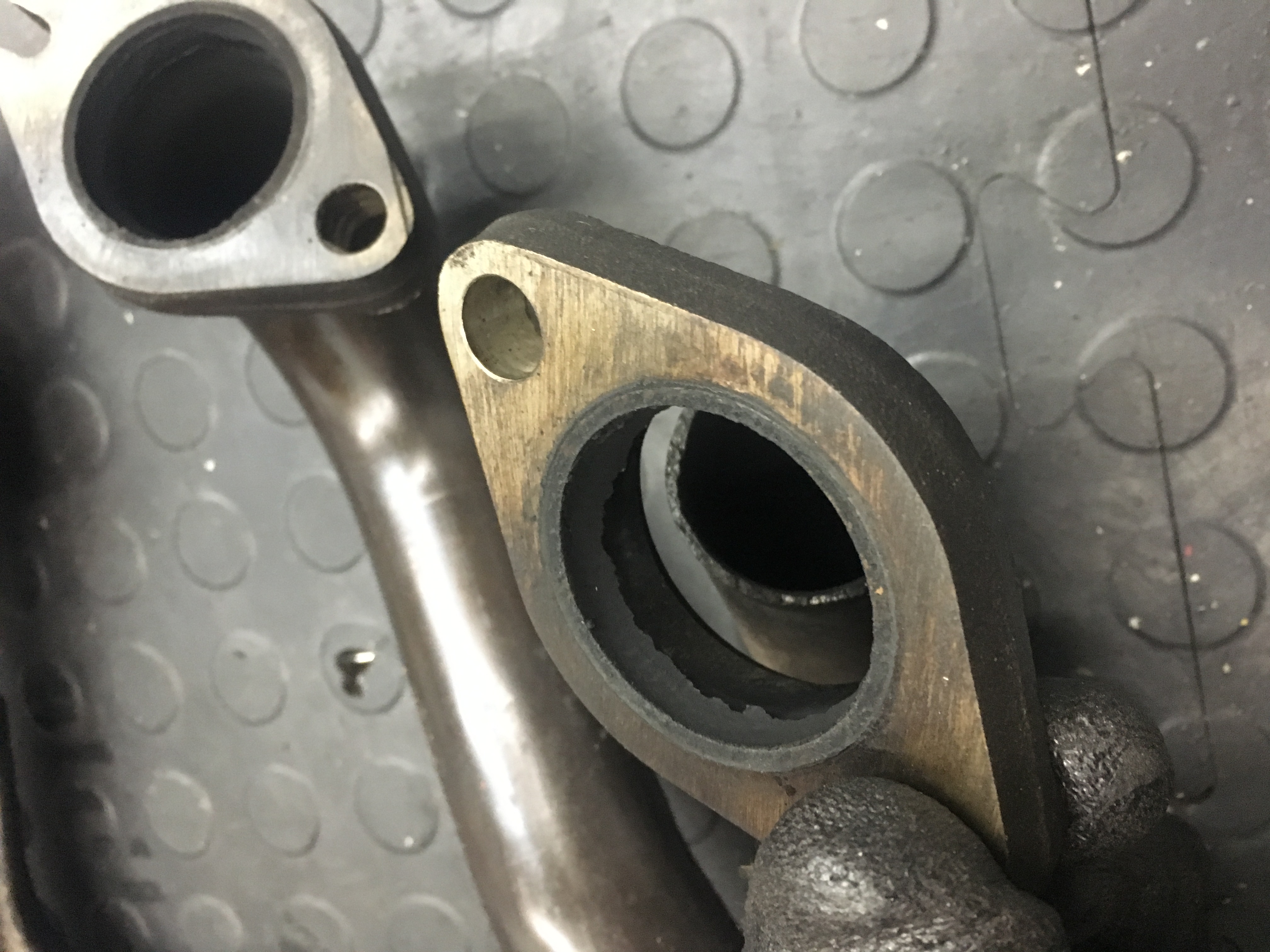

eldavo69 Posted April 20, 2018 Author Report Share Posted April 20, 2018 I’d noticed a slight blow from the exhaust manifold too, with the cam tower off access to the manifolds was “easier”. I say that as you have to double-nut the studs and remove them from the head as there isn’t enough room to get the manifolds off in situ. If s stud breaks then you have to remove the cylinder head and get s machine shop to get it out due to the lack of access. Luckily (or probably due to the oil leak) all the studs came off no problem in 15 mins - the six bolts holding the bottom of the manifold to the crossover pipe took me a further hour to remove, access was tight and they needed 2 grunts of effort to free off. Manifold off, problem was clear to see, one inlet was cracked and the other had actually broken! Dropped it off at a local Exhaust Repair Specialist to be welded up as it’s made of Inconel Alloy - no such thing as cost savings in the 80’s it would seem, Porsche were a proper engineering firm back then. Link to comment Share on other sites More sharing options...

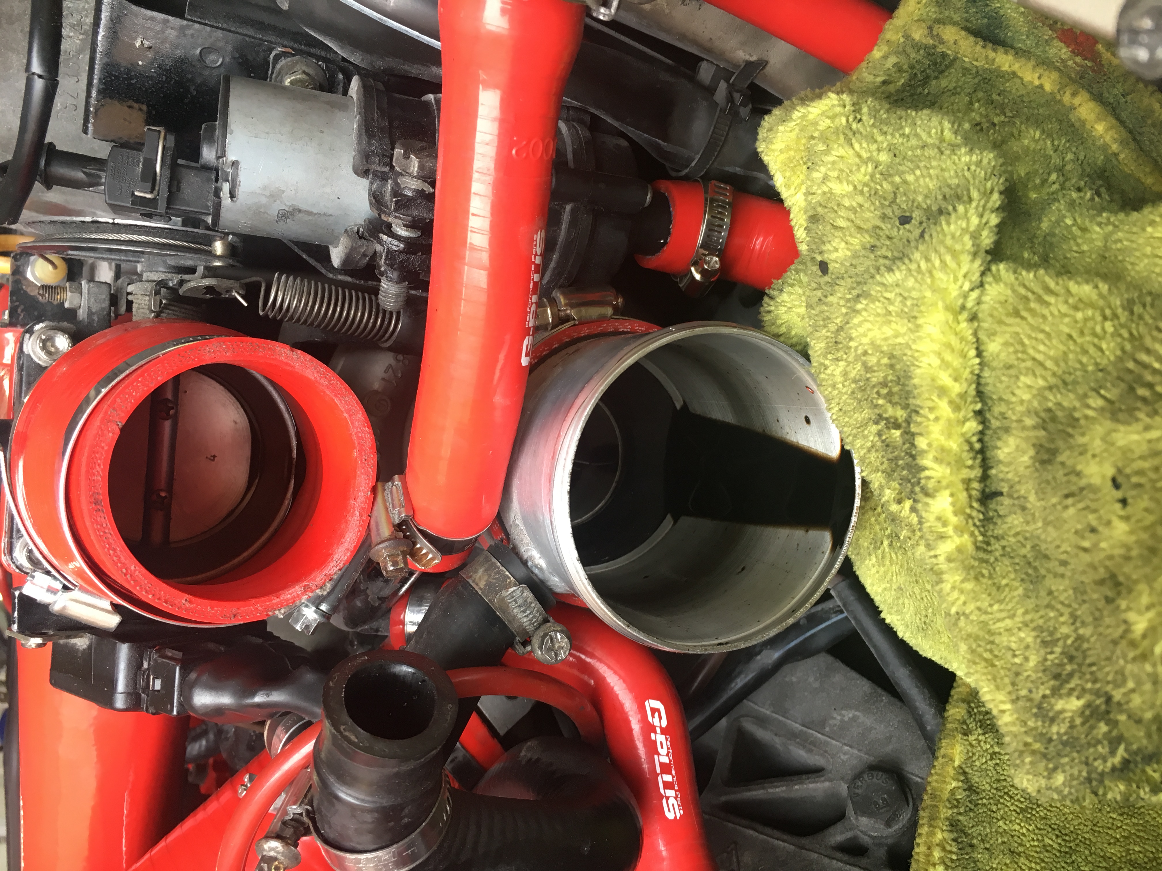

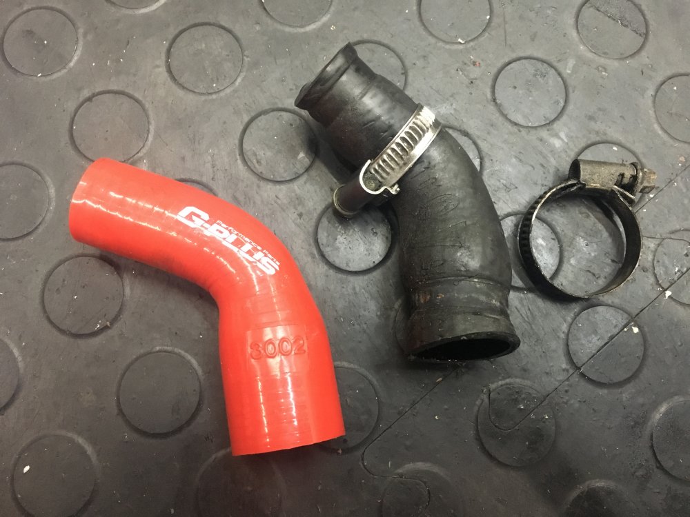

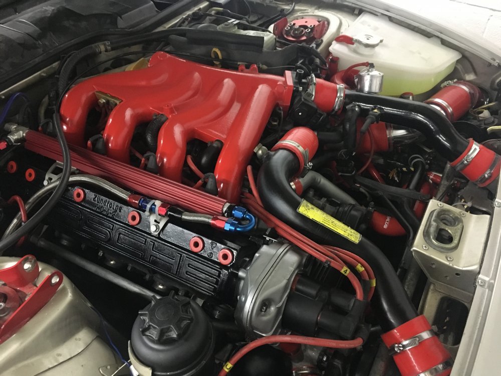

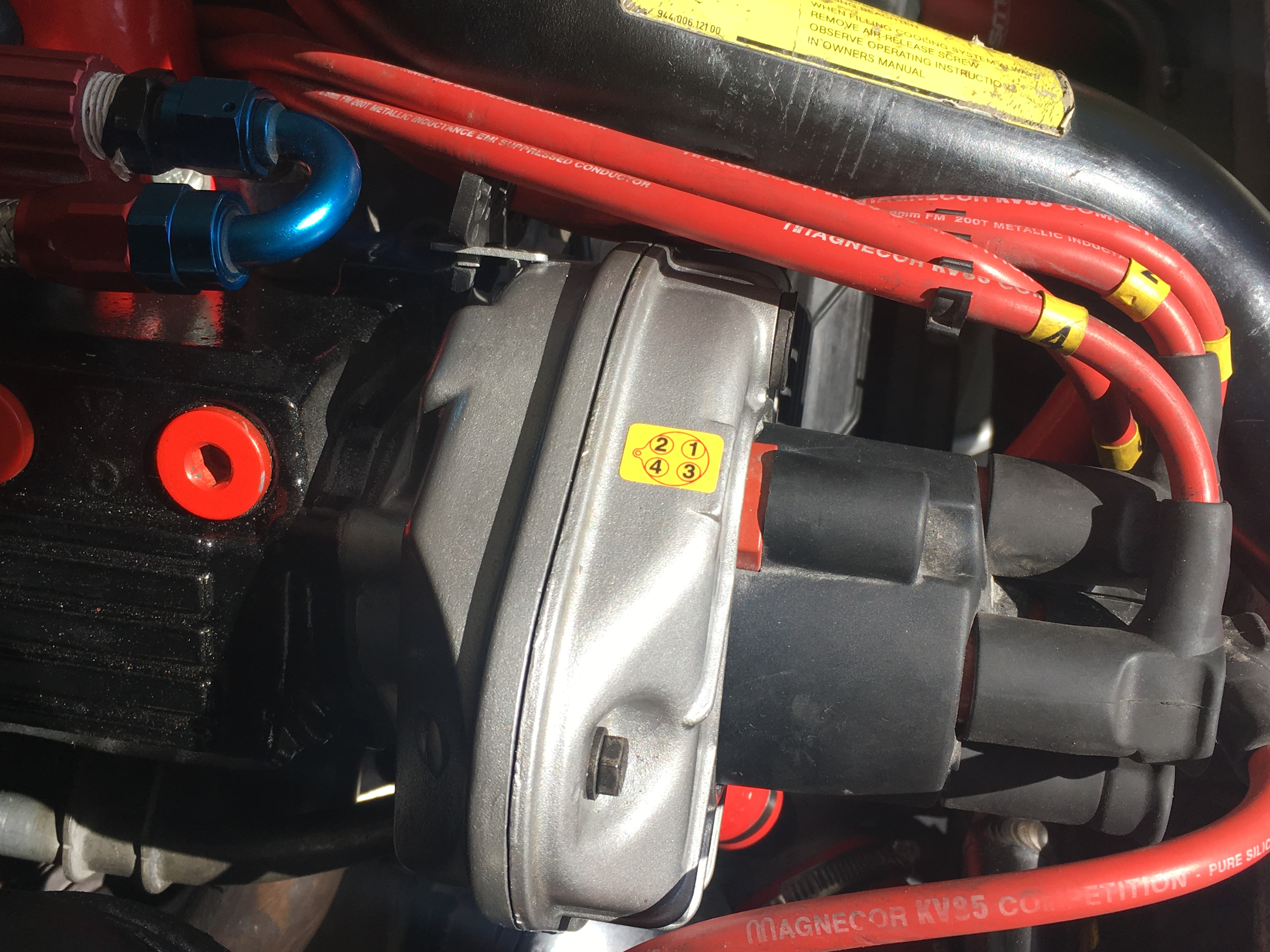

eldavo69 Posted April 20, 2018 Author Report Share Posted April 20, 2018 New header tank and hoses fitted, I rationalised the air intake pipework a little to remove an extra couple of joins. Filter now sits in the space between the bumper and the wing hidden behind the arch liner receiving nice cold air. Everything fully reassembled and the final flourish is a new distributor sticker - what you didn’t think I’d remove all those bits without cleaning and painting them did you? I have a new intercooler pipe sticker too, so will be fitting that when I’ve painted the pipe as it looks a bit scraggy next to everything else now. 1 Link to comment Share on other sites More sharing options...

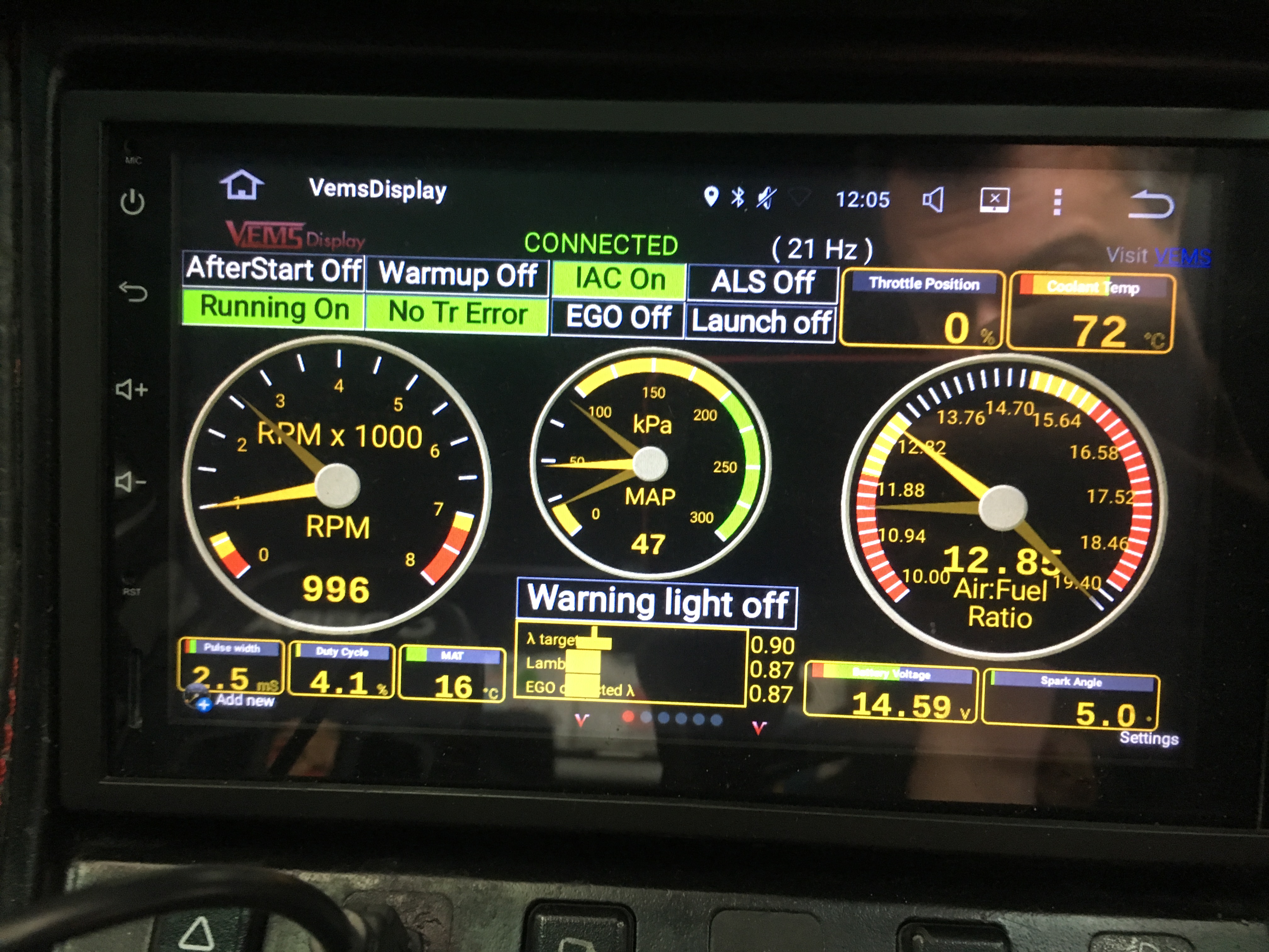

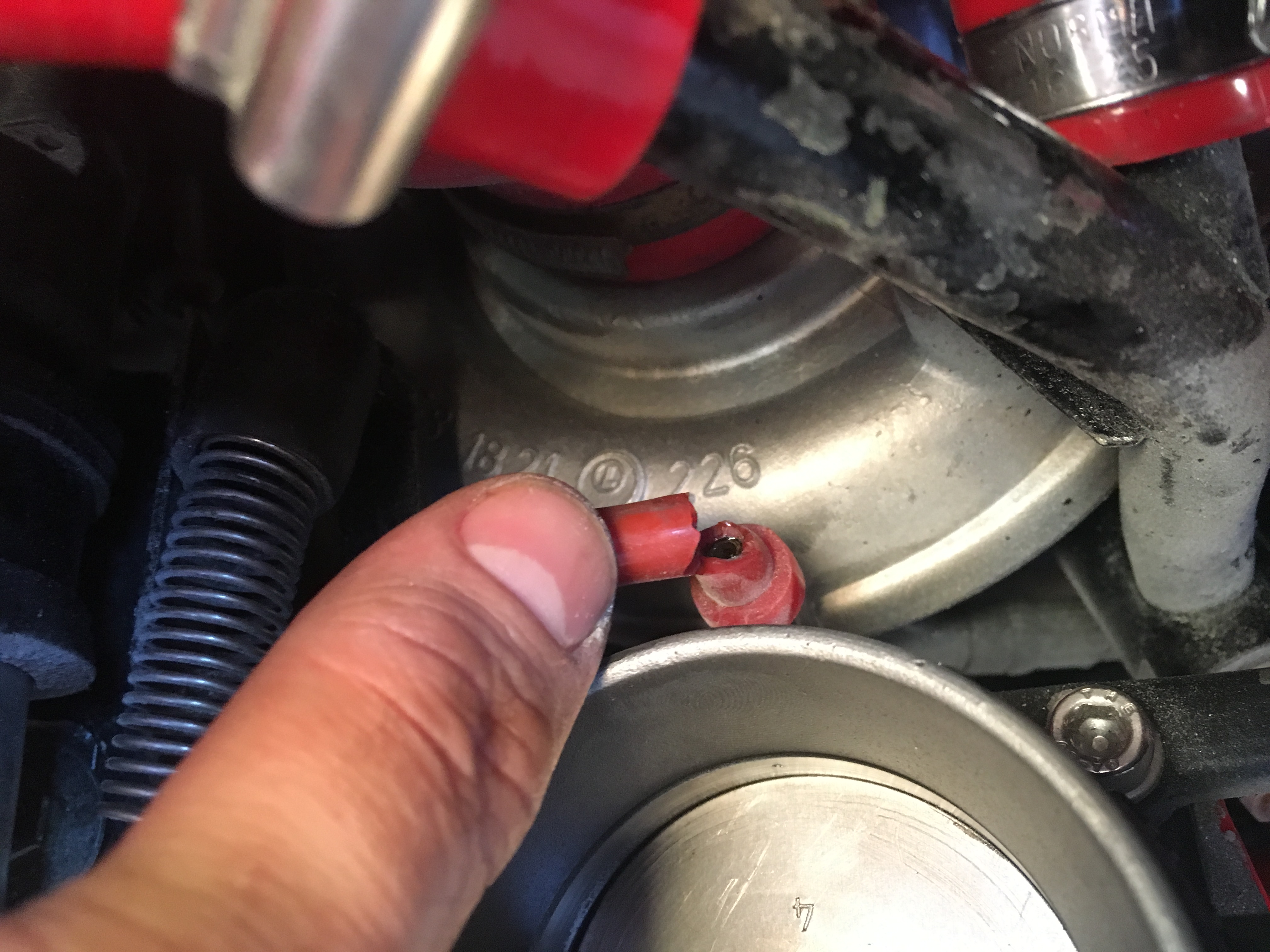

eldavo69 Posted May 2, 2018 Author Report Share Posted May 2, 2018 Back together and running like a dog - supper rich and constantly on the edge of a misfire. Borrowed a Smoke Tester from my Porsche Indy’s - it generates a harmless smoke and you hook it up to an airline to pressurise the system to find leaks in the intake and vacuum system. Handily I have a compressor tucked away in the garage and a retractable air line on the wall - naturally. Found a split hose under the throttle body and a leaking vacuum manifold - both now sorted and running improved a bit. Pulled the plug leads and they weren’t in great condition, fitted some new Bosch plugs and new Beru leads and everything “seems” ok now - needs a decent run out to test it, then an MOT. Opened up the ECU and made a couple of changes to enable the boost gauge on the dashboard, need to add a switch into the case to toggle between Bluetooth connection for the Head Unit and wired for the laptop as the Bluetooth is a bit flakey and drops out every now and then - not ideal when tuning and burning the config file to the ECU!!! 1 Link to comment Share on other sites More sharing options...

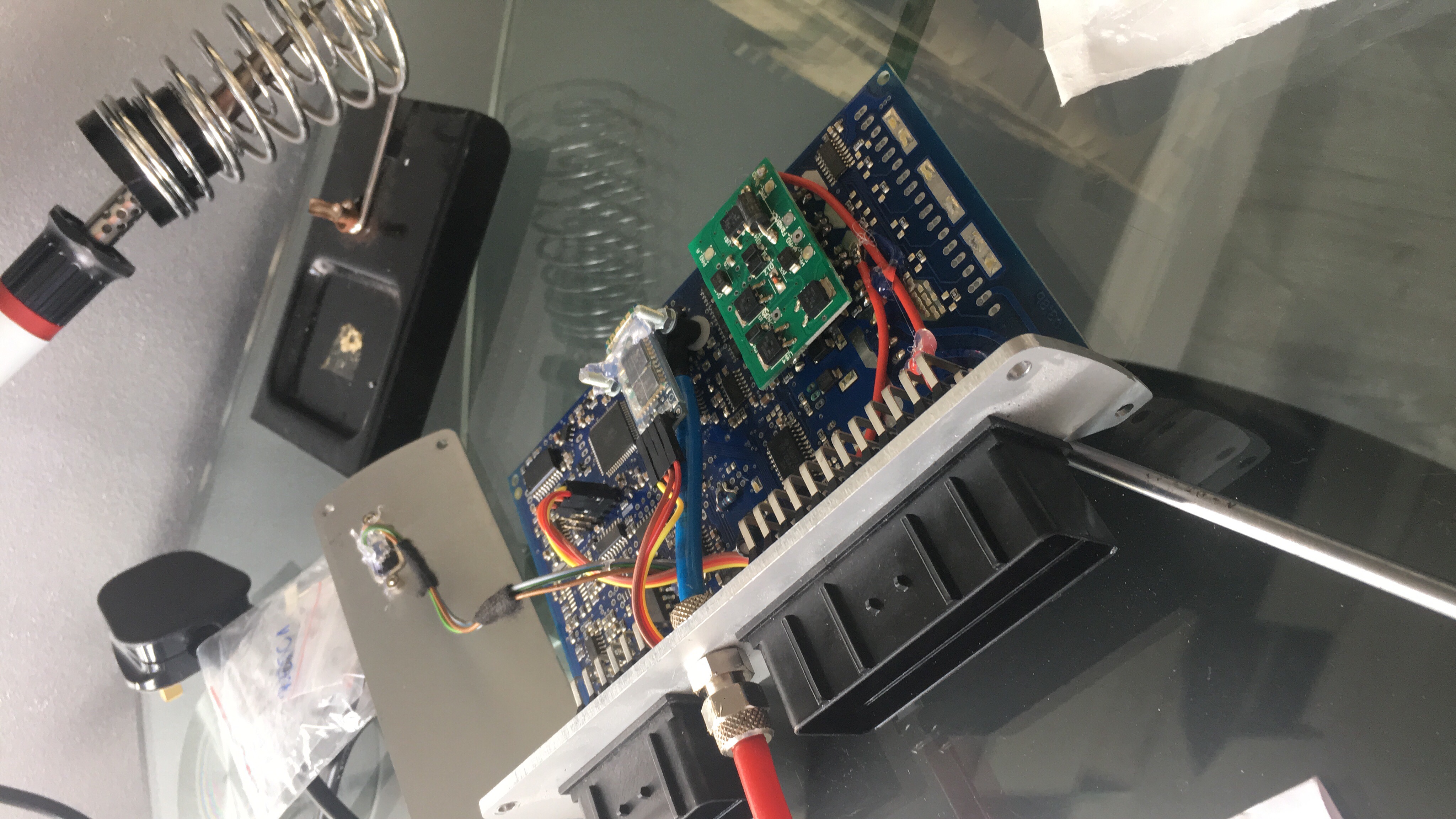

eldavo69 Posted May 7, 2018 Author Report Share Posted May 7, 2018 3 hours ago, Rachel said: This is getting waaaay too serious... Are you going to apply the same electrickery wizardry to the 996? Nope - 996 electronics are much more modern and happily do their own thing with a hot wire MAF. This ECU would be overkill on a standard 944T but really supports the modifications I’ve made. Annoyingly, the cam gasket I used is an uprated multi layer steel one but they sometimes have sealing issues. Am still having a small oil weep from one corner of the cam tower so will whip it back off and change to a standard gasket that I already have. Link to comment Share on other sites More sharing options...

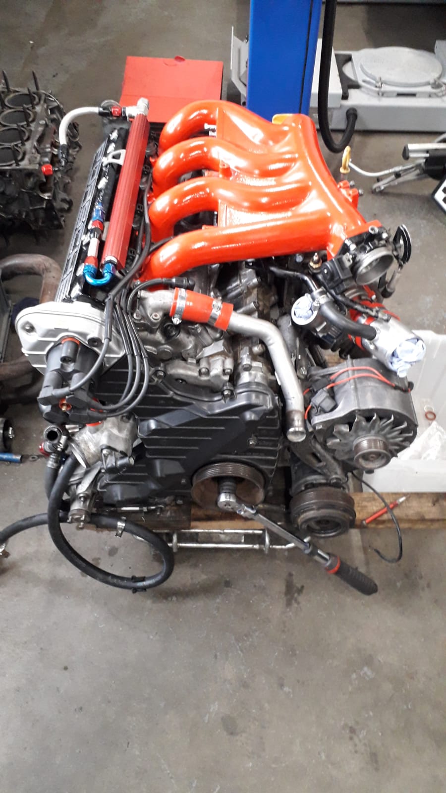

eldavo69 Posted June 6, 2019 Author Report Share Posted June 6, 2019 Engine is pretty much back together and going back in the car in 2 weeks. Made lots of “while you’re in there upgrades” and also a big saving on machining costs so budget wasn’t completely blown (maybe 20% tops - ish). Lots of geeky pictures on my phone of various engine rebuild stages but this one is the satisfying one: Link to comment Share on other sites More sharing options...
