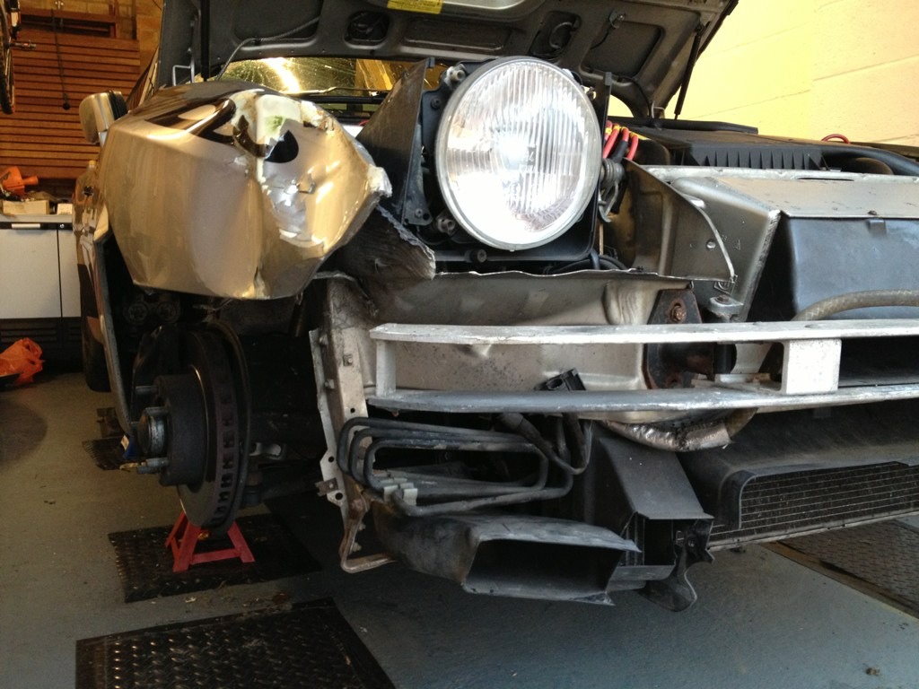

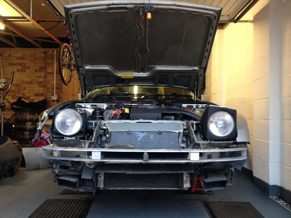

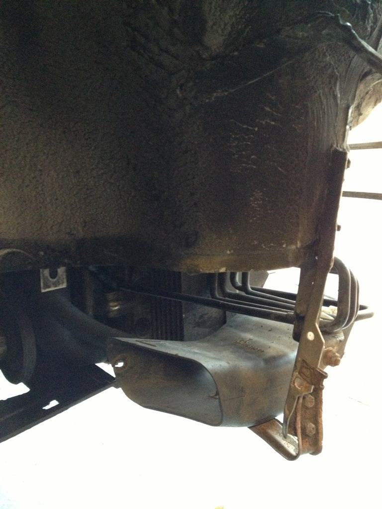

eldavo69 Posted November 9, 2012 Author Report Share Posted November 9, 2012 Well, got my project mojo back this week. I took delivery of all the interior trim bits I need to replace the headlining and quarter panels, etc. after the bodywork has been done along with a kit to repair the clock screen and a replacement arch liner. I got in touch with a local windscreen fitters I was recommended, they have a correct screen in stock and will remove the old one, supply the new one and fit it at a later date when the bodywork has been done. (Screen is needed loose to line up the pillar work, etc.) The windscreen company will also do it as a glass claim via the insurance company so it'll be £75/£100/whatever it says on my policy. Got the car on axle stands and removed the mashed up arch liner to see the extent of the damage: [ATTACH]47252[/ATTACH] Removed the badge panel that covers the intercooler and the bent headlight cover. Replaced the plastic trim pieces and bent the surround back into shape: [ATTACH]47253[/ATTACH] The brake cooling duct bracket was bent at a jaunty angle and the power steering pipe cooling loop was knocked out of position: [ATTACH]47254[/ATTACH] A bit of bending and pulling saw this straightened out and sorted near enough at the moment. When the arch liner is refitted it'll bolt into this and straighten everything up properly: [ATTACH]47255[/ATTACH] Removed the undertray "batwing" and then the light units from the bumper. Unbolted the bumper from the wings at either side and it slid neatly off: [ATTACH]47256[/ATTACH] [ATTACH]47257[/ATTACH] [ATTACH]47258[/ATTACH] The wing is proving a bit of a challenge as the 3/4 remaining bolts sit under a load of underseal and behind the wing-mounted ABS pump. My friend locally reckons you can release the ABS pump from its mounting and get to the bolts if you know where they are rather than remove the pump. I've changed a pump before and it's a bit of a faff, so he's going to come round over the weekend and show me how it's done! Plan is to get the bodywork done by Xmas and then sort the interior and refresh the top end of the engine in the new year. Ready for MOT and tax in March/April. Link to comment Share on other sites More sharing options...
