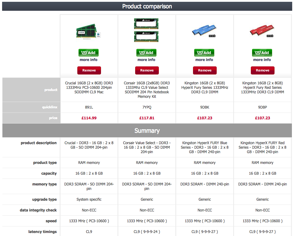

cabby Posted February 1, 2015 Author Report Share Posted February 1, 2015 (edited) I thought it was 16 GB but was getting confused by 'mid 2012' and 'late 2011' model descriptions. I did a HD upgrade on my old MacBook to a hybrid jobby and that made a huge difference so I can image a full SSD one would be great. Had a look on dabs as they have a decent selection but struggling to work out how to pick (other than price!). Memory is all the same, right? Edited February 1, 2015 by cabby Link to comment Share on other sites More sharing options...
NewNiceMrMe Posted February 1, 2015 Report Share Posted February 1, 2015 The Crucial RAM is marked specifically for Mac in that listing and that's what I'd choose. However, I'd order directly from Crucial. I recently sold an SSD (256gb OCZ Vertex) that was in my old Macbook Pro and would have fitted yours. I mentioned it on here a few months back - and sold it to a friend for £50! Link to comment Share on other sites More sharing options...

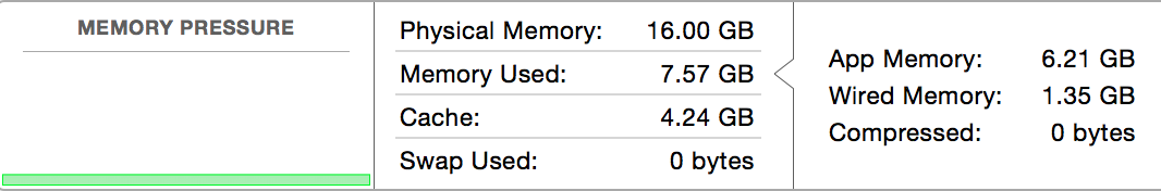

Mac Posted August 11, 2015 Report Share Posted August 11, 2015 OSX is good at managing memory, but you have to be careful on how you read the stats as memory usage isn't what it would seem. You're more interested in the 'memory demands' rather than free memory, that's why Active Monitor has switched to memory pressure rather than free etc. I rarely bother closing stuff down on OS X, I rarely see any point. Right now I have three Virtual machines running for example, and loads of apps: Link to comment Share on other sites More sharing options...
Mac Posted August 11, 2015 Report Share Posted August 11, 2015 (edited) ...and this is the memory pressure: ...not even being tickled really, yet the states could read otherwise. I.e. Memory Used. Edited August 11, 2015 by Mac Link to comment Share on other sites More sharing options...
NewNiceMrMe Posted August 11, 2015 Report Share Posted August 11, 2015 That's why I was surprised at how much CarMad uses, because I knew you got by with 16gb and you're powering most of the email in Western Europe. By way of comparison, you're right on pressure..... Link to comment Share on other sites More sharing options...
Mac Posted August 11, 2015 Report Share Posted August 11, 2015 Yup, the increase in wired memory on mine is due to the virtualisation - OS X can't manage memory spaces it doesn't 'own' so it just chunks the lot of it. Link to comment Share on other sites More sharing options...
