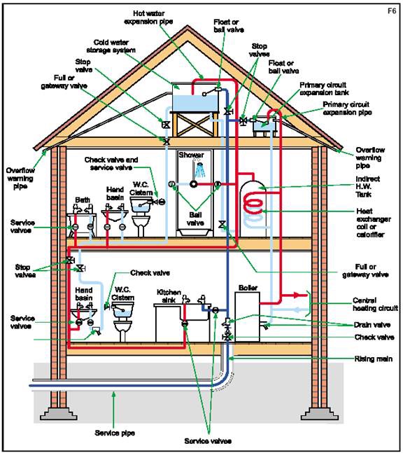

Calm Chris Posted May 23, 2015 Report Share Posted May 23, 2015 The shower, is it a simple mixer of tank stored hot and cold, or via a pump? Since someone has been fiddling, I try to check along the route of the CW feed from the bigger tank to the shower unit- might there be an isolation valve somewhere that has been fiddled with? Link to comment Share on other sites More sharing options...
Calm Chris Posted May 23, 2015 Report Share Posted May 23, 2015 Here's a diagram of how it all works, try following the feed to the shower. Link to comment Share on other sites More sharing options...
cabby Posted May 23, 2015 Author Report Share Posted May 23, 2015 No pump just a mix of hot and cold feeds. From what I can see there is a pipe from the lower part of the large tank providing the cold feed direct to the shower, a run of about 2 or 3m. Can't see there is much scope for an airlock. Link to comment Share on other sites More sharing options...

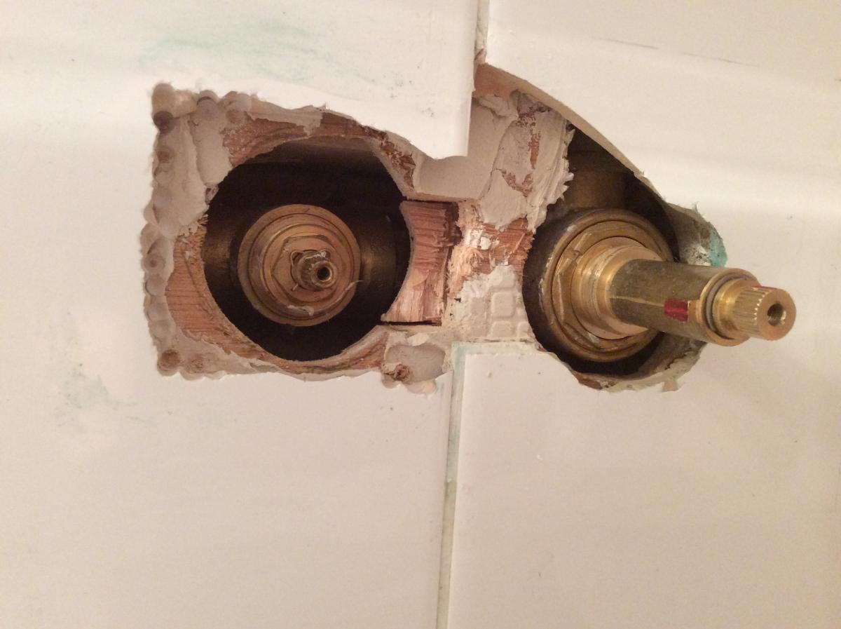

Daz Posted December 23, 2015 Report Share Posted December 23, 2015 Yeah, I was hoping it would be a bar one which you could temporarily remove and let the water run through. Have you checked the filters on the one you have? Link to comment Share on other sites More sharing options...
cabby Posted December 23, 2015 Author Report Share Posted December 23, 2015 Cheers Daz - thought you might say that. If it's filters on the thermostatic cartridge I've fitted a new one so guessing they are fine. Does this pic help? Link to comment Share on other sites More sharing options...
