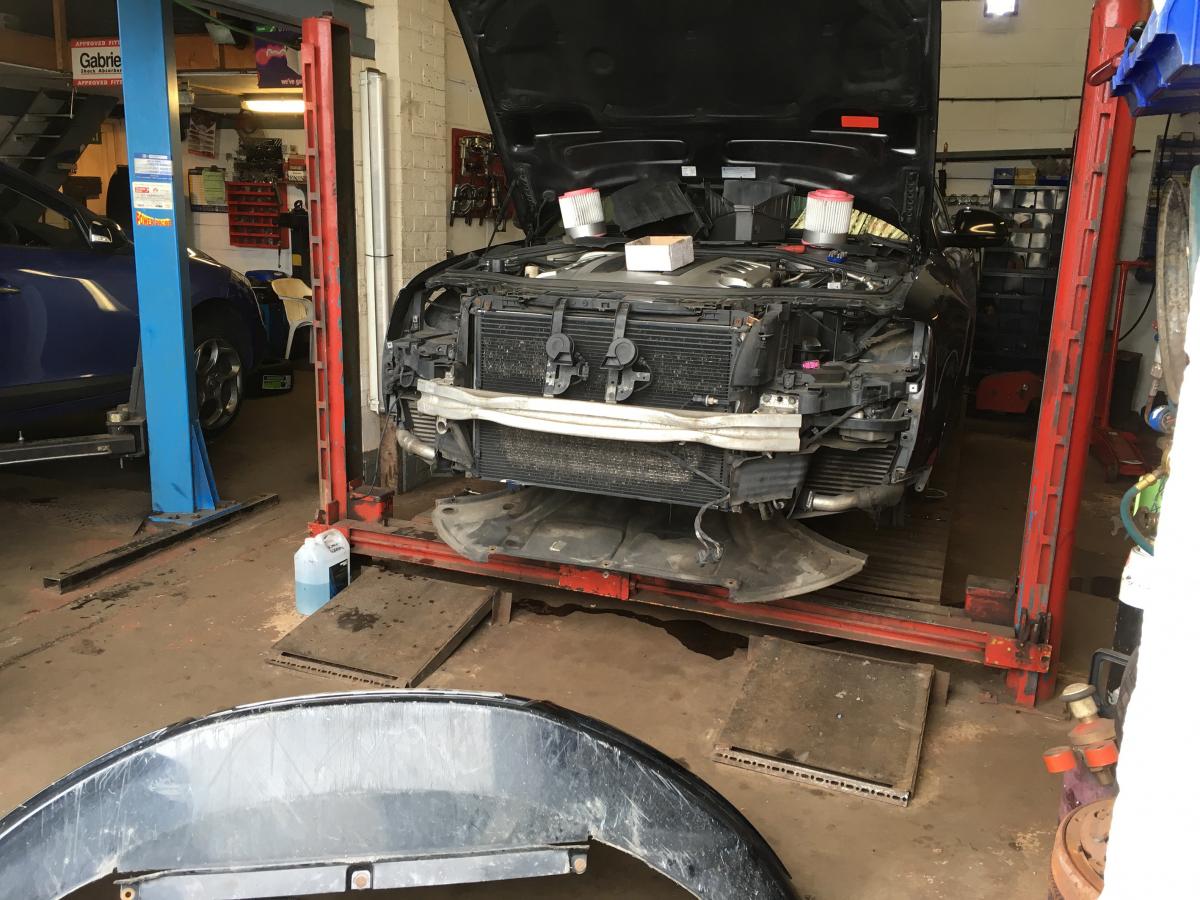

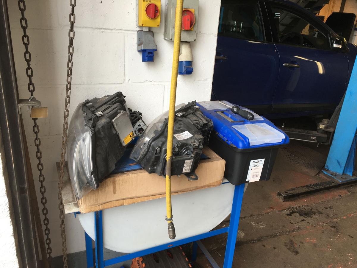

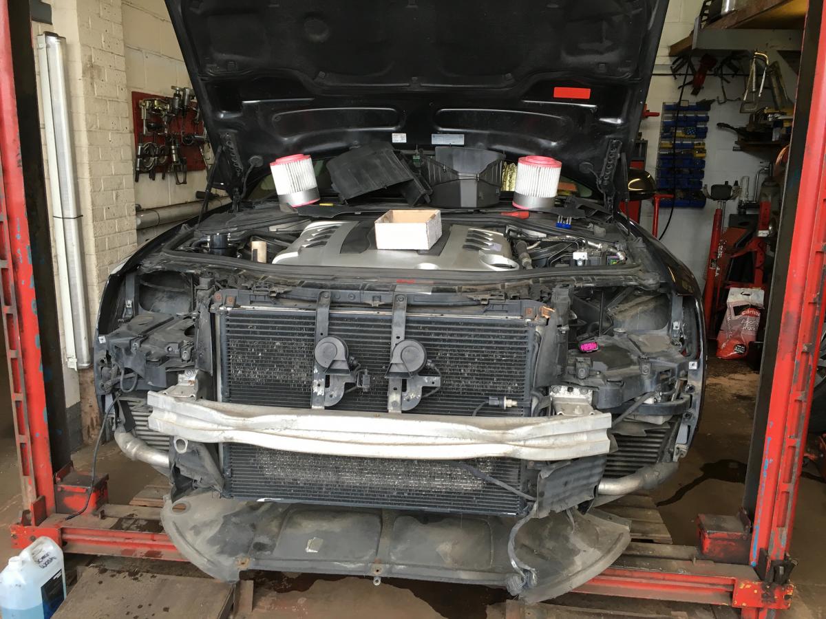

Muppet_man Posted May 2, 2016 Report Share Posted May 2, 2016 The light output on the Headlamps on my A8 4.2 TDi were so poor that it seemed if you drove fast enough you could actually overtake the light! So, I got myself two new HID lamps as I know that they dim down significantly after around five years average use. It is impossible to change them in situ and so I used the ramp at my friends garage and swapped them over for the new ones. The difference is quite startling. Much, much brighter than the old ones. I would recommend it to anyone who has old ones fitted. Link to comment Share on other sites More sharing options...
cruiser647 Posted May 3, 2016 Report Share Posted May 3, 2016 Ooooh! Will have to have a look into this. I know on the diesels, there is feck all room to do anything with the headlamps, as it is not only the airboxes in the way, but additional pipework. On the petrols, there is more room. The air pipe into the airbox from the grill is a PITA - it's a crap fit. Link to comment Share on other sites More sharing options...
Muppet_man Posted May 8, 2016 Author Report Share Posted May 8, 2016 I'm not sure I know what PITA means! Is it anything like POS? I fitted these ones here - http://www.ebay.co.uk/itm/Philips-D2S-X-treme-Vision-50-4800K-Xenon-Brenner-85122XV-2-Stuck-TOP-/161998426141?hash=item25b7dbd01d:g:SwEAAOSwT6pV5ecx Really pleased with the difference. Link to comment Share on other sites More sharing options...
