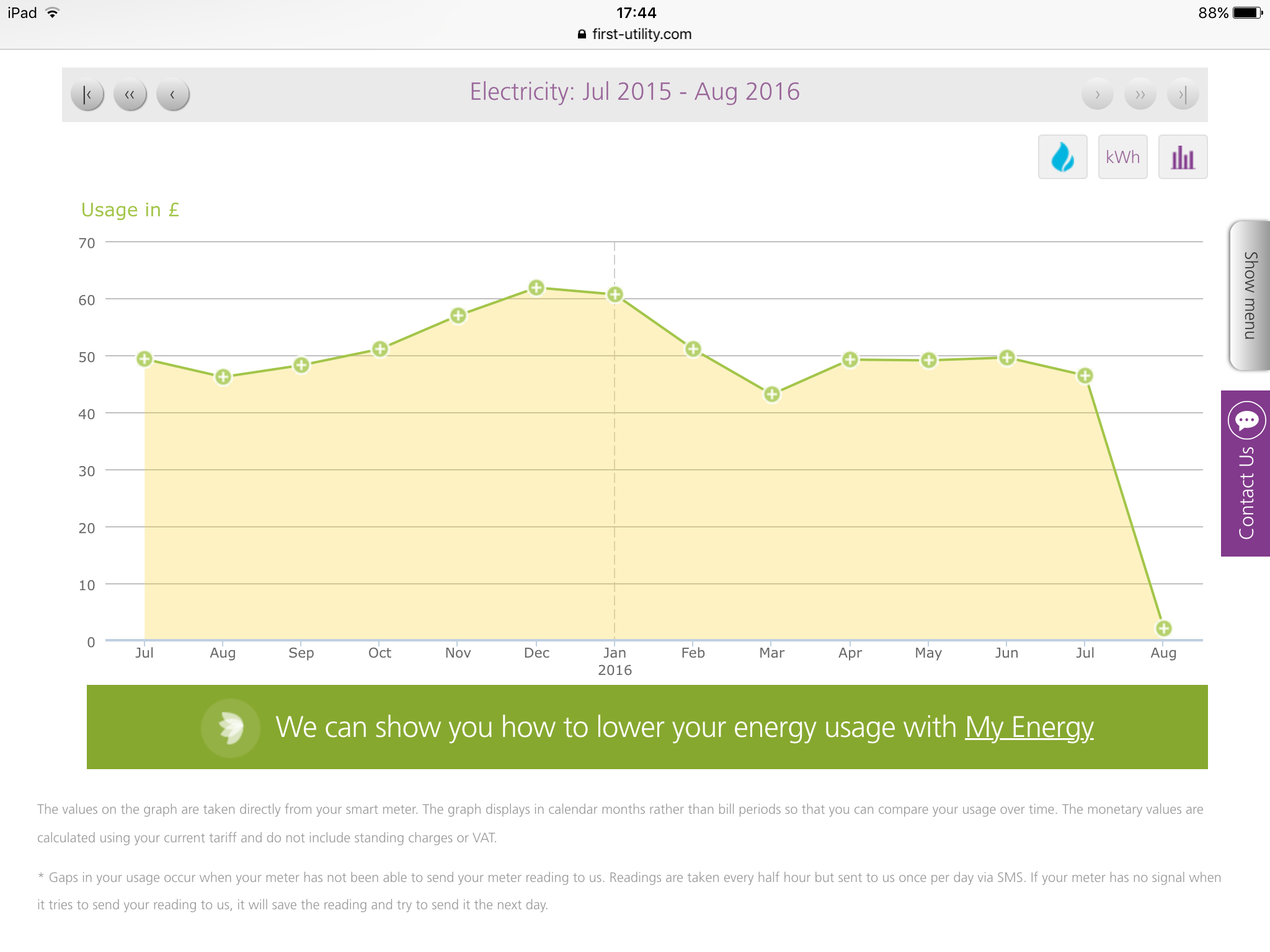

NewNiceMrMe Posted August 2, 2016 Report Share Posted August 2, 2016 We've had most of our lights in well over a year now. You might recall how I used to moan about our huge electric bills? It used to be a subject of much ridicule on here due to our girls and their habit of leaving every light on in every room at every hour of every day! Since changing to LED's (bearing in mind we still have other rooms to get through) the monthly electricity bill has dropped by 20% (20.3% to be precise. ). I won't be surprised if we realise a 30% saving by the time we've done the rest of the house. 1 Link to comment Share on other sites More sharing options...

Tipex Posted August 2, 2016 Report Share Posted August 2, 2016 As above, switching all the lights to LED slashed our electricity bill, I'd say by at least 30%, possibly even up to 40%. I never realised just how much of the bill related to lighting and how little to everything else, we're far from careful either, many chargers left plugged in switched on when not charging anything, TV's on standby, washing machine and tumble dryer twice a day, electric oven an hob etc etc. Makes me wonder how there can still be threats of electricity shortages in the future when everything we buy is more energy efficient that the item it replaces? We're using far less electricity today than we did ten years ago, despite having more items that consume electricity. Link to comment Share on other sites More sharing options...

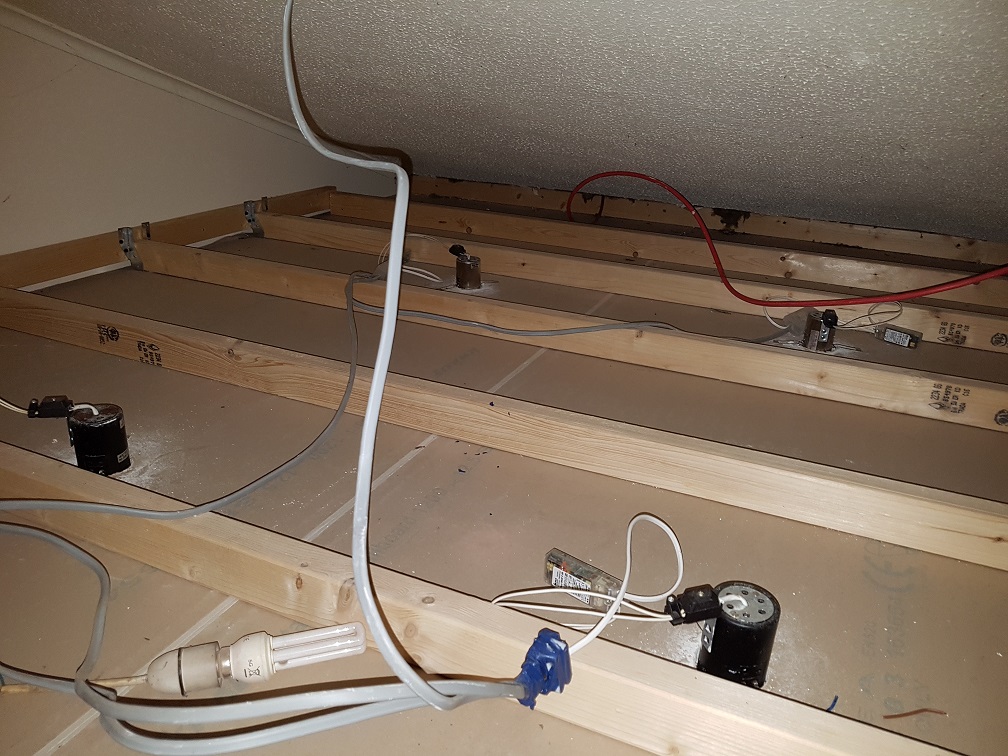

RobK Posted August 4, 2016 Author Report Share Posted August 4, 2016 I've ordered 50 GU10 lamp holders to get started with, so will have a crack at it at the weekend. I had a look in the ceiling space above part of the house and if they're all wired up like these it should be an easy job. i.e. snip off old lamp holder and remove, disconnect transformer, feed new lamp holder wires up and connect to mains. Mind you even at 5 minutes per light it will still take ages Link to comment Share on other sites More sharing options...
Biscuits Posted August 4, 2016 Report Share Posted August 4, 2016 (edited) Rob. You might find that the heat from the halogen lamps has melted or made the terminal blocks on the top of the fittings brittle, depends how old they are (don't look that old tbh). I would snip the white 240v cable close to the transformer and connect directly to the new GU10 lamp holder wires, using WAGO connectors rather that connector block (that's sooooooo last century!) They are awesome, safe and save a LOT of time. 3-way Wago's can be used for pretty much any job: 3-Way WAGO Connectors - Box of 50 Get a pair of these too: Automatic Wire Strippers What GU10 LED lamps are you going for ? If you want to know what ones dim well, have a look here: Rako dimmable LED test results EDIT: The new WAGO lever connectors are a bit smaller and sexier looking New WAGO 3-way connectors Edited August 4, 2016 by Biscuits 1 Link to comment Share on other sites More sharing options...
RobK Posted August 4, 2016 Author Report Share Posted August 4, 2016 I wasn't planning on using the connector block on top of the fitting, I was thinking of connecting the new lamp holder wires up to the block inside the chocbox (or bundle of tape on that one there!) and getting rid of the transformer and wires completely. I guess using the WAGO connectors might save a bit of time but then there'd be 2 lots of connections. I'm going to use the lamps I had from before which are these: Integral LED Spotlight Bulb (GU10 5 W). I don't have any dimmer switches so that's not a concern. I'll probably get some warmer white ones for the living room though as those ones aren't especially warm looking despite being labelled 3000K. Link to comment Share on other sites More sharing options...
