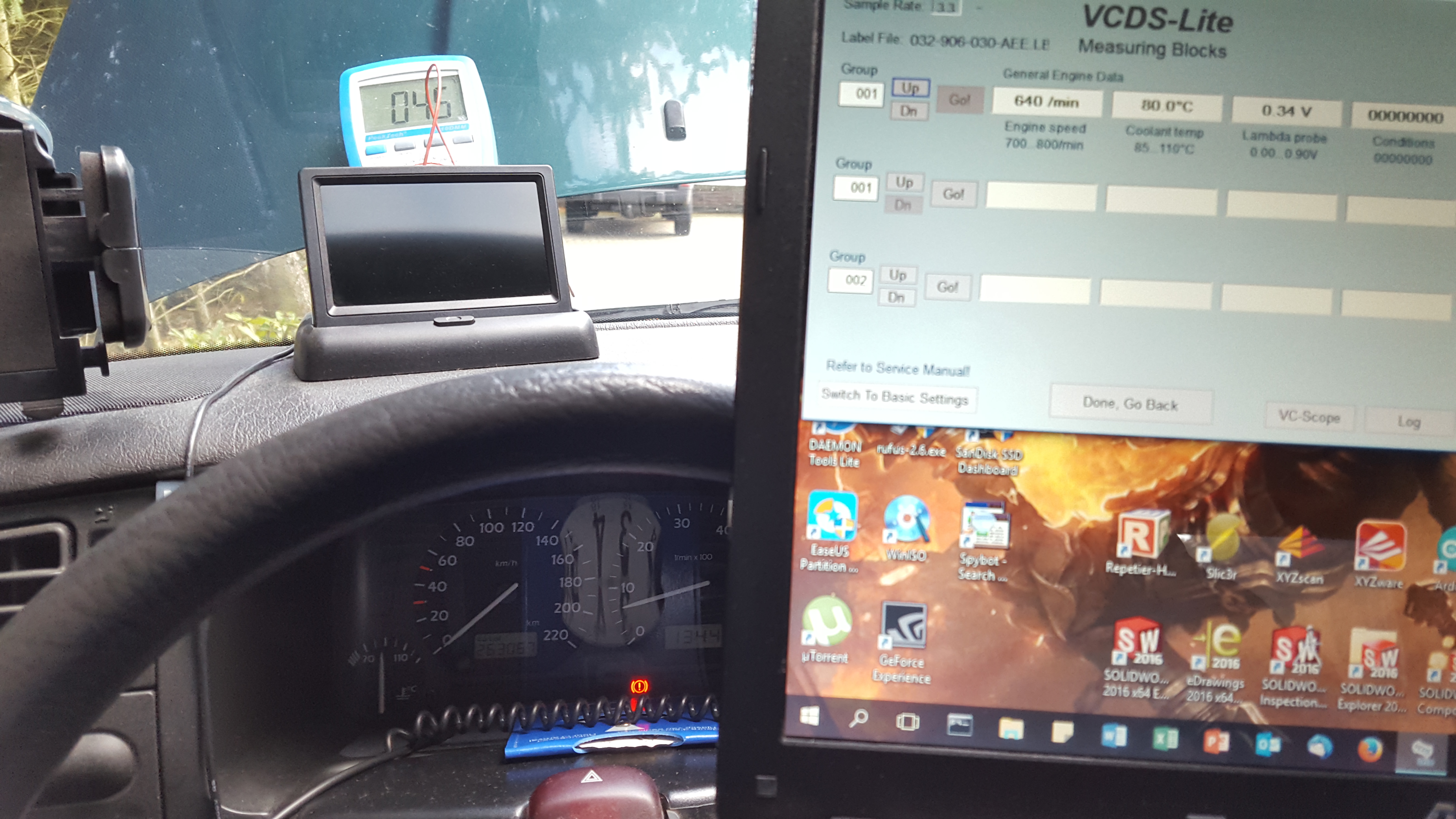

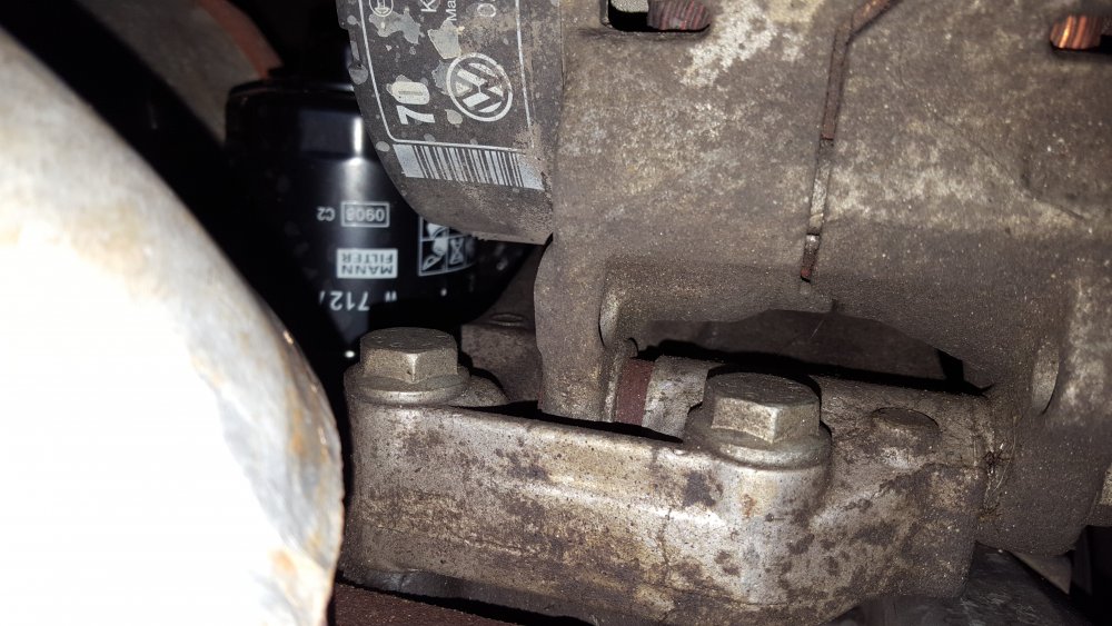

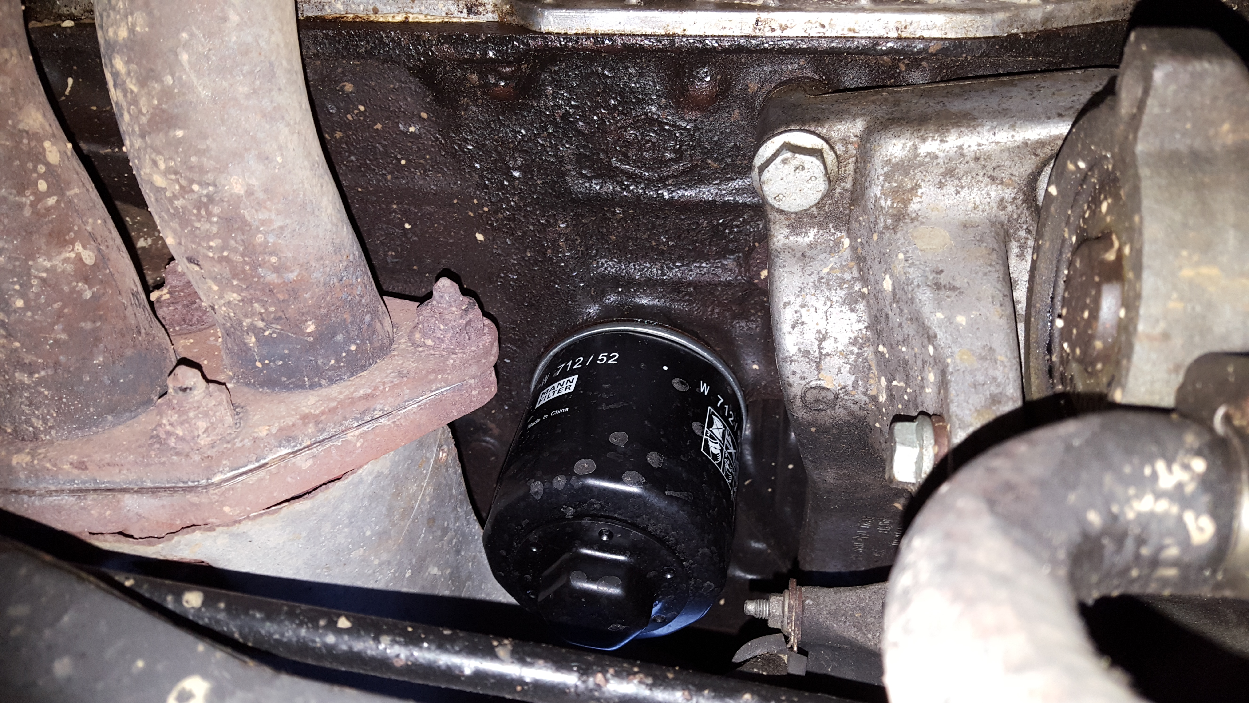

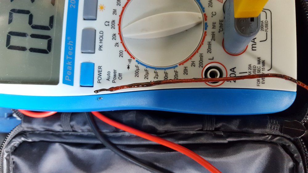

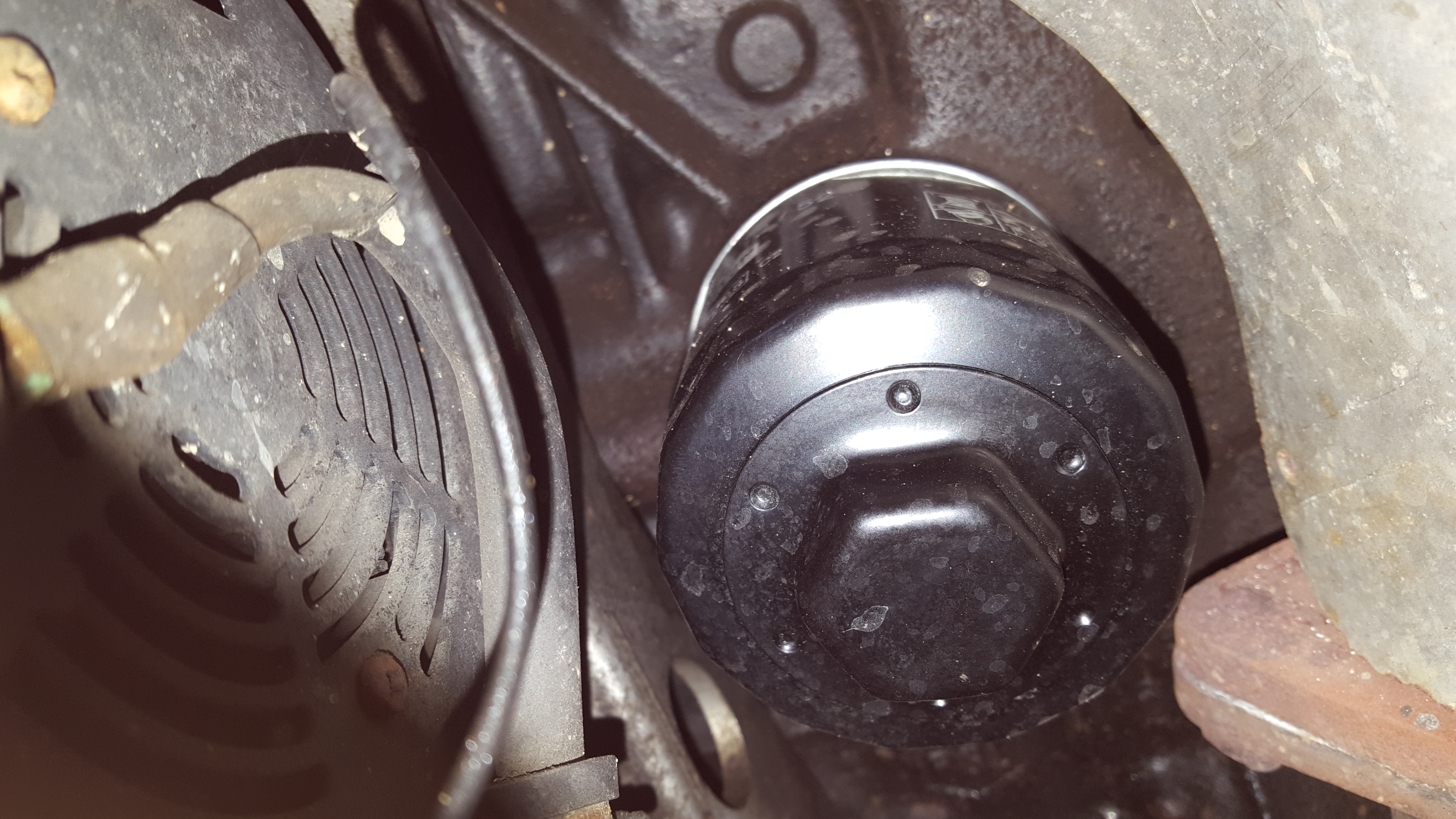

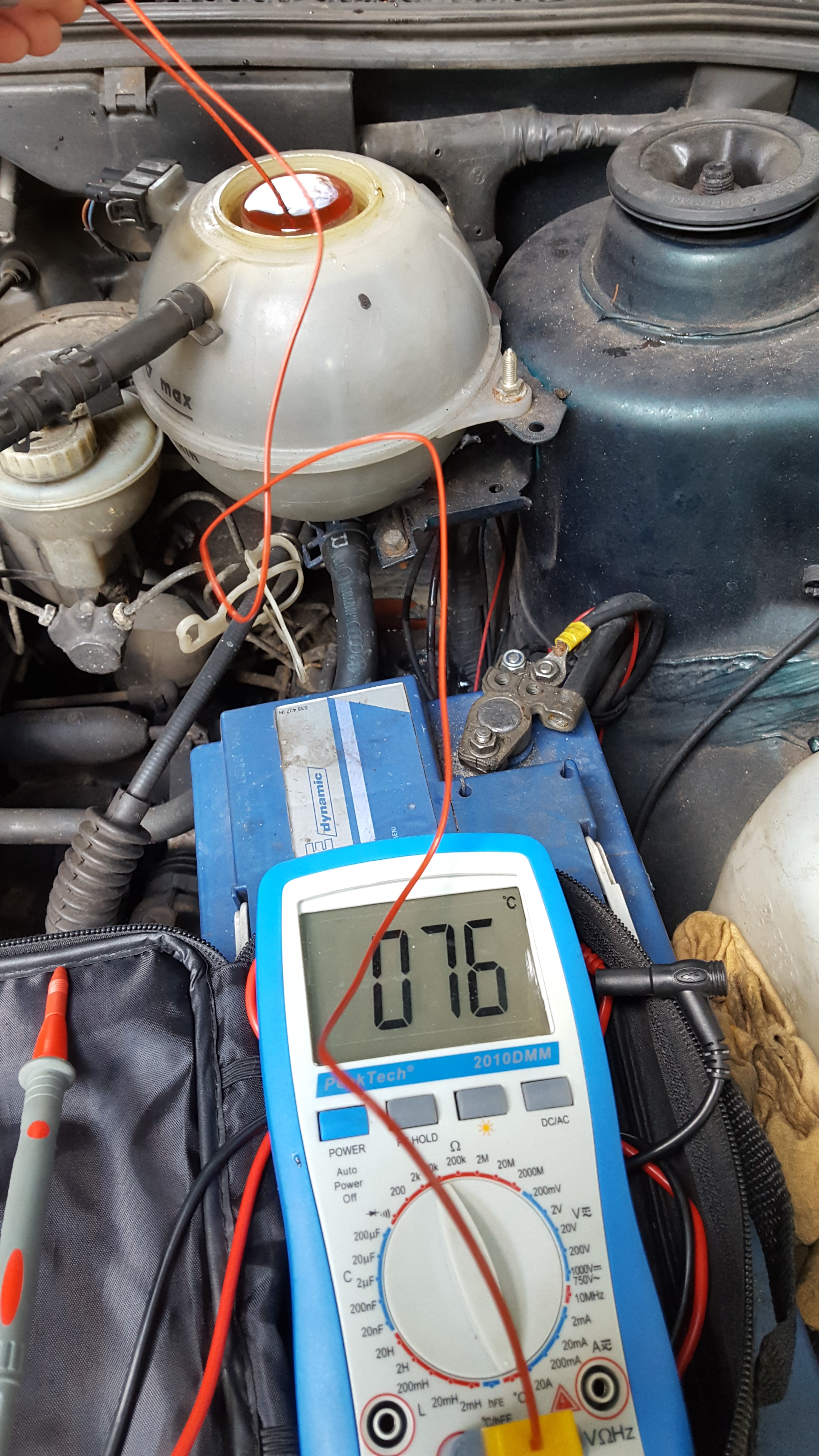

C_Cheetos Posted November 19, 2016 Author Report Share Posted November 19, 2016 Did a quick test run on the temperature sensor as you suggested, before starting the ECU gave a temperature of 15 Celsius, and my thermocouple sensor (the volt meter you see) gave a reading of around 20 Celsius. But my thermocouple was placed in the reserve tank for the coolant, so this could be the difference. after starting the temperature climbed up nicely as it should, don't have a picture of 90 Celsius, but it got there in a couple of minutes. Don't mind my sensor (in the dashboard picture) as it turns out, it was pushing against a side of the plastic reservoir, which is obviously much colder than the coolant. once it got to 90 Celsius, I got out and did a proper measurement with my own sensor, I've included the picture for this one as well, ECU reads 90, my sensor gave 76-77. didn't do the maths yet. But I guess the reservoir is cooler? (will probably have to do another test with my sensor placed somewhere in a radiator hose...) A stupid thing I did notice, besides that the coolant rises if I leave the cap off... is that I had contaminated my sensor with something pls dont be oil.. it was oil.. from my coolant reservoir. So now another question arises, could the starting problem be related to a blown head gasket? or might there be another way for the oil to find its way to my coolant? oil cap wasn't milky btw.. Link to comment Share on other sites More sharing options...
Cuprabob Posted November 19, 2016 Report Share Posted November 19, 2016 I'm not too familiar with that particular engine and whether it has an oil cooler at the oil filter which has a coolant jacket. With age they rot and oil gets into the coolant. Otherwise it looks like a head gasket, which is very common in VWs of that era. A blown head gasket could also cause your running issues as compression will be lost in one or more cylinders. Link to comment Share on other sites More sharing options...
