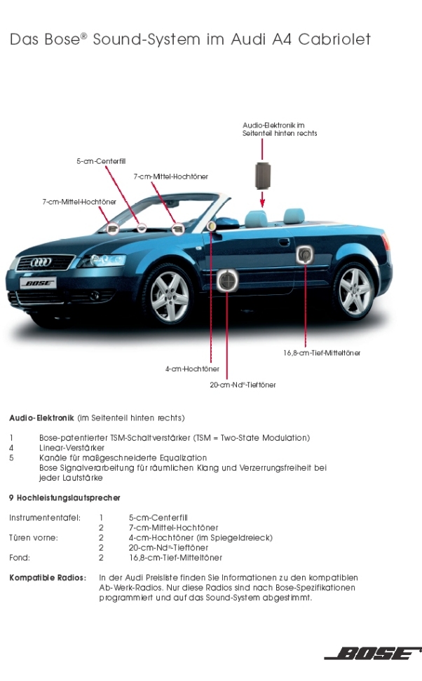

nwijnands Posted March 7, 2004 Report Share Posted March 7, 2004 I just looked it up in a Dutch A4 cab brochure dated june 2003 and it states that the Bose system indeed has 9 speakers: - One center speaker in the dashboard - Two speakers front - Four high tone speakers front - Two subwoofers front The non-Bose system also has 9 speakers: - One center speaker in the dashboard - Six speakers front - Two speakers in the back Link to comment Share on other sites More sharing options...
Phantom Posted March 7, 2004 Report Share Posted March 7, 2004 Just to back up Dutchcab's post I found the attached on the German Bose website (similar diagram to Sven's). It does indeed mention only 9 speakers so not quite sure of how they define the 10th subwoofer speaker ! (sorry I could'nt find an English version ) Link to comment Share on other sites More sharing options...
