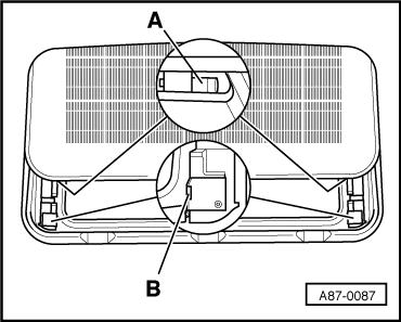

Sven Posted July 6, 2004 Report Share Posted July 6, 2004 Electrical testing Functional description of solar roof <ul type="square"> [*] Solar operation is only possible if the sun roof is closed or raised (the solar energy converted into electrical energy by the solar roof is transferred to the vehicle electrics via contacts -A- (at the front edge of the sun roof) and -B- (in the frame of the sun roof)). [*] Solar operation is not possible if the ignition is switched on, if the auxiliary heater/auxiliary ventilation mode is in operation or if the "residual heat" function is active (the operating and display unit -E87 actuates the isolation relay -J309 which switches the power supply for the fresh air blower -V2 from the solar cells -C20 to terminal "30"). [*] The energy yielded by the solar cells -C20 is converted in the solar operation control unit -J355 (installed between the sun roof headliner and solar roof) (e.g. from 6.5 V and 2.5 A to 3.5 V and 4.6 A). [*] The electrical energy yielded by the solar roof is calculated using the following formula: Solar radiation x Solar cell surface area on sun roof x Efficiency of solar cells -C20 x Efficiency of control unit -J355 Example: ________________________________________________ Solar radiation --------------------- 500 W/m2 Solar cell surface area on sun roof -- x 0.21 m2 Efficiency of solar cells -C20 ------- x 0.13 Efficiency of control unit -J355 ----- x 0.9 _________________________________________________ Yielded electrical energy ----------- = 12 W Note: <ul type="square"> [*] Contacts -A- and -B- (on the sun roof and sun roof frame) used to transfer the generated electrical energy must be clean and free of any lubricating grease. [*] If necessary, a thin coating of contact grease may be applied to contacts -A- and -B- (electrically conductive protective and lubricating agents are commercially available from electronics traders). Checking functioning of solar roof Special tools, testers and other items required <ul type="square"> [*] 12 V test lamp (max. 5 W) Test condition <ul type="square"> [*] Sun roof closed. [*] Park vehicle in sunlight Notes: <ul type="square"> [*] In unfavourable weather conditions, the solar roof can be illuminated using e.g. two commercially available 500 W halogen lamps. The lamps must be located at a distance of 500 mm from the sun roof. [*] When the solar roof is illuminated using halogen lamps, electrical energy of only approx. 1.5 W is yielded (the fresh air blower -V2 rotates, but the air flow is virtually undetectable). - Adjust air distribution of air conditioner to "dash panel vents". - Open "centre" dash panel vents (close all other vents). - Switch off ignition (operating and display unit -E87 goes dark). - Air should be flowing from "centre" dash panel vents (if necessary, check by moistening surface of your hand and holding it in front of vent). If fresh air blower -V2 is not functioning: <ul type="square"> - Open sun roof approx. 10 cm. - Connect 12 V test lamp (max. 5 W) between two contacts -A- of sun roof. - Test lamp should flicker or light up (depending on intensity of solar radiation). If test lamp flickers or lights up, solar roof is functioning OK. <ul type="square"> - Check cabling to fresh air blower -V2 (via isolating relay -J309): ________________________________________________________________________________________________________________________ <font color="darkblue"> Hope this helps! </font> Link to comment Share on other sites More sharing options...
