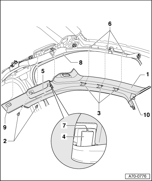

FlashBastd Posted July 10, 2004 Report Share Posted July 10, 2004 Hi, The tax-disc holder antenna on my car kit has fallen out with the windscreen, and will no longer stick in place. I am going to replace it, but don't know how to remove the A-pillar trim - there is an airbag in there, and I don't really want to disturb it. Any ideas? Link to comment Share on other sites More sharing options...
Sven Posted July 12, 2004 Report Share Posted July 12, 2004 Removing and installing upper A-pillar trim ___________________________________________________________________________________________________________________ Important: Observe safety precautions for working on head airbag ___________________________________________________________________________________________________________________ Upper A-pillar trim <ul type="square"> [*] Removing <ul type="square"> - Remove sun visor - Fold flaps for roof grab handle -5- down. - Fold flap down over screws on roof grab handle -4-. - Remove screws -2-. - Unclip rear airbag label -9- (on B-pillar) and pull down. - Remove airbag label screw. - Pull upper A-pillar trim -1- out below upper B-pillar trim and unclip the three clips -3-. - Pull off upper A-pillar trim -1- to rear. [*] Installing ___________________________________________________________________________________________________________________ Important: Always adhere to installation sequence for A-pillar trim ___________________________________________________________________________________________________________________ <ul type="square"> - Insert upper A-pillar trim -1- between rubber door surround and side panel. - Insert trim retainer -10- in relevant clip. - Clip upper A-pillar trim -1- in firmly with the three clips -3-. - Push trim under upper B-pillar trim. - Ensure that clip and metal hook of head airbag adapter are engaged securely. ___________________________________________________________________________________________________________________ Important: Ensure that trim is firmly seated. ___________________________________________________________________________________________________________________ 2. Bolts (2x) <ul type="square"> - Tightening torque 4 Nm * Self-locking * Replace * Threaded holes for bolts must always be cleaned (e.g. with a thread tap). 3. Clips (3x) 4. Flap for roof grab handle 5. Roof grab handle 6. Retainers 7. Groove 8. Seal <ul type="square"> - After installing trim ensure seal is seated correctly. 9. Airbag label 10. Retainer ___________________________________________________________________________________________________________________ *** Disclaimer: this is solely intended to indicate the procedure. Should you decide to try this yourself, you do so at your own risk! *** ___________________________________________________________________________________________________________________ Link to comment Share on other sites More sharing options...
FlashBastd Posted July 12, 2004 Author Report Share Posted July 12, 2004 Thanks Sven, but is that for the current shape A4? My A pillar trim seems to go back all the way to the B pillar. Any ideas if anything needs to be done about deactivating the airbag, or is it just a case of be careful? Link to comment Share on other sites More sharing options...
