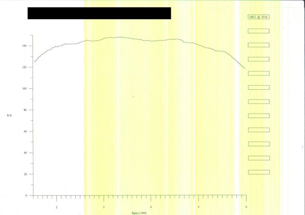

LostBok Posted August 1, 2004 Author Report Share Posted August 1, 2004 Thanks guys. Like I said, not looking for loads of extra revs. As standard the 2.0 8v revs to about 5600, you can rev it further, but the torque drops off WAY before that. Starts dropping before 5000rpm and it's got nothing after 5500rpm really. Would like it to be able to rev to 6200rpm or at least somewhere over 6000rpm, but unlikely to push it up there that much, hence why I wan tot find out if it's possible to get something that'll get me near those sorts of revs without losing low-end "grunt" (and economy). This is NOT a track car (it's a convertible!)... just like to have something that soudns and performs nicely - purely for road use. No ideas on what the Schrick cam from AMD (Bicester) is like? I was told this was the forum for AMD advice... thanks, Chris Link to comment Share on other sites More sharing options...
LostBok Posted August 1, 2004 Author Report Share Posted August 1, 2004 Torque Link to comment Share on other sites More sharing options...

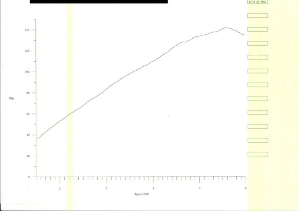

LostBok Posted August 1, 2004 Author Report Share Posted August 1, 2004 Power graph - sorry about the yellow streaks on these 2 - scanner is fried.... Link to comment Share on other sites More sharing options...
