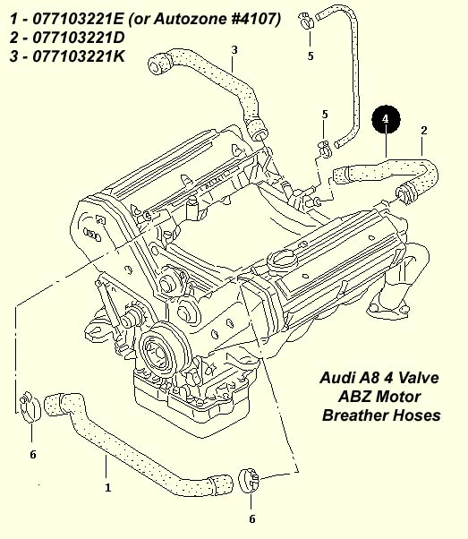

PaulW Posted August 5, 2004 Report Share Posted August 5, 2004 Here's the oil breather hoses, the stealer gets a lot of money for them.....but here in the states you can get a front one for about $5 from Autozone..... From my understanding the rear hose is something like a 2 hour job to get at it! There are other places that the oil can leak from, one is the rear cam covers.....easy to replace, if you had your cam (timing) belt replaced recently and it's now leaking and they didn't replace them, it could be these. There is one on each bank..... you can see them in this procedure here. Link to comment Share on other sites More sharing options...

audia8s2 Posted August 5, 2004 Report Share Posted August 5, 2004 I replaced the front breather hose on mine but I think it would take a lot to leak, my breather hose was really soft and cracked but it still wasn't leaking. £ 250 sounds a bit excessive for all the pipes, I'm sure the back one's wouldn't be that big a job?? and the parts are next to nothing. Link to comment Share on other sites More sharing options...
cruiser647 Posted August 6, 2004 Report Share Posted August 6, 2004 From what I can see, replacing the rear breather hoses seems a right PITA of a job. Judging by the ETKA pics, the main block breather is down under the intake gubbings. Not sure if all that has to come OR you have arms and hands like an Octopuss (no quotes from wives/girlfriends please!) That gap looks REAL narrow and small to get into. I replaced the front one when I done my Cam Cover gaskets Link to comment Share on other sites More sharing options...
