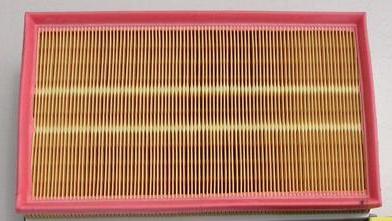

Rustynuts Posted July 25, 2005 Report Share Posted July 25, 2005 [ QUOTE ] Is the airfilter new(ish)? is the bottom of the filter housing clean? Worth hoovering it out and changing the airfilter its not been done recently. [/ QUOTE ] The seal on the air filter isn't meant to be reused. It's designed as a once only seal and if opening the airbox and resealing it, the seal will be compromised and may fail. Link to comment Share on other sites More sharing options...
Wobby Posted July 25, 2005 Report Share Posted July 25, 2005 Thanks Rusty. Do you mean the seal between the top and bottom half of the filter?? I only use copy filters so i dont get the box seal. I think my next one will be from the dealers, but i will have a look to assess if it looks to be sealing ok. I have logged my MAF readings and got a max reading of 1200g/s regularly, even though the expected maf is 850g/s I logged a Skoda VRS and it only generated a MAF reading of 850 under hard acceleration. I am sure my MAF is faulty, strange that it seems to be reading too high not too low. I guess that could explain why i am losing some fuel economy. EDIT !!!! oops, all reading above are in mg/str not g/s RobK Link to comment Share on other sites More sharing options...
Rustynuts Posted July 25, 2005 Report Share Posted July 25, 2005 The box seal is part of the air filter. It's the rubber seal you see pictured here in pink. Link to comment Share on other sites More sharing options...
Wobby Posted July 25, 2005 Report Share Posted July 25, 2005 Ahh.. ok, yeah i do change that every 10k. I find it amazing how much crap is in the bottom of the airbox! If you dont clean it out it must just suck back onto the bottom of the new filter and its already partly blocking straight away. I dont think the dealers bother. When i got the car it had been dealer serviced and it had 2cm of crap in the bottom of the airbox. Its never had that much since, although i do change it more than necessary. RobK Link to comment Share on other sites More sharing options...
