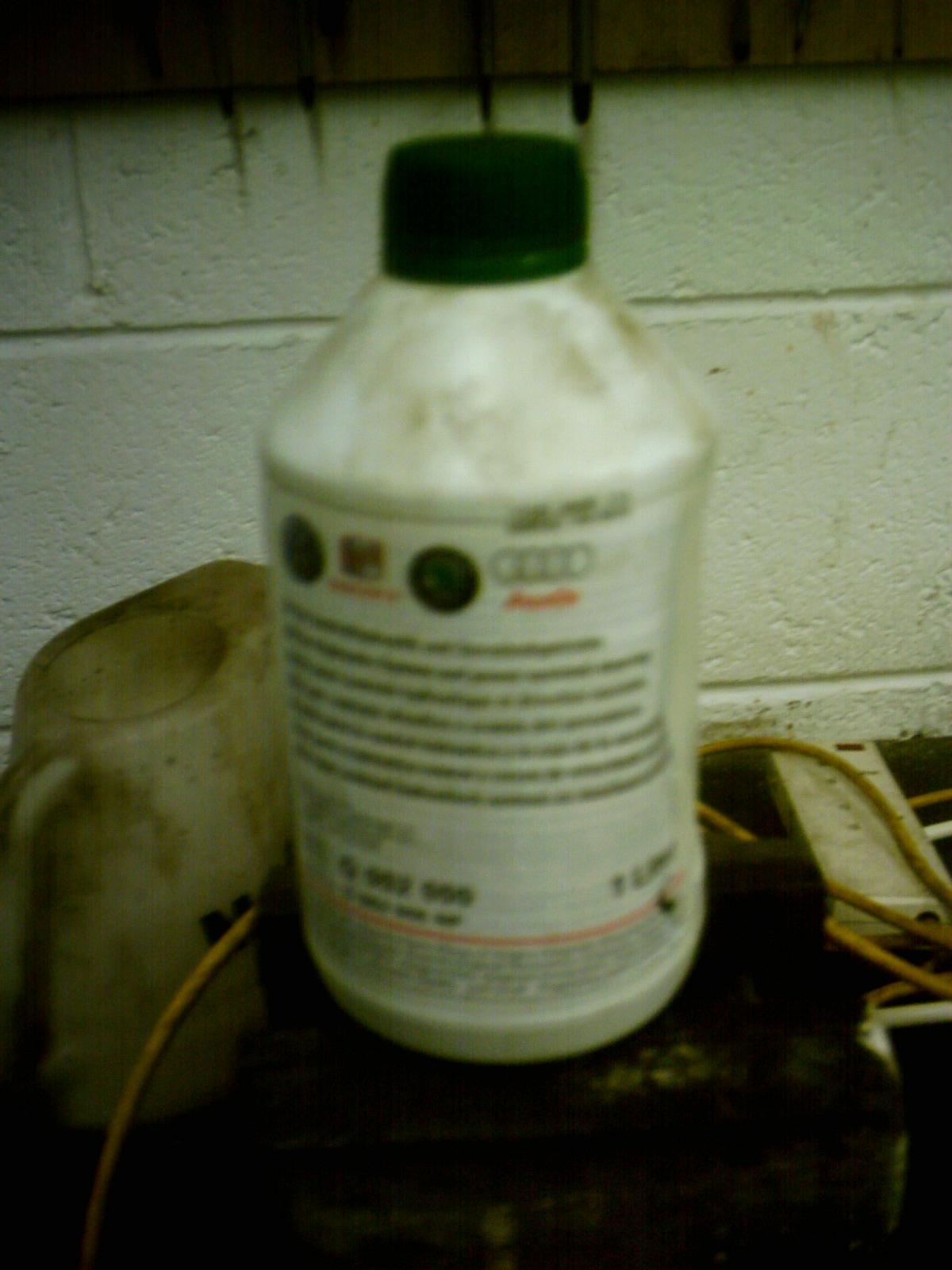

mulkbear Posted August 24, 2005 Report Share Posted August 24, 2005 VW G 002 000 Spec, It should be Green and smell sweet. If there is some in the reservoir (just below the minimum) it should be ok to drive to the nearest dealer Link to comment Share on other sites More sharing options...
