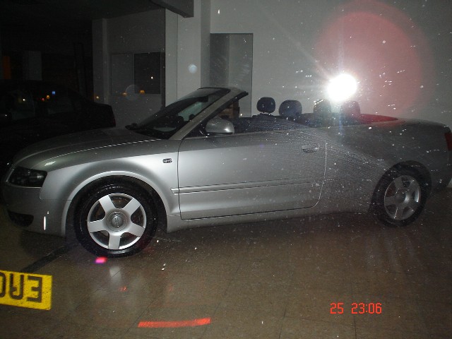

[ QUOTE ]
Ahah, that would make sense!
Those wheels are the 5 arm Aero wheels which would therefore make this 2003 03 car a standard model (I'm sure it's not a Sport)
[/ QUOTE ]
