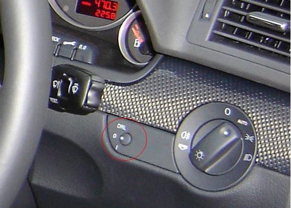

Milo Posted December 14, 2005 Author Report Share Posted December 14, 2005 Ahah, daytime driving lights sussed. It would appear the lights are as described by Chris_B above (brighter halogens) however they can be turned off There is a pop out button next to the normal light controls as seen below and circled in red. Many thanks to ChrisAn for the tip off (he's got xenon plus on his new A4) Link to comment Share on other sites More sharing options...
Chris_B Posted December 14, 2005 Report Share Posted December 14, 2005 [ QUOTE ] There is a pop out button next to the normal light controls as seen below and circled in red. [/ QUOTE ] I had wondered how they would be turned off without MMI (in the A8, and I presume the new A6, it's in the exterior lighting menu along with full beam restrict with automatic lights, and coming and leaving home toggle and duration), I had thought possibly dealer diag tool or VAG-COM. A button a is far more elegant solution though; how typically Audi! Link to comment Share on other sites More sharing options...
