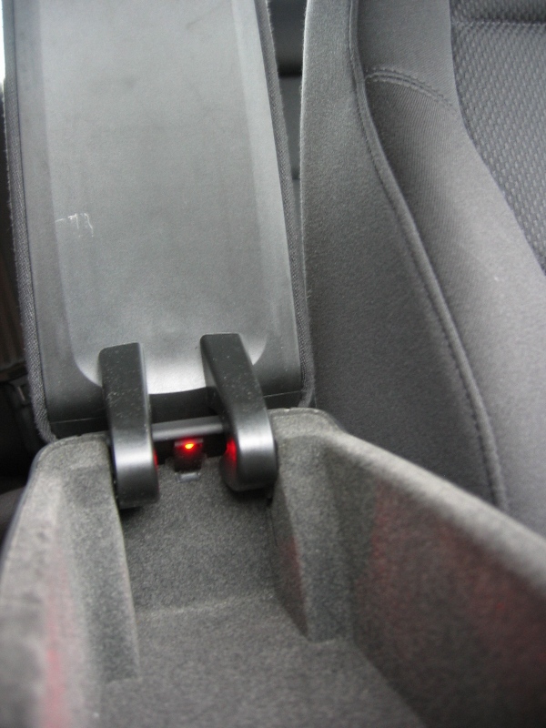

The led in the armrest mustn't part of the interior light pack. I don't have the interior light pack, but I do have the centre armrest with the light in it. (I have fitted the dual led in the courtesy lamp cluster though sekret.gif)
Pic attached of the cable which connects to the armrest. The cable colours are grey/blue and brown.

" my armrest also has a LED inside although i do not have the light pack"
