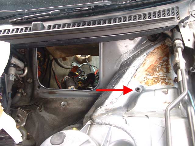

Botang Posted August 15, 2006 Author Report Share Posted August 15, 2006 Well for the best part of a month Ive had my car in rally mode, and been struggling to find the water leak. I managed to spare a bit of time this afternoon and I hope Ive sorted it. The water was geeting in through a hole in the bulk head, which was completely invisible at first. The hole was covered over with the original Audi seam sealer and only after removing the ecu, tcu, and whatever else cu that sits in the waterproof housing, the waterproof tray itself, some sound deadening material and the seam sealer could I finally work out how it was getting in. location of above Ive blocked it up now with a nut, bolt and silicone sealer, that should do the job Link to comment Share on other sites More sharing options...

Botang Posted August 16, 2006 Author Report Share Posted August 16, 2006 It was pretty clean under there, I was expecting it to be full of rotten leaves but it wasnt too bad. To get the box out was a right pain. There is a 10mm nut at the front which is obvious, but to getthe rest out, you have to remove the box cover (about 8 bolts) the ECU, another few, the TCu, another few, another unit, all the wiring connectors, you have to seperate the two wiring looms (engine bay and interior) and take out 4 nuts from the inside of the car which secure the box to bulk head. Unless it really needs doing leave it alone Ill take another picture which will help show the location of the drains but there are none under the box itself. Link to comment Share on other sites More sharing options...

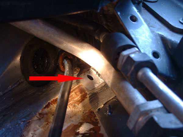

Botang Posted November 28, 2006 Author Report Share Posted November 28, 2006 Picture for Ska Passenger side drain hole location Link to comment Share on other sites More sharing options...
Atomic Posted November 28, 2006 Report Share Posted November 28, 2006 Is that the new style air con in the piccy? Link to comment Share on other sites More sharing options...
Ska Posted November 28, 2006 Report Share Posted November 28, 2006 Thanks Botang That looks to be under the black box I'll try and scoop with a few coat hangers or something Link to comment Share on other sites More sharing options...
ant Posted August 17, 2007 Report Share Posted August 17, 2007 i seem to have the same prob........ i've done all the drains and all are flowing well but i've sprung a leak from some where behind the rear left of the glovebox..... all sounds very similar to botangs leak.! botang did this solve your prob completely? Link to comment Share on other sites More sharing options...
Botang Posted August 17, 2007 Author Report Share Posted August 17, 2007 yes it did, it was a real pain to do though. At lest you will know where to look Link to comment Share on other sites More sharing options...
ant Posted August 17, 2007 Report Share Posted August 17, 2007 your not joking spent 5 hours on it.... but its fixed.The factory audi seal was like paper i really didn't expect to do a job like this on a car of this status.Many thanks to botang for his pics in this thread without them it would of taken me days to find that leak.Called it a day now, tomorrow i've got to dry/refit the interior. Link to comment Share on other sites More sharing options...
