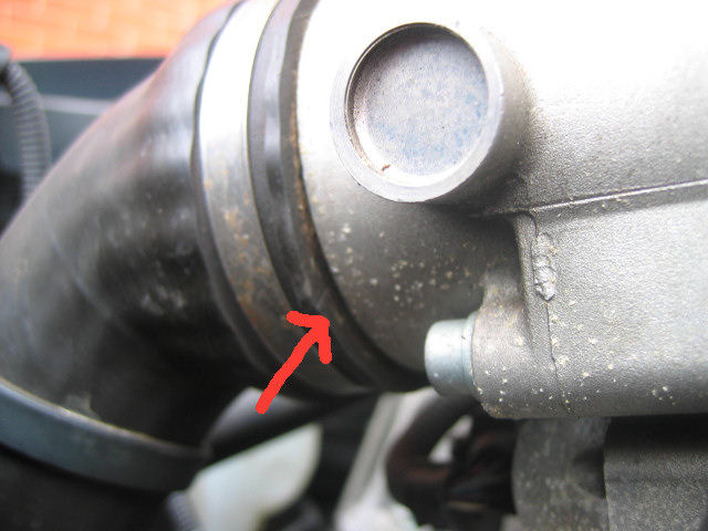

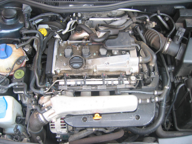

Hudster Posted September 16, 2006 Author Report Share Posted September 16, 2006 I've cleaned the MAF now and checked the readings using VAG, and now believe the problem is caused by a VAC leak somewhere. I've checked the hoses I can see for leaks, and have only found one possibility (see pic below) but it doesn't look like it's wide enough to cause any problems. Could anyone indicate on the pics where I should be looking for a leak please? Link to comment Share on other sites More sharing options...
Hudster Posted September 16, 2006 Author Report Share Posted September 16, 2006 this is the only possible leak I can see, but the gap doesn't look big enough as the hose is still snug over the pipe, any ideas? Link to comment Share on other sites More sharing options...
