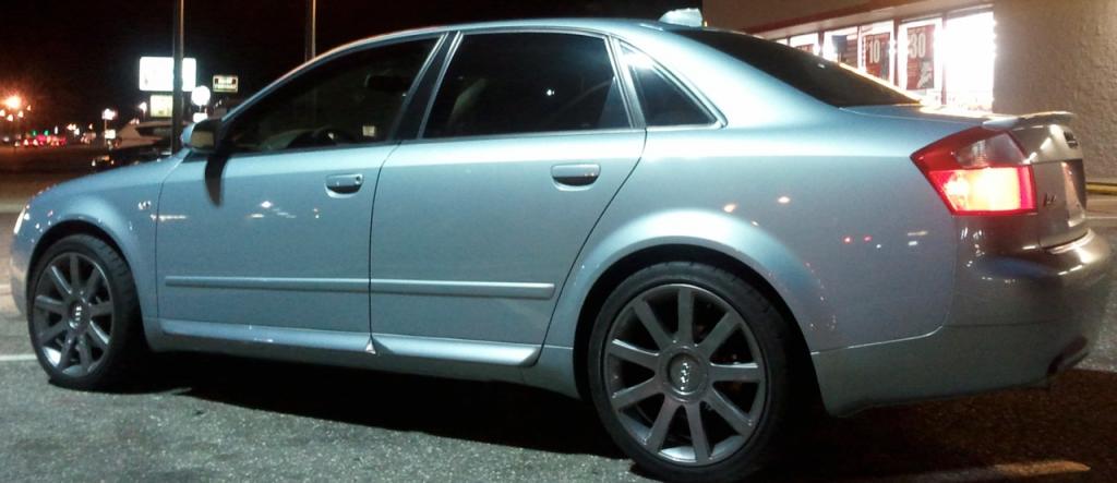

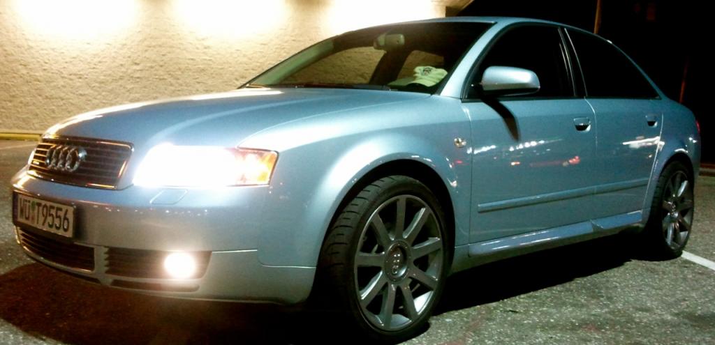

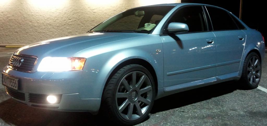

heath93274 Posted March 6, 2011 Report Share Posted March 6, 2011 I have a 2004 Audi A4, 1.8T, Quattro, Stage 1 APR have 9 Spoke Rims off his 2003 Audi RS6. They fit 100% on my Audi A4. I will include the specs below, Type: RS6 18" standard wheel (Spec: 8.5J x 18, ET30, 5x112) Part Number- 4B3 601 025 R 1H7 The tires that are on them are 255.35.18 Dunlop Direzza DZ 101's. They fit perfectly and no rubbing on the 8.5inch wide tires, full turns. Link to comment Share on other sites More sharing options...
