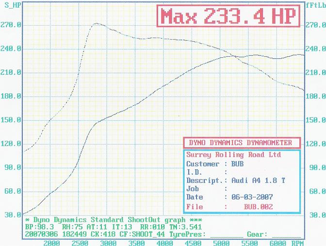

Avus_Bub Posted March 9, 2007 Report Share Posted March 9, 2007 [ QUOTE ] The early B6 A4's 1.8T had 163bhp. What turbo did this have? Was it a ko3 or ko3s? If i want to increase power, what options have i got and how much will it cost? How much BHP can i get on the standard internals? [/ QUOTE ] The standard bottom end will take about 320 odd lbft before you start to find con' rods hanging out of the side of the block in the morning The world is your oyster with a 1.8t it's all been done before, so no suprises really. My re-map details are HERE BUB Link to comment Share on other sites More sharing options...
